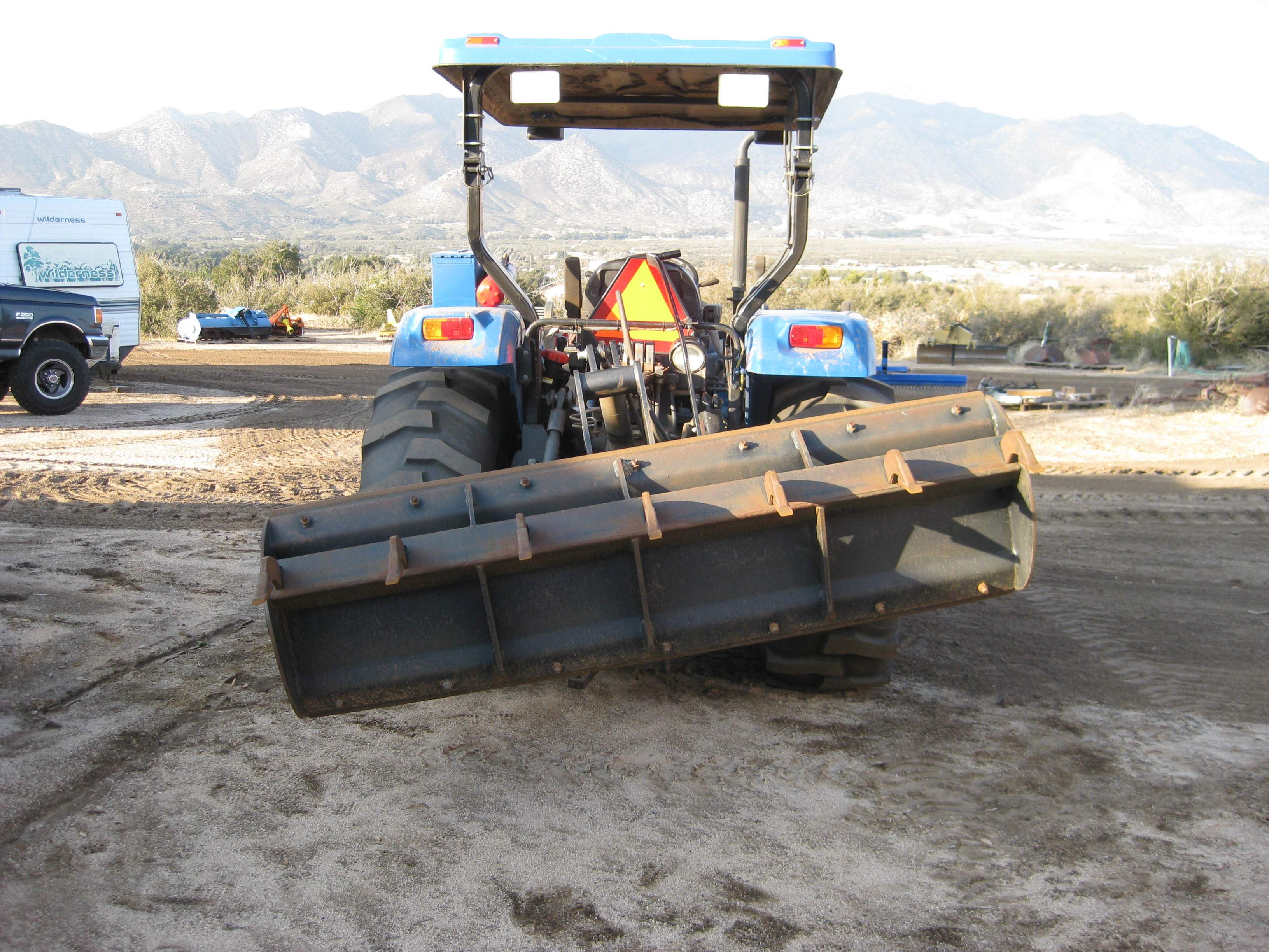

Yeah, I know, I'm just full of hydraulics questions this week.
Thinking of building a hydraulic side link, which will require welding a ball end and clevis on a new cylinder. Welding the clevis on the rod end doesn't worry me much, I can use water-soaked rags for a heat sink, but welding on the other end does concern me. I presume new cylinders have been pressure tested at the factory after assembly and will contain residual oil. Would welding heat fry that coating of oil and turn it into grit/crud inside the cylinder, to be later transferred to the rest of my system? Seems I'd have to either manually extend the rod and hope for the best, or remove the rod/piston altogether. I know others have done this, so I'm looking for some advice on what worked. Thanks.

To start with, to get full strength of a bolt, it needs to screw into whatever as far as the size of the bolt that is being used, 7/8 should screw in 7/8 and so on. Any one that cleans out ditches or is making ditches would use full tilt IMO. On my tractors that is only 11 or 12 degrees. My small tractor has a 4" stoke and my bigger tractor has an 8" stroke. As you can see, my box blades really don't tilt all that far and you are talking about cutting that tilt down. :eek: Whenever I build a side link, I do my best to match whatever the stock adjustable link has for its adjustable capacity.
My feeling is that what you are asking for would take a very long time to pay for the initial investment and is most likely why it does not currently exist.
Again all of this is just my opinion of what you have asked about, if someone chooses to do this, all the more power to them.

If your tractor is similar to a B3030, that top angle that you are talking about is 14 degrees. I have no idea if CCM figures that type of thing in their building of it. If you were to purchase a Side Link from me, it would have ends that were like the factory ends at the factory angles that you now have with your standard link.
Yes having both sides adjust will give you double the possible available angle. I believe that 3RRL has double hydraulic Side Links on both his and his wife's tractors. :cool2: Many of the cat 2 tractors come standard with 2 adjustable Side Links. :cool:
