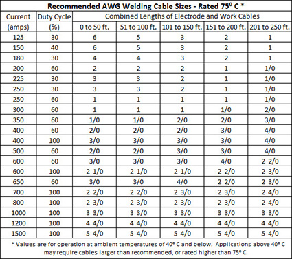

I need longer leads on my Miller Thunderbolt AC/DC machine. How long can I add to the factory leads and not cause any issues with power loss or changing the power setting?
   / Welding Leads #2
They make different gauge wire for longer runs. How long and at what amperage are you trying to achieve? No sense paying for heavy gauge leads if you only need the long leads for 1/4" steel (low amps).
   / Welding Leads #3
Here's a chart from Lincoln:

You only need to add the bigger wire on the welder end. Use Tweeco Connectors and at a 50' section of 0 cable to each lead. Indicator you need larger leads is if they get warm, or worse, hot to the touch. Generating heat eats up amps and drops voltage. I always use a 10' #4 lead with the stinger to keep the weight off my hand on the end of the bigger stuff.
