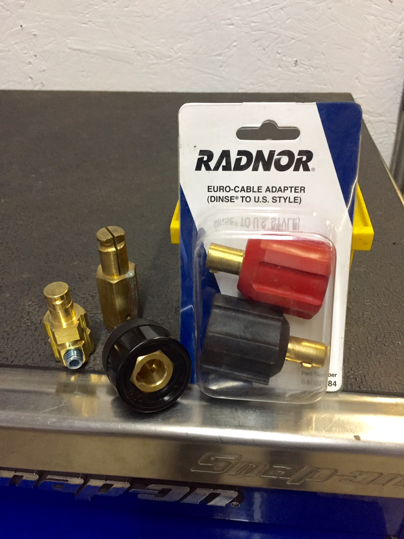

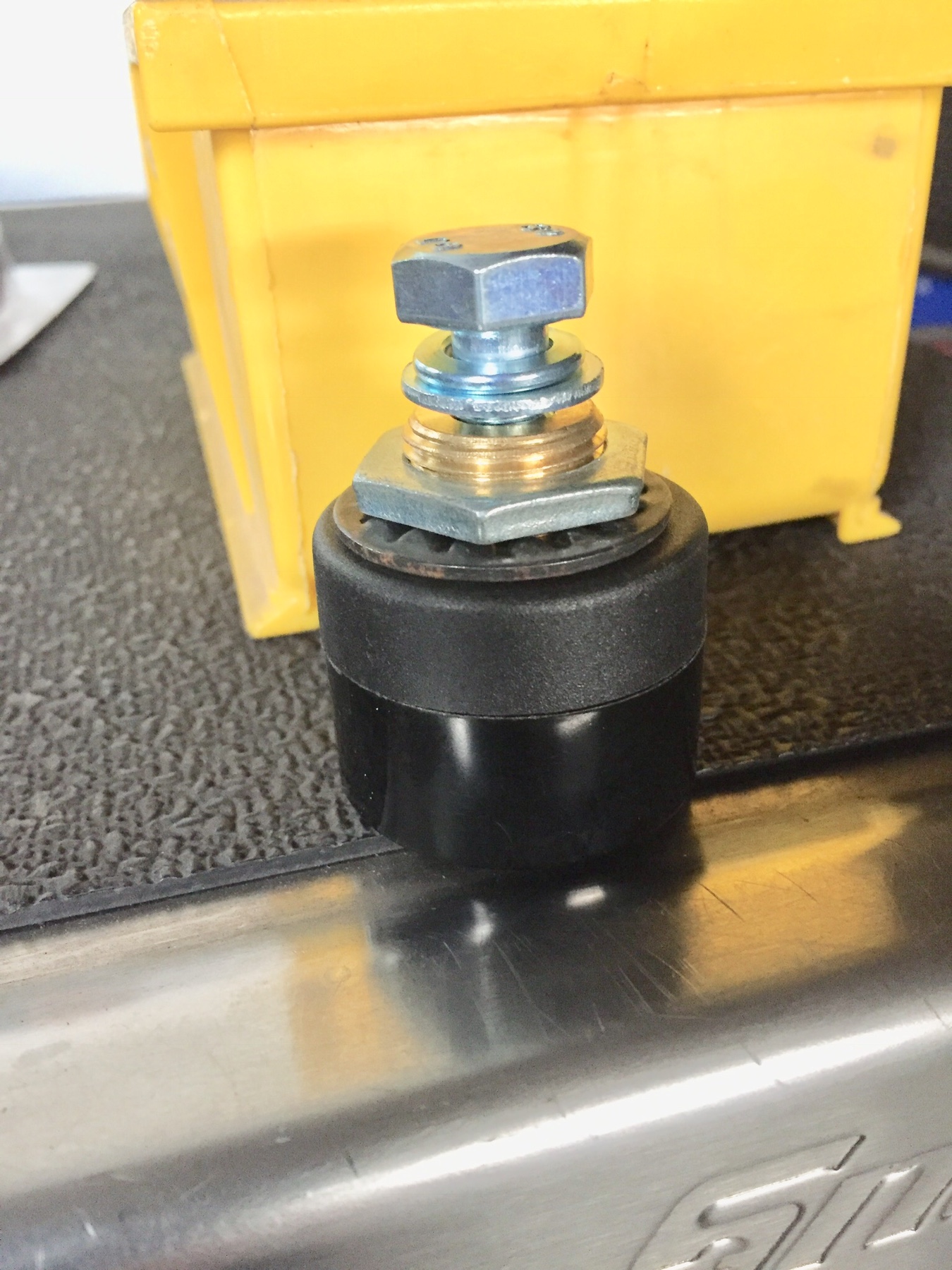

   / Welding lead extentions #5
Bill. I found 1/2" DINSE panel plugs for one of my machines from eBay. They were so cheap I bought extras.
If you can't find the Tweco / Lenco style at a good price you could go with the Dinse panel plugs and use adapters.
Above. Left to right:
1/2" male Dinse. Male Tweco. 1/2" Dinse panel plug. Dinse to Tweco adapters.
Terry
