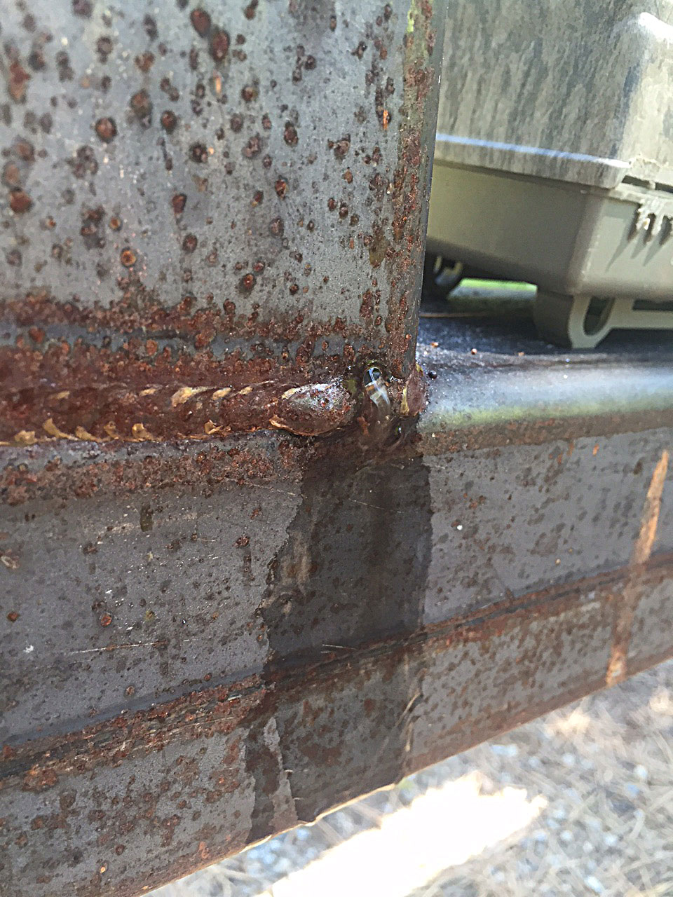

I was interested in the discussion about welding an item "tight" vs "weep hole". I was working on my gate yesterday and was looking at it, thinking about water and wondering if there was any inside it. My gate is welded "tight".
Drilled a hole and water poured out. It poured a lot more, that's how it looked by the time I dug the camera out. Recommend some folks drill drain holes in their "tight" implements and see what happens. Of course a little water in there might be more curiosity than problem (except near salt).
(EDIT: DELETED 2nd PIC with the large pee-stream BECAUSE i found where water can get in that one. The first one was welded tight, no nek'd eye visible entry points.

Can you find where the water went in? Use a rubber tipped air gun to pressurize it and see if you can hear any air leaking out perhaps?

Dan I'm real curious about this, but cant pressurize it as I hace cut other holes, which is come to think of it - is the real reason I thought it needed a drain hole. LD I could agree with what you wrote, until yesterday. Certainly it can be done, is done all the time. In 1981, I welded an aux fuel tank for a friend's pickup (MIG) out of 16ga sheet. It didn't have a single wet spot. It was "open" though. I wonder about the 'finish' when you weld up a closed cavity thats exhaling as you weld and starts inhaling the moment you stop.
I never would have imagined the volume of water, especially in 4 years. I paid a local $2,000 to build & install it as I could not do it at the time. Its 22 feet long and 100+ miles away. I doubt the fabricator gave more than normal effort to "weld tight", I suppose he could have if someone told him to.
Seeing how much water it held you can at least assume the lower welds were watertight (or became that way). Anyway thats why I suggested to folks to drill some holes and see if you find water too.

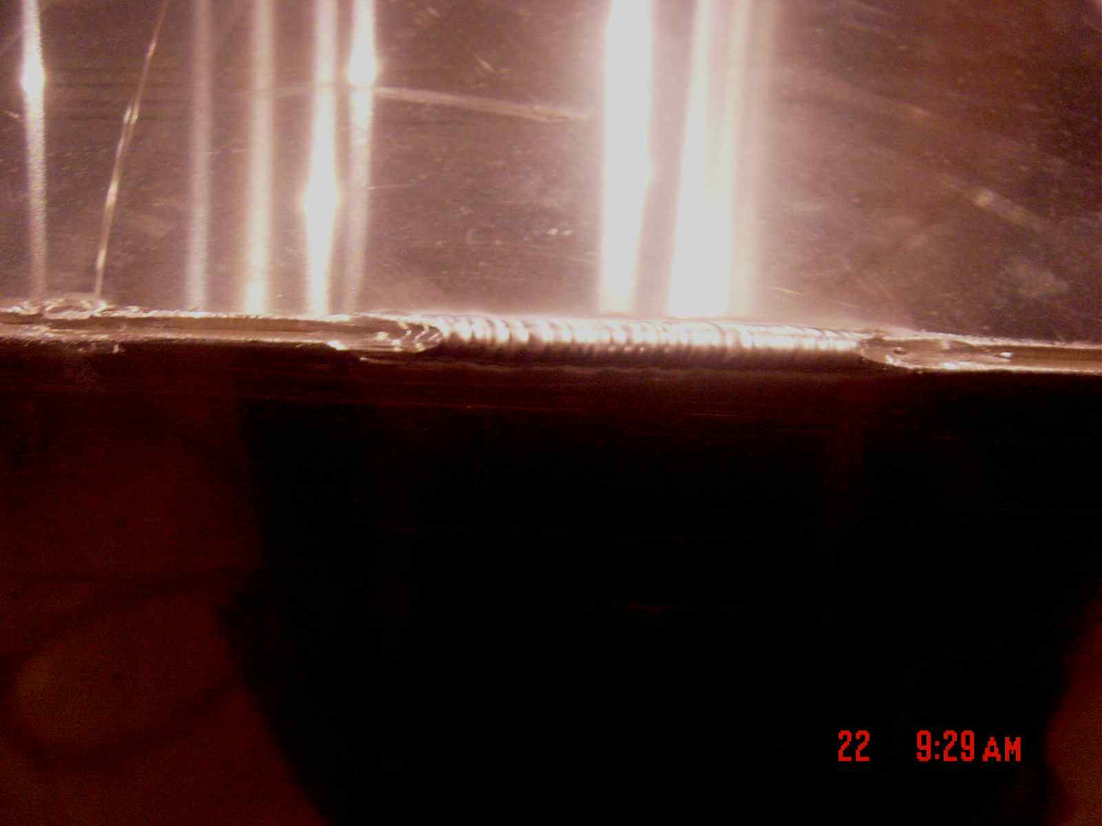

I think where the average guy makes a mistake when welding up something that is suppose to be air / water tight. Is not feathering his starts and stops.

Gotcha, that would help. Great pic says it all!
