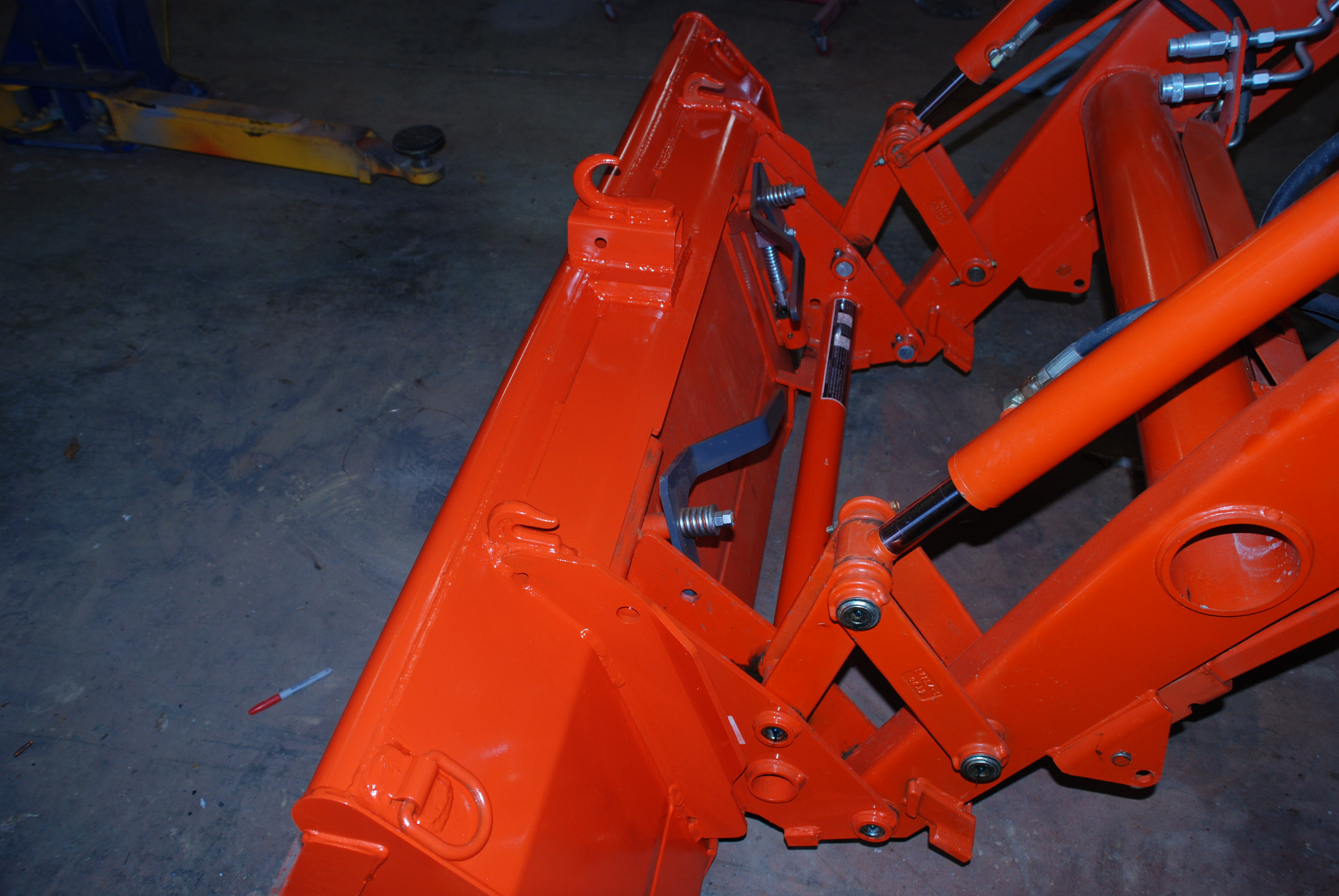

   / Welding bucket hooks - support plate warpage?? #9
Here's a picture of mine.
   / Welding bucket hooks - support plate warpage?? #10
I welded 1/4 inch on the bucket, but used a large tow hook and bolted it to the metal, that way if ever i needed or wanted it off i could.
