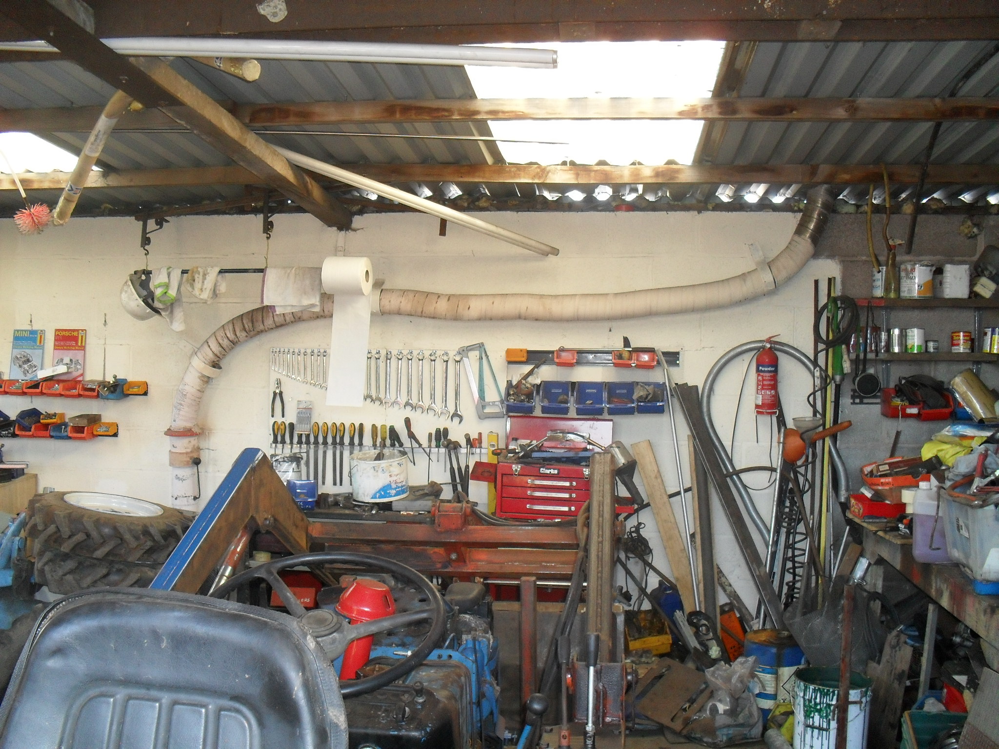

I'm going to weld together some 3inch dia pipe as a new chimney for my stove in the garage.
the pipe is to go up from the stove for about 3 feet then diagonally across the back wall for about 12 feet then up and out of the roof for about 4 feet.
The reason for going across the wall is that the pipe acts like central heating for the garage as it runs along the back wall.
The pipe we are replacing is stainless flexi pipe usually used as a liner in a brick chimney and it is getting past its sell by date due to the extreme heat from the stove.
My worry is that the solid metal pipe will expand and move horizontaly along the wall and then will disturb the roof where it goes through as it will no longer line up.
Am I worrying about nothing?:)

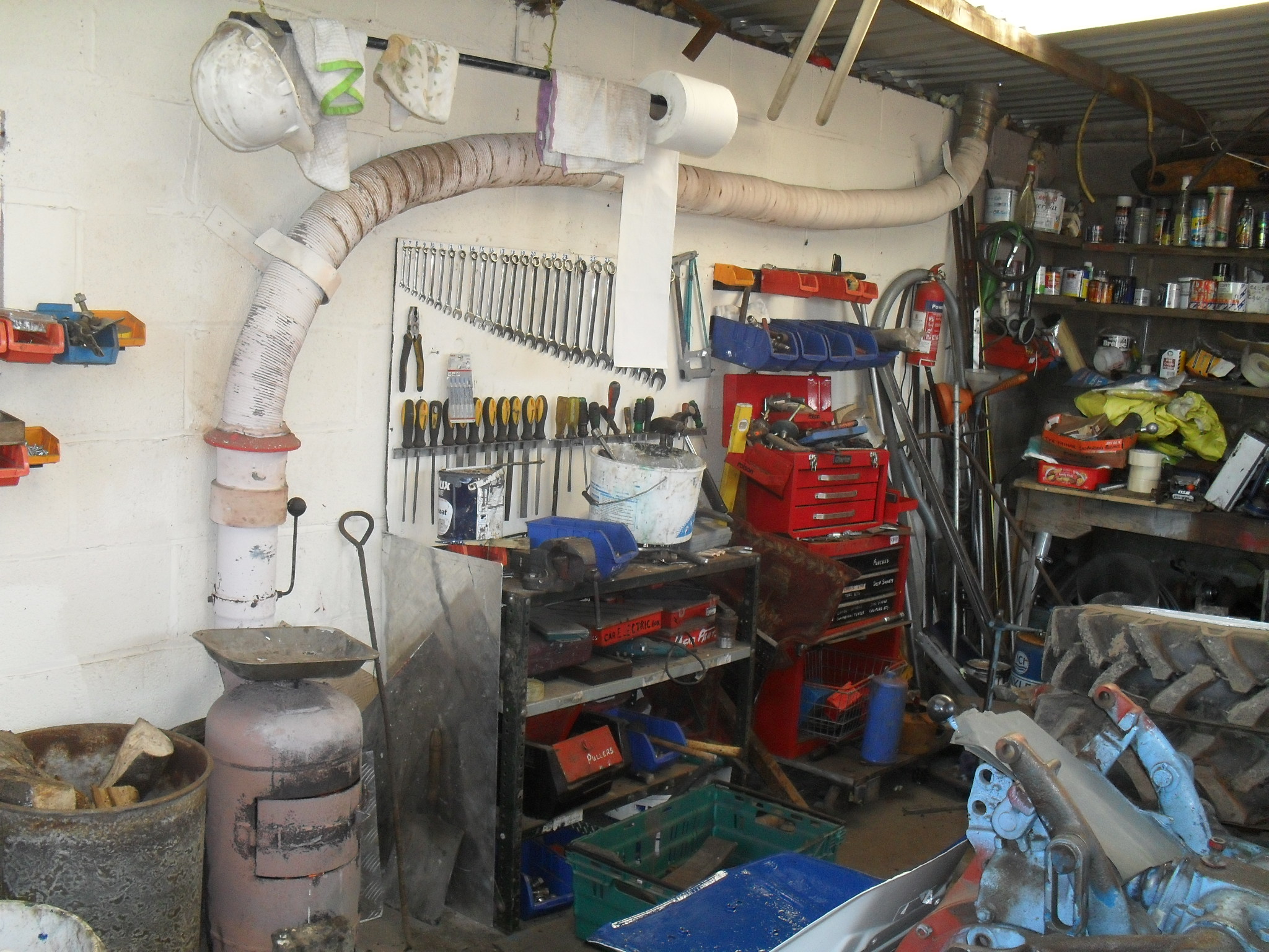

I have used 3inch pipe before and it worked fine
The pipe was about 15 feet high and went through the wall at about eight feet at a 45 degree angle.

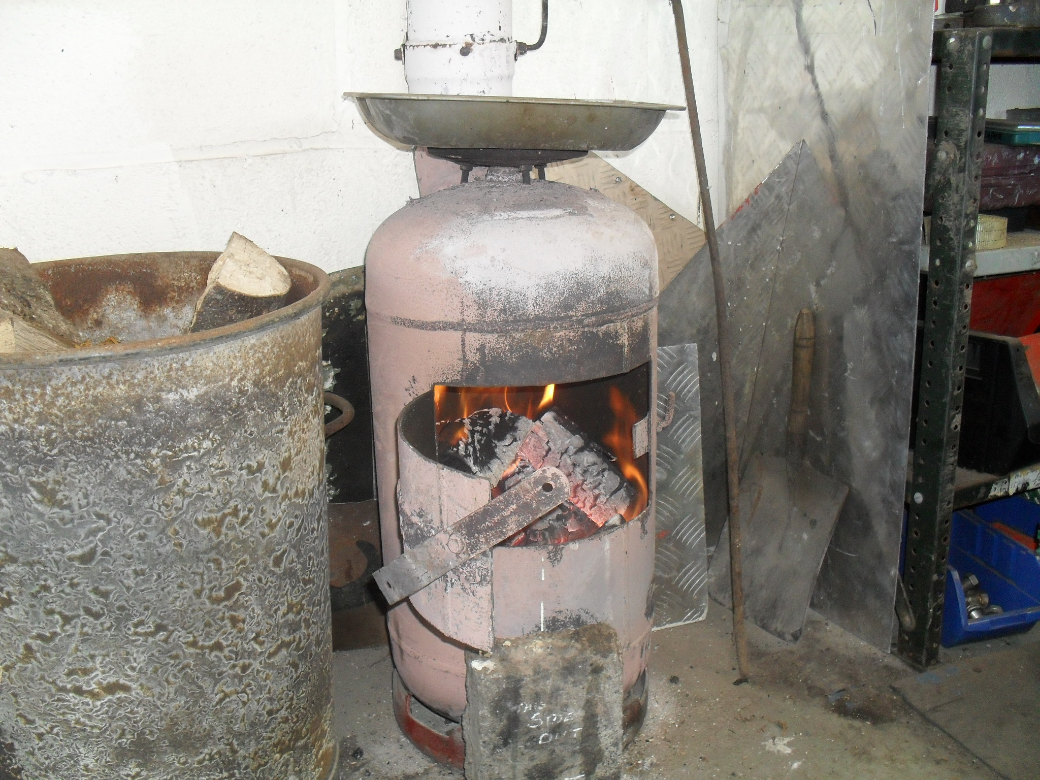

The stove was a converted propane gas bottle with a flue regulator (butterfly) and an air flow regulator at the bottom of the fire so as it could be shut down to burn nice and hot.
The pipe I have at the moment is 5 inch and works fine with no sooting up, it has been in the garage for about two years. It was put in as a temporary thing to get heat in there.
I think the 3 inch will work fine with the very dry wood that we burn, just worried about the pipe expanding between the stove, along the top of the spanners and tool boxes and ending up 4 inches longer and distorting the hole in the roof which will be a tight fit to keep water out.:)
