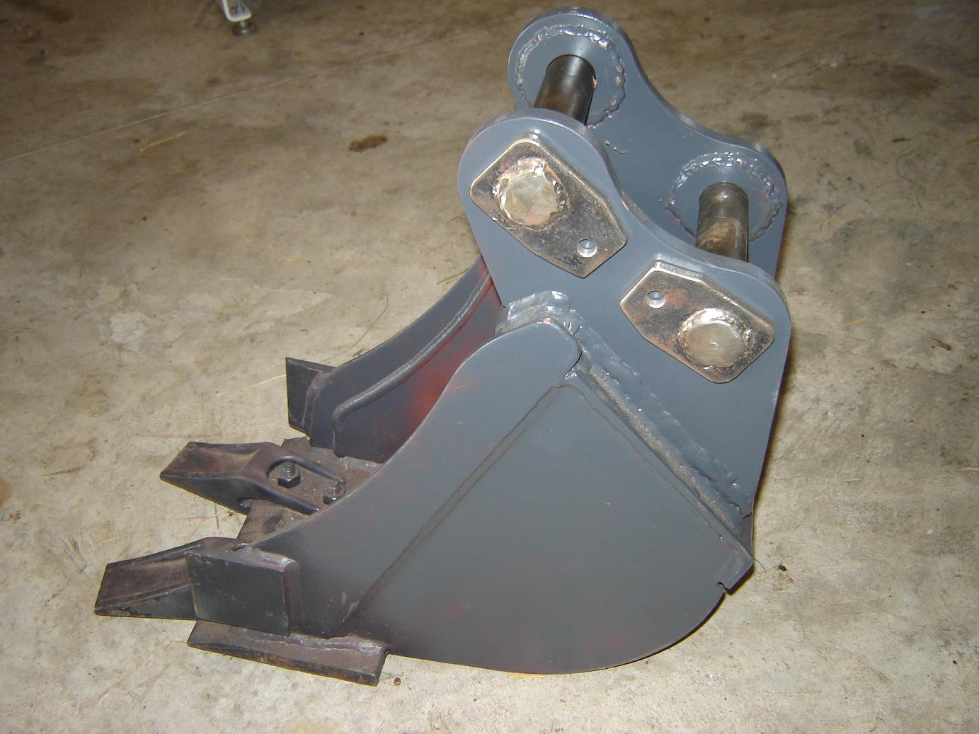

Hey guys,
I am converting an older Kubota cleanup bucket to fit my New Holland BH. Because the pin mount width and diameter is different I am starting over with new 1/2" thick flanges.
The New Holland pin diameter is 1.25". Does anyone know where I can source weldable bushings that I can weld into my new flanges?
Thanks,
Greg

Do you need to have bushings? Most buckets don't use them, as the pin doesn't rotate in the bucket ears. I had the same issue, except that I bought a used 9" bucket for trenching electrical lines, and I did the same thing you want to do.
I torched off the old ears, then welded a new 1/2" plate to the back of the bucket for a nice mounting surface.
Then, "Here is where I am fortunate", I drew up the new ear design in Auto CAD, gave the file to a co-worker, and it was loaded into a water saw - yes it cuts with a high pressure jet. I had 3-pair of ears cut, 2-pair were for future use.
I then cut 3/16" disks to go on the inside of the ears for spacers - I was matching the profile of my existing bucket, allowing the dipperstick to be offset from the inside of the bucket ear. The disks holes were milled to match the holes in the ears. The finished bucket is pretty tight when mounted.
I also made a jig to match the dipperstick profile to keep the ears parallel when welding.
The pins I also made new which will stay with the bucket.
I will upload up some pics this weekend of the finished bucket this weekend.
As an option for you, if you really want to go the bushing route, in another application for bushings, I used sprocket hubs. These are the kind that get welded to a sprocket, but are bored to closely match a shaft size. A pocket could be milled to fit the bucket ear, then weld the bushing on both sides. One drawback of using them is having a keyway cut in them. In my application I rotated the keyway in the direction that wouldn't receive any major force on it. After many years of use, they are as tight as ever.

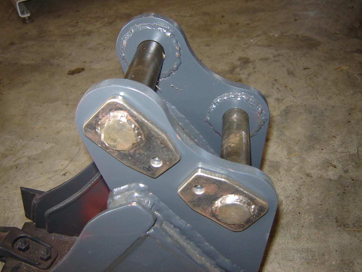

After re-reading the earlier response by GE22 (his 2nd sentence) and watching the movement of the bucket curl, it donned on me that these pins don't rotate in the bucket flanges. The only parts that rotate around the pins are the bucket curl ram-to-pin connection and the dipper stick-to-pin connection The pins themselves do not rotate in the bucket flange.
This would indicate that the bucket flanges don't need bushings. The flanges just need to be reinforced in the area where the pins slide through and the hole diameter in the flanges just needs to be snug enough to not allow free play between the pins and the flanges.
Much simpler than I thought... :)

Yes that is correct. In most cases, the pin does not rotate in the bucket ears.
Often times the pin has a plate on the end with a bolt hole for keeping it in place, (bolting it to the bucket ear) instead of a cap at one end and a keeper pin on the other.

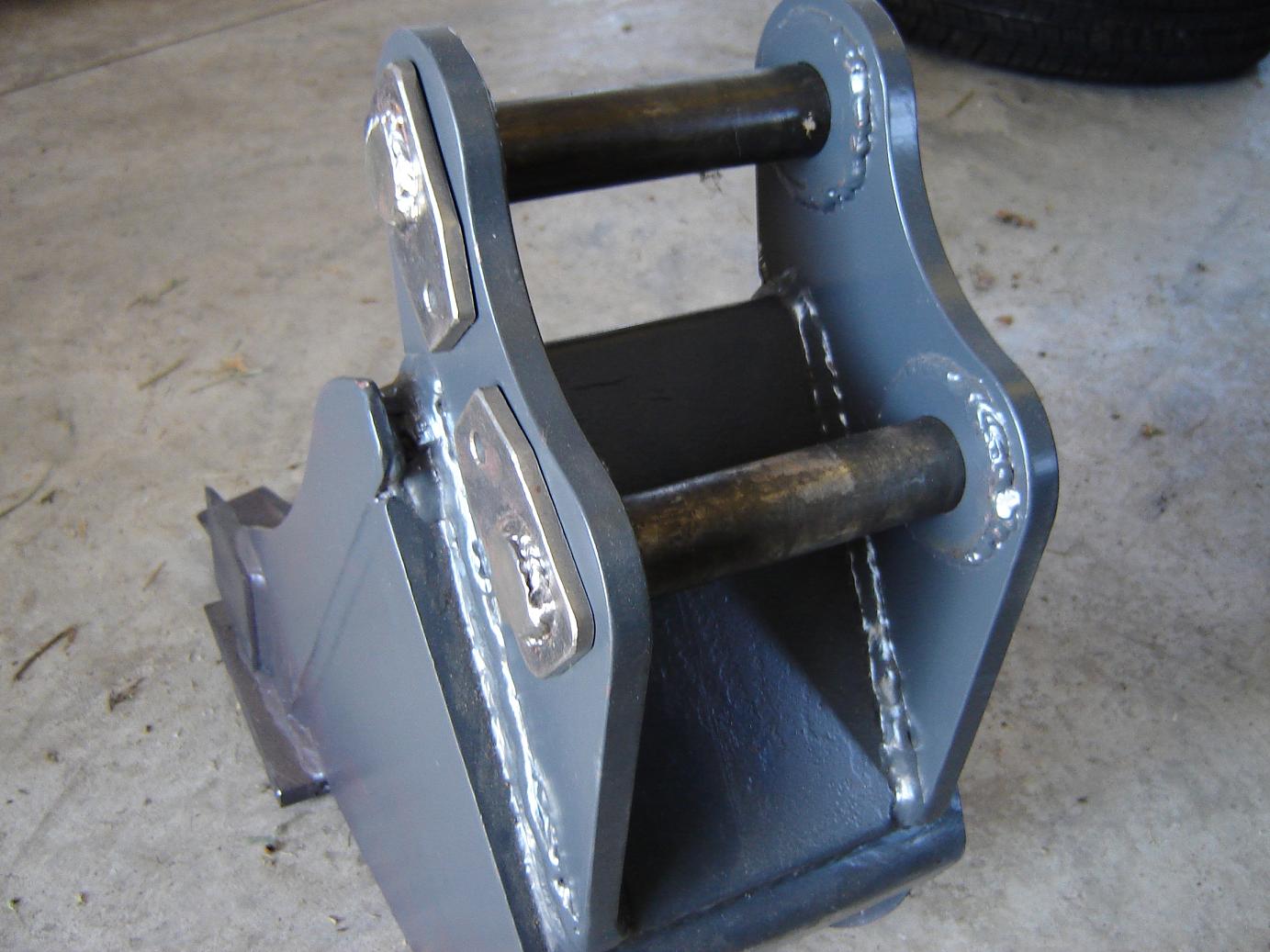

I made up a jig to hold my ears in place for welding. I also kept the pins in the holes as well. My pins had a very close fit. So close that the surface rust from me handling them made them tight. A very light touch with emery cloth and oil made them turn freely again.
I was very careful to tack the ears all over, and periodically rotating the pins to verify alignment. Then I welded longer beads, stopping again to check the alignment. There were times when the pins got tight. I would add a partial bead on one side of the ear or the other to straighten them back again.
I used a stick welder, as I have been welding with one for over 25 years. I wasn't as comfortable with my wire welder yet.

Pictures of the almost finished bucket.
All that remains is to drill and tap the ear for the pin retainer bolt. Bucket-1.jpg
GE222...looks good. Nice job.
Even though it eventually wears off, paint always gives things that finishing touch too.
I may try and take some pictures of mine for the benefit of the group as I put it back together.
~Greg
