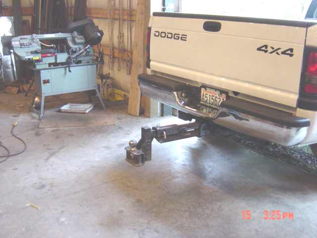

I built this hitch for a friend years ago. See the skip welds in the center? What kind of leverage load do you think this hitch sees?

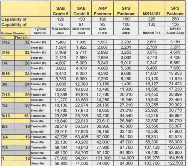

Thanks for the input all. Shield Arc, I've never seen that graph with all the different bolt strengths. The bolts I got to hold the brackets to the frame are 9/16 gr 8 and the bolts that hold the cross piece to the frame brackets are 3/8 gr 8. Reese originally supplied the same sizes in gr 5, at least that's what I took off the truck.
Looking at the graph above, the 9/16 gr 8 bolt is good for over 28k lbs of tension and over 22k lbs of shear. The 3/8 gr 8 bolts are rated for over 12k lbs tension and 10k lbs of shear. I don't think my 5000lbs of tractor and trailer will break those..I hope! As Arc Weld and Sodo point out, Reese probably over engineers the hitches by a significant factor. Maybe I'll just stop being so OCD and bolt the thing together! I gotta stop overthinking the little stuff. I do really appreciate all your input though. That's the great thing about this forum, no matter what you're trying to find out there's someone (usually many more than one) who's been there, done it and got the T-shirt so the rest of us can avoid the same pain.
