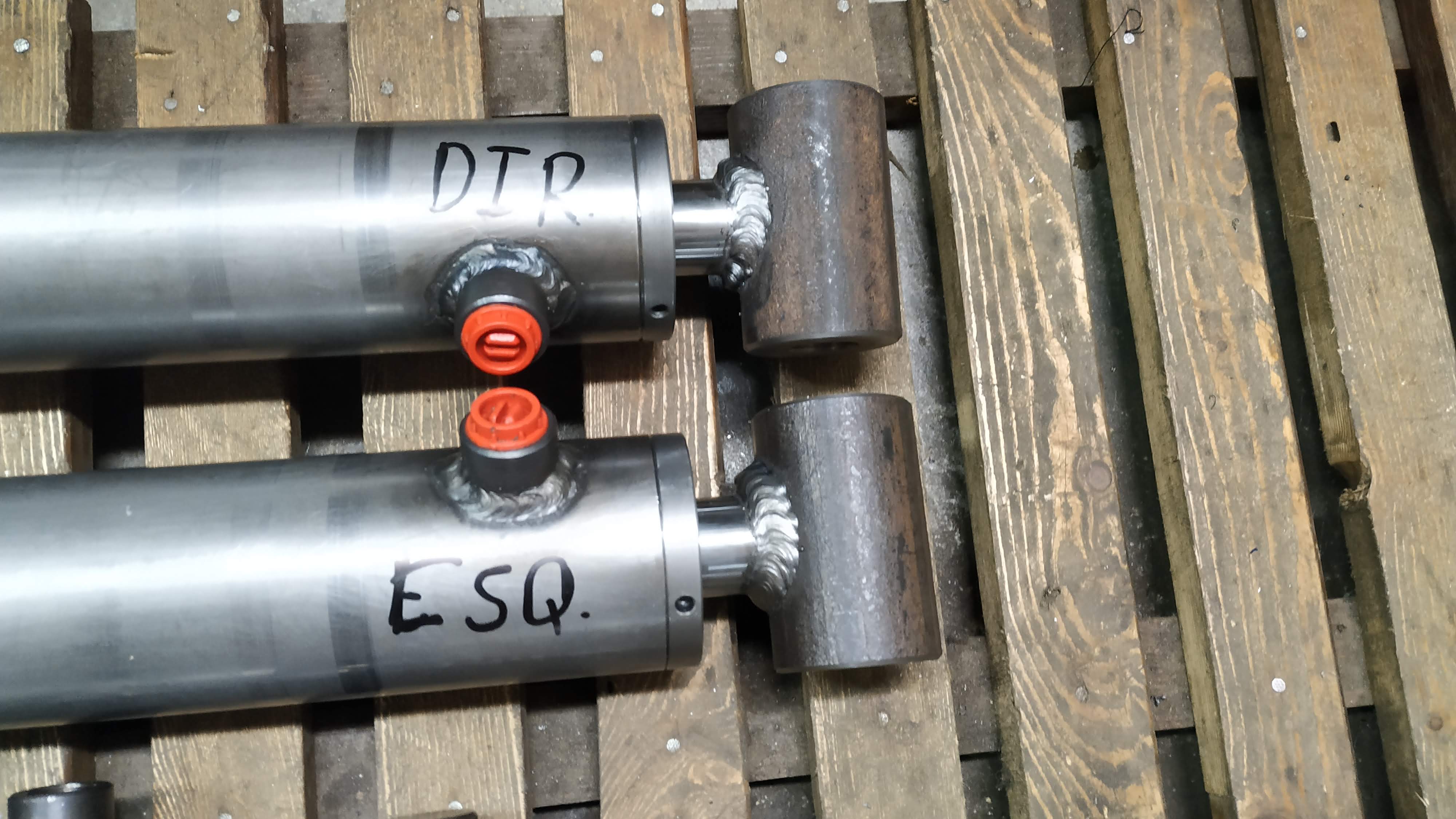

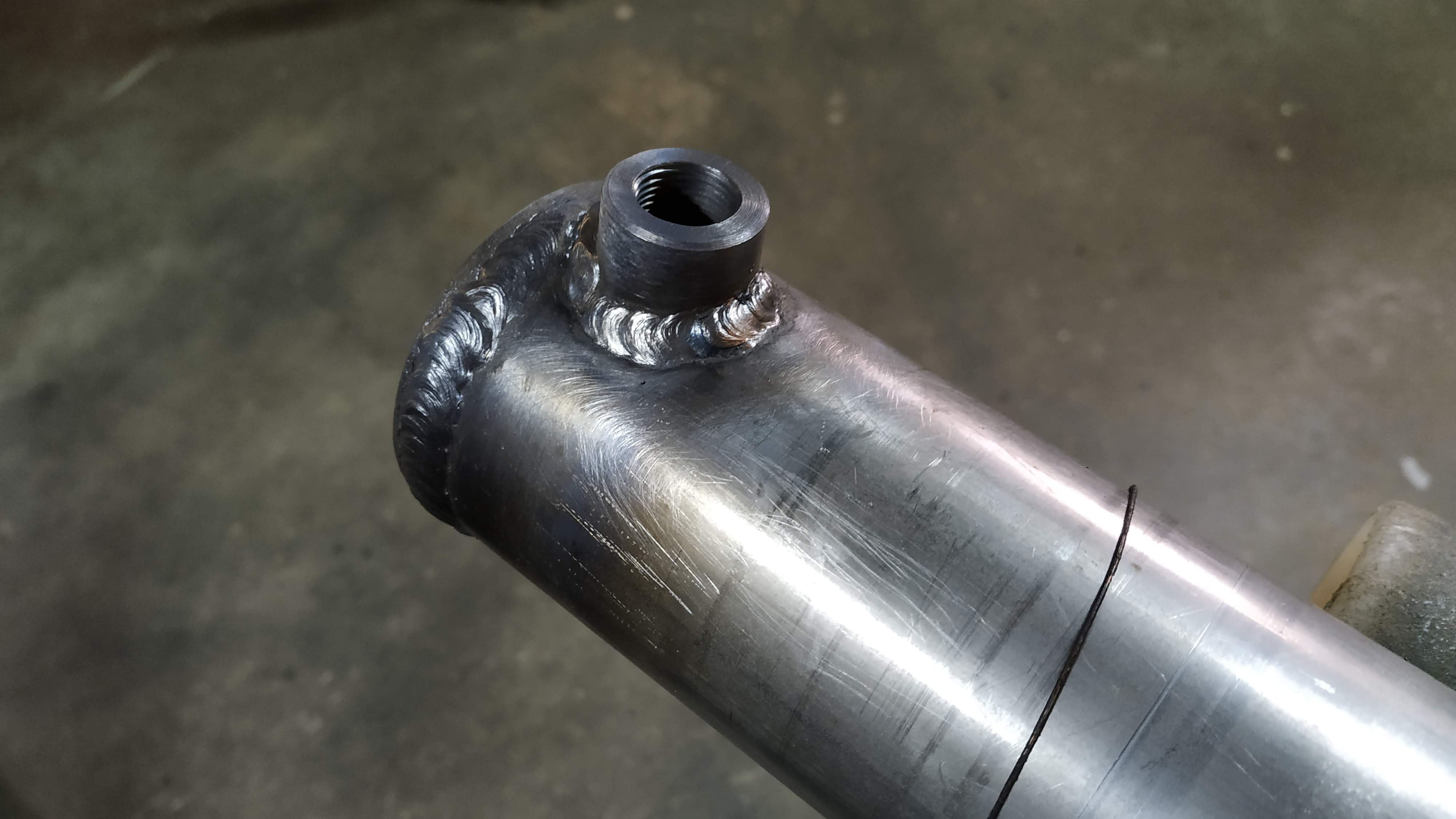

I built the cylinders for my homemade loader from scratch and used 6013 on everything. Worked very well and haven't any problems so far.
   / Weld broken hydraulic cylinder stanchion rod #7
View attachment 670759View attachment 670758
Oh those are real nice welds man, very nice! I'm new to stick, actually I'm fairly new to all welding actually, but I sure do like welding with 6013 as well.
