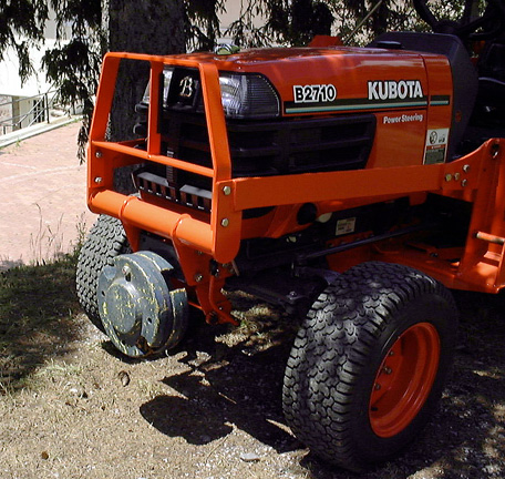

   / Weights? #4
This is what I use on my B2710 for cutting with the rotory mower. (see attached photo) adds about 150lbs.
