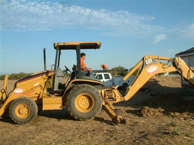

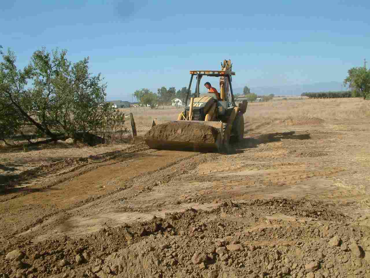

The contractor who installed my septic system used a Cat 420D TLB weighing over 12,000 lb. Mike, the operator, drove back and forth over the leach field while backfilling and grading the trench without damaging the pipe in the ground.
Don't think a puny 3500 lb is going to cause you any trouble unless your septic/well system has design problems.
