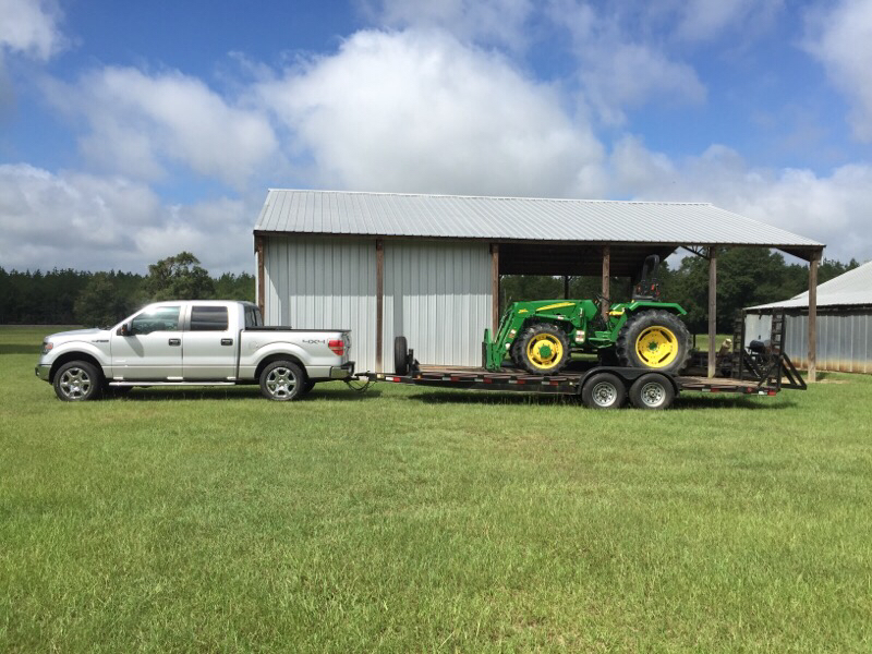

Am in the process of evaluating weight distribution hitches for a F150. Here is picture of previous tow vehicle with trailer and tractor with no rear mounted implements.

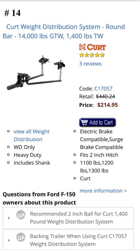

Here are the two hitches am considering. This will be for occasional moving tractor 30-40 miles a couple times a year. All input, warnings or suggestions welcome.

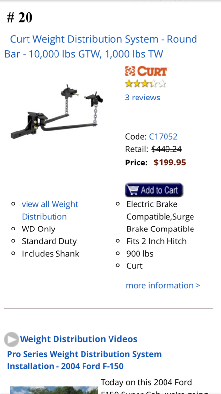

Second hitch.

I'd get the heavier WD hitch for the few dollars difference. My 22' tilt trailer has an empty tongue weight of 1105 lb. I have an older Reese WD hitch with 1500 lb. round bars but mainly use it hauling my dump trailer. They tongue weight of that can get pretty heavy depending on how its loaded. I can switch it to the tilt bed but usually don't need it.
What is the max trailer weight and max tongue weight rating for your truck? It should be in the owners manual.

Loaded with implement it will be at limits or little above. Was curious if opinion was to go with heavier hitch for little difference in price. Have pulled this set up with several different half ton pickups without weight distributing hitch for several years without any noticeable issue. Figured adding the wdh would be a step in the right direction.
