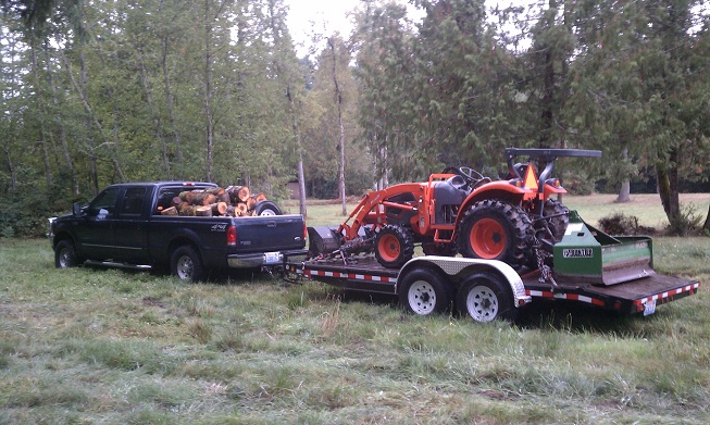

I do. I use WD hitches for both my 25' RV and my 10k EQ trailer. They're great and like you said, actually required if you do your research.

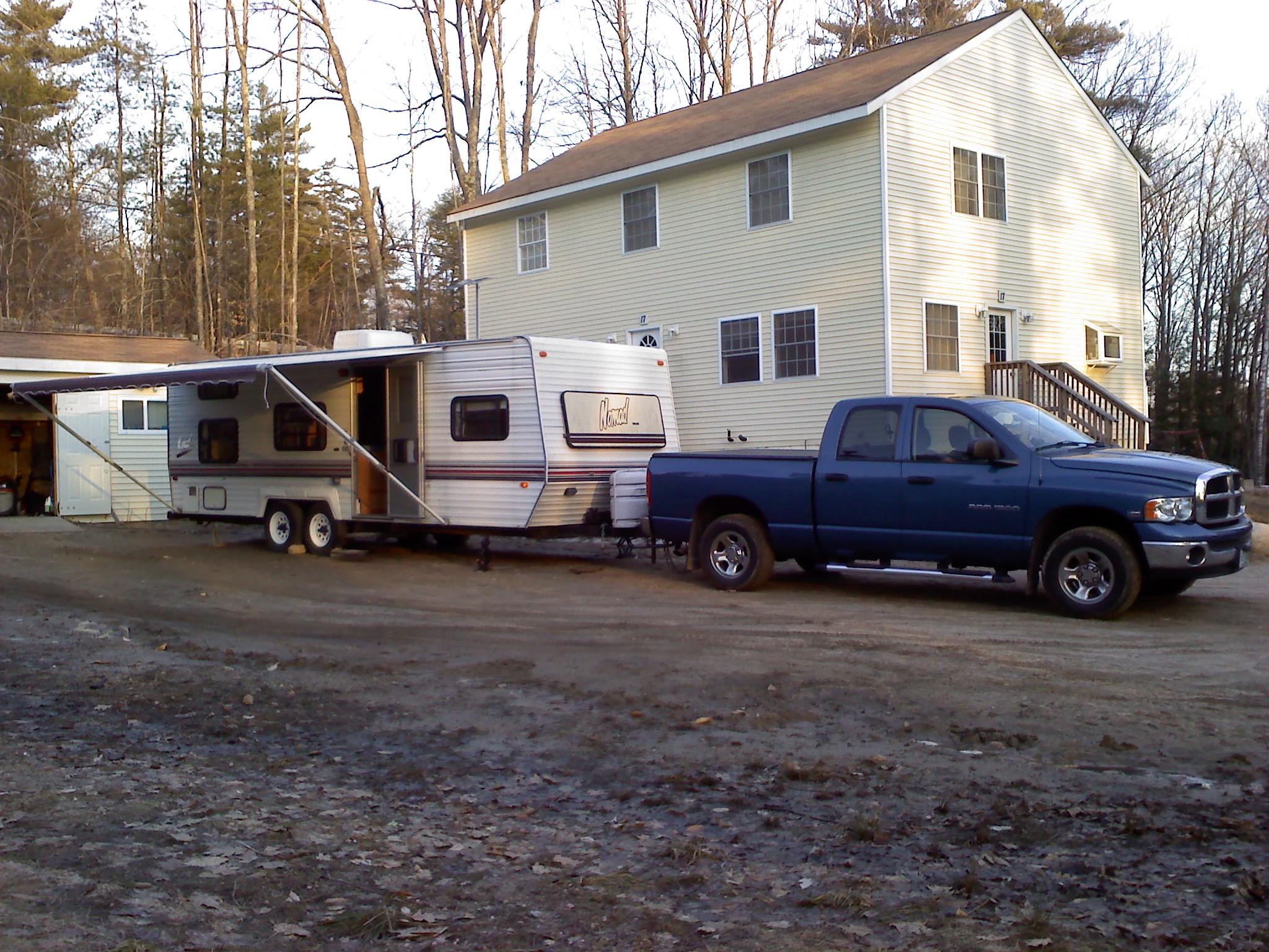

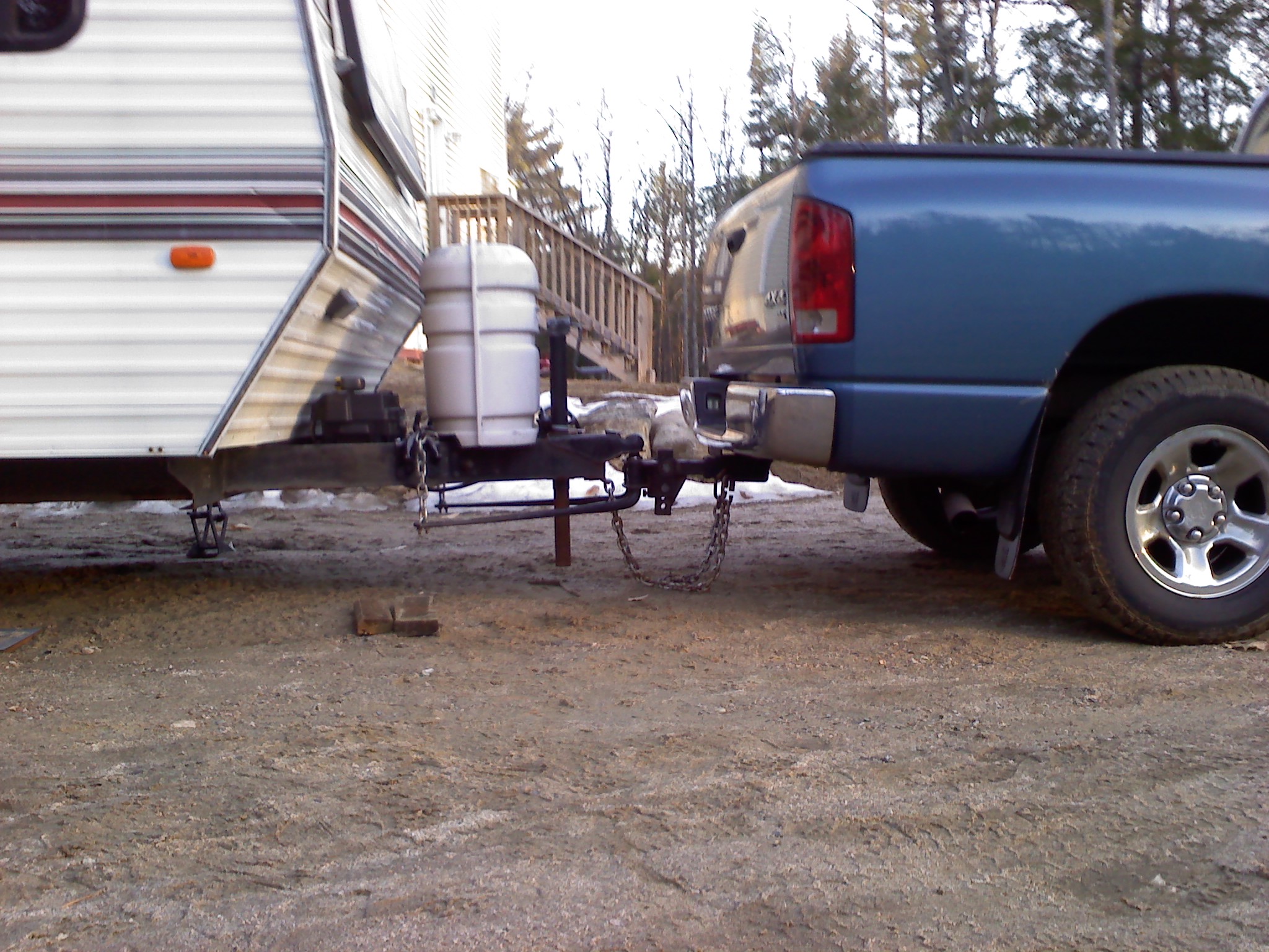

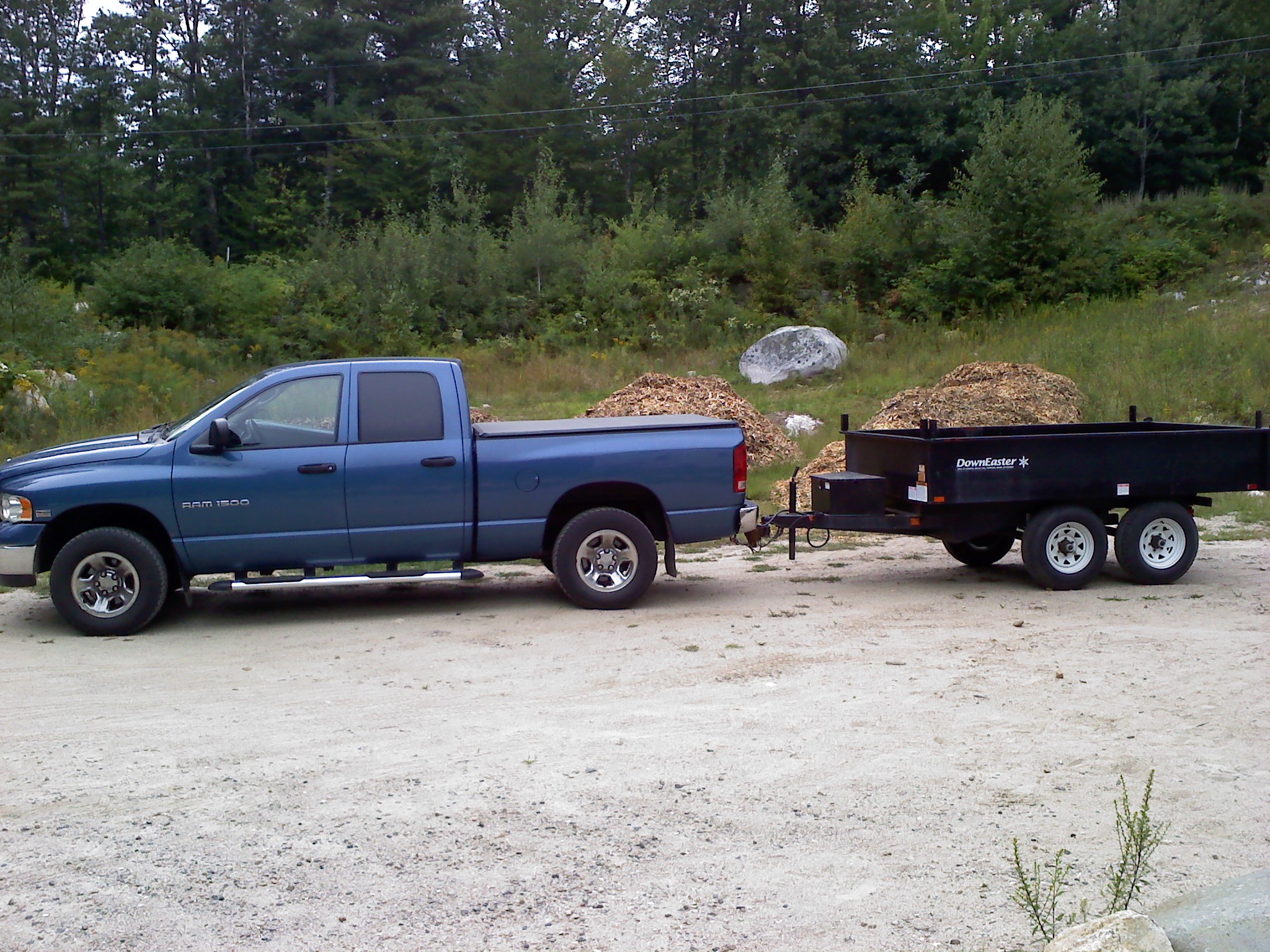

I have yet to hook up my WD hitch to the dump trailer but use it every time I haul our 27ft travel trailer. With the dump trailer, you would have to really try to put too much tongue weight since the box is so small and centered over two large axles. With the travel trailer, it's a good 10-12ft from axles to hitch and lots of weight up front with the master bedroom up there.
Even with a decent load on the dump trailer (6k lbs load on 1,870lb trailer) my 1/2 ton RAM didn't squat more than 2-3", it squats 4-5" with the camper without the WD hitch. There's less tongue weight with that 8k lbs load then my 4,600 lb travel trailer mostly due to length from hitch to axles.
