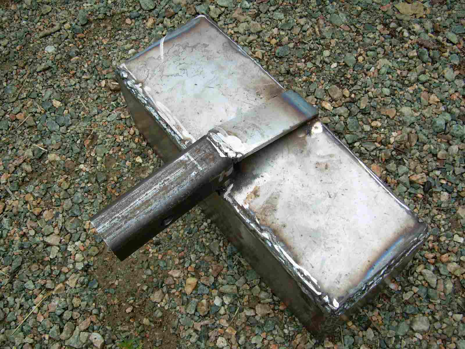

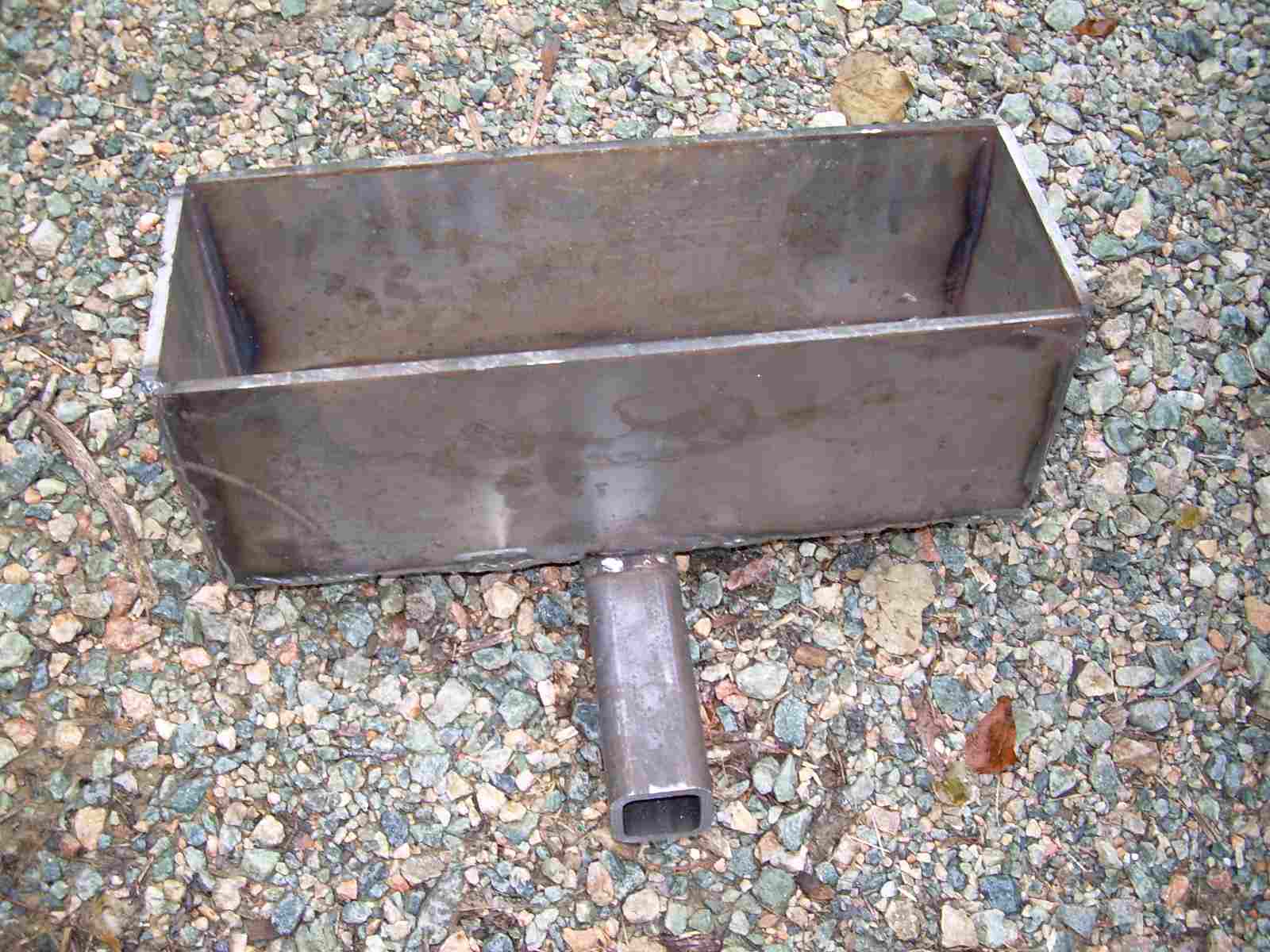

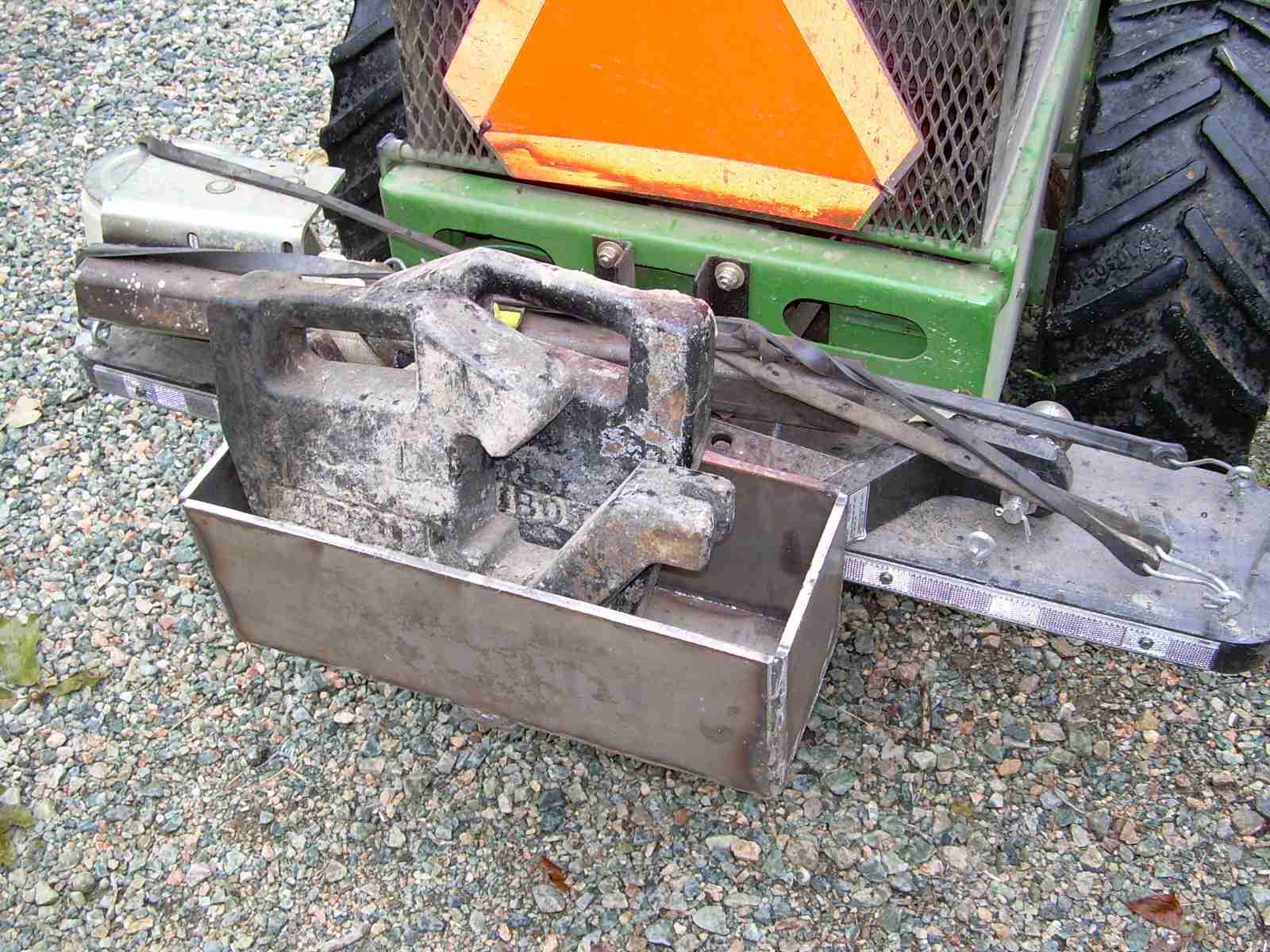

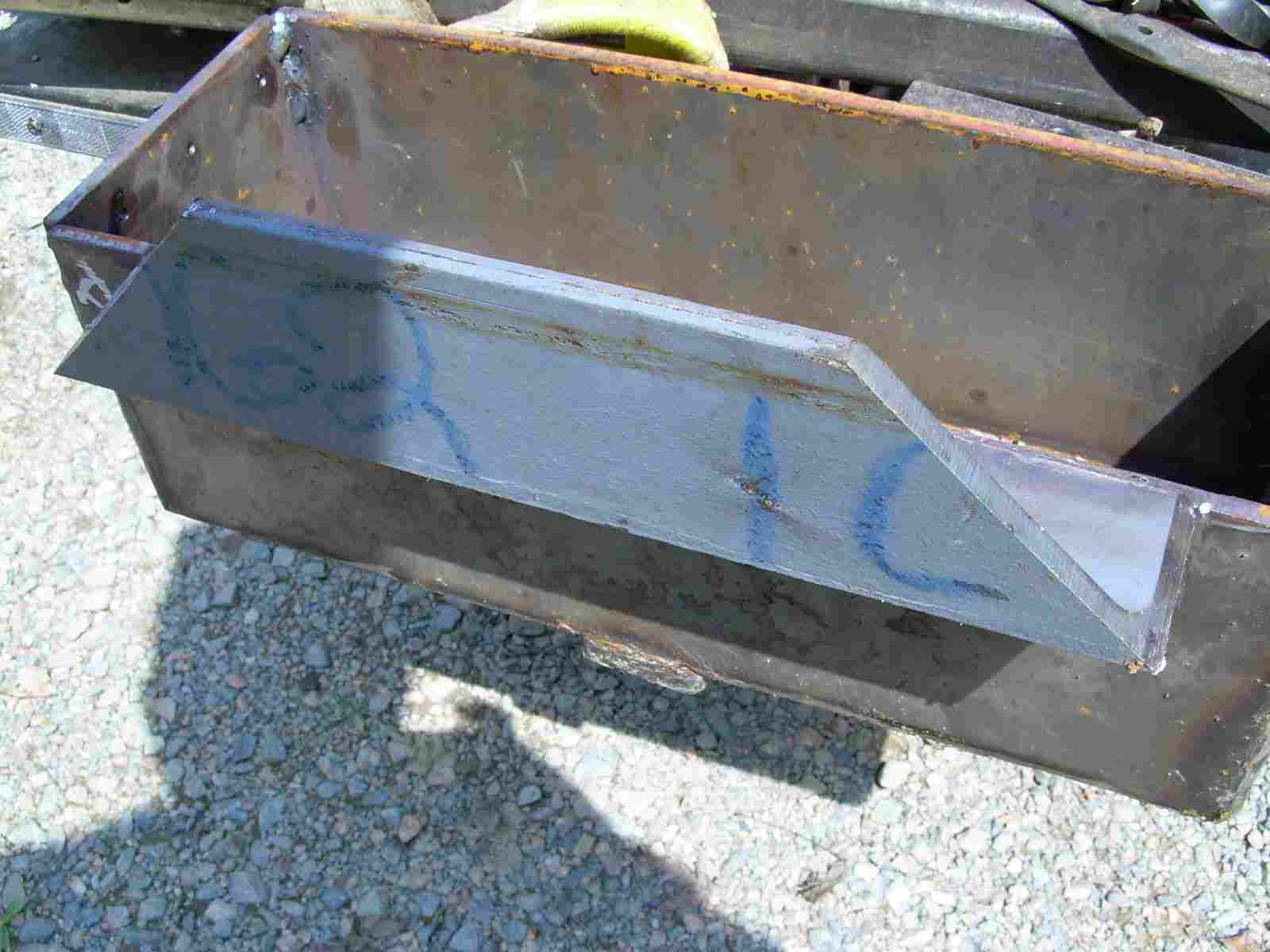

Today I finished welding my weight box that fits on the 2 inch receiver on the back of the 422. I wanted to use up the short piece of 2inch receiver tube, so I welded a flat plate on the bottom to support the back of the box. This also means the back of the box is higher and less likely to catch on stuff as I drive through the swamp.
The box is about 18 X 6 X 6 inches. Please make any comments about improvements before I paint it.
One picture shows it with two 55 lb Kubotoa weights.

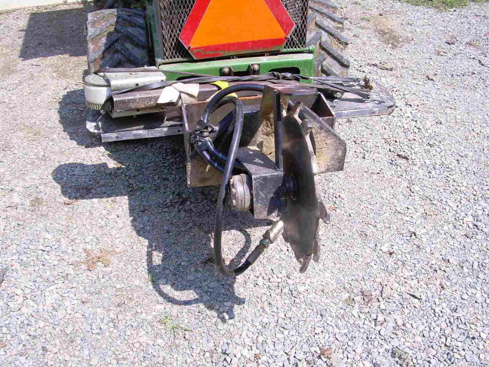

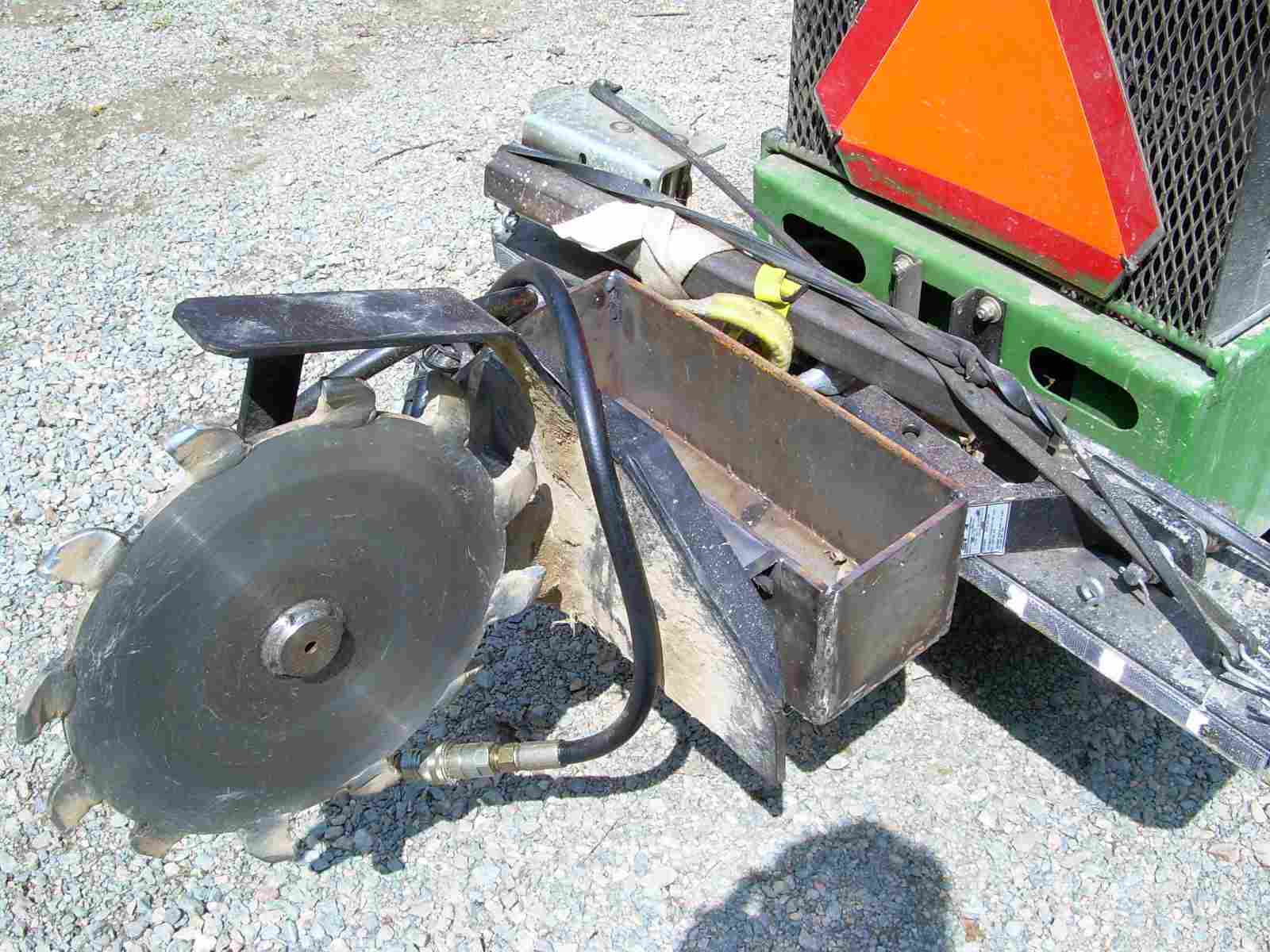

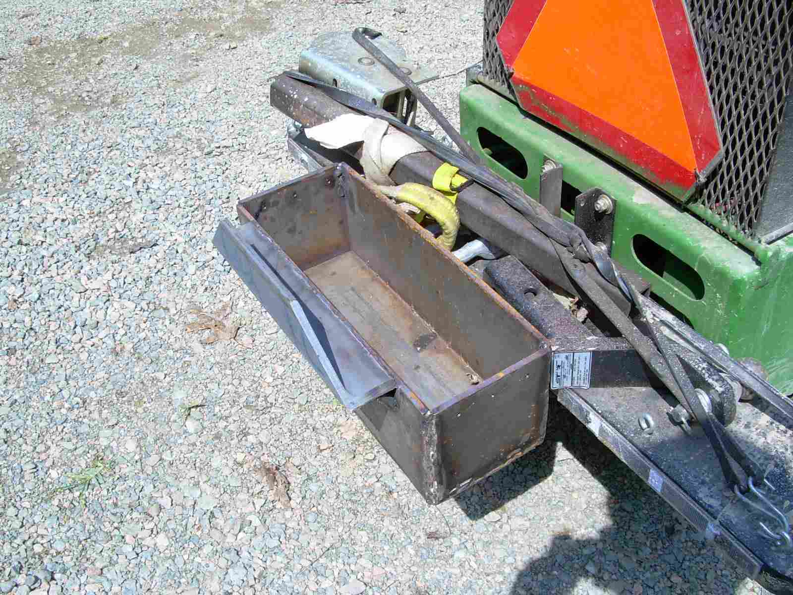

I added a plate to the back of the weight box which allows a me to put an attachment on, not for use, but just for transport. I drove around with the stump grinder today and it fell off. I need to develop some kind of latch to prevent this. It works find on smooth pavement or even rough ground, but I was working with the wire plow on the front.
You cannot put an attachment that you cannot lift by hand, but the stump grinder and 2 inch receiver are pretty easy to load.
I have attached a few pictures.
