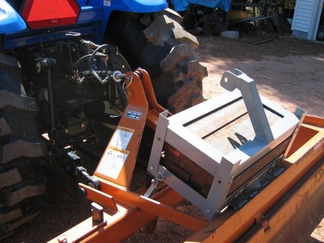

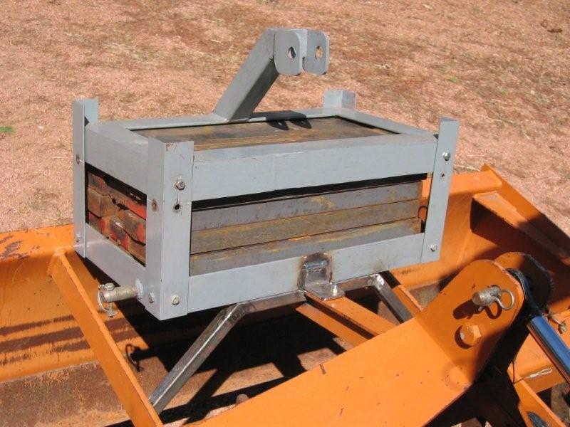

I don't plan on blocking anything. I have a 2x2 weight box I made for my John Deere that when filled ( I have bar stock cut offs 15" to 22" ) is approx 460#. I want to attach it on the rear slanted verticle brace.... so it will be above the box section still providing center weight for the entire 6'. I have tip and tilt, but like others have found the teeth seem to ride over rocks rather than bring them to the top. ( the flat smaller ones ) I'm going to give it a try.. no expense just time.

This is how it looks ready to use. Definately adds weight as I can feel the hydraulics load the rear tires. Remove one bolt and slide it out of the guide pins to remove. This is the weight box for the JD 4110. As soon as I can figure out what 46' of 1 1/2" x 3" bar stock weigh plus 62 # for the case I will know the total pounds added.
