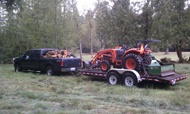

Just a couple of photos before leaving the jobsite after falling, skidding, and either stacking, or bucking and loading a good 10 trees with my CK30. Pushing 945 hours on her now. I use one of those drawbars on the 3ph with a grab hook to pull the logs with chains. Skid length was about 400 feet.
Tractor loves to work though the front tires are getting a bit worn.
This is some of us drive one ton trucks. Truck weighs 7500, no less than a ton of wet red alder in the bed, 2500 lb trailer, 4500 lb tractor, for a total of 16500 going down the road. Don't do this with a half ton pickup.

Nice pics. What yrs your pickup? Diesel? Tranny? Quite a load, but balanced good.
Why i'm asking is I'm planning on buying a 3/4 ton crew in the next yr or so. In the '02 to '06 vintage.
Had good luck with your pickup?

The F350 is a 2000 with the 7.3 powerstroke and auto trans. I have lowered the rear end to the F250 stock height since I appreciate a lower tailgate height. Always always always buy the one ton SRW if they offer it instead of a 3/4 ton. The only difference is 1100# of allowable payload capacity. That's big, it makes my F350 able to haul 2400# instead of 1300# in the bed.
Since you say 02 to 06 you must be looking at dodges. I agree with your year range and shoot for the 5.9. That's what I initially wanted but the 7.3 was cheap, like half. It has never let me down. I really like the huge crew cab on the Fords.
I've put 20k on it in the last two years with about every tank of fuel including some towing or hauling. Makes it tough to measure mpg. It's not as good as people say, 12 towing, 15 short drives to work, and 18+ on long empty runs. I can acutally slide a full height 5 gallon bucket under the oil pan for oil changes. It's a real truck.
