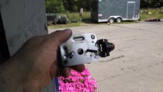

this is a strange primer bulb as it's part of the plate that covers carb, and then air filter assembly screws onto the plate. There are no fuel lines on this plate or the primer bulb. the primer bulb must somehow push air to create vacuum to suck fuel (??). Here is a pic.
I thought 2 strokes are typically around 120 PSI, and 90 PSI is too low. My brother brought over his Echo GT2000 curved shaft weedeater and it won't run. This time I first checked compression. After 4 pulls it reaches 140 PSI.

Two different models from two different manufacturers won't necessarily have the same compression. Even so, 95psi dry, and 115psi wet, while a bit low, is in the ballpark. It's certainly high enough for it to run. That fuel bulb's plumbing can't be open to the atmosphere, because it wouldn't create any air pressure. Gotta be air leaking in somewhere, causing it to go lean. Are you choking to start it? Will it keep running with the choke part way on?
If you can't track down the leak, don't pour good money after bad. That machine isn't worth the cost of a motor rebuild.
