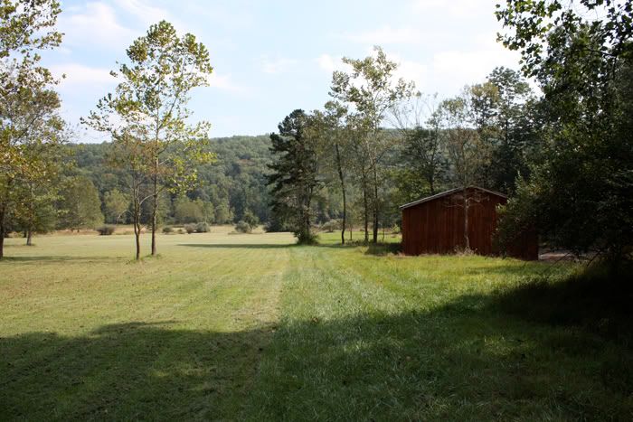

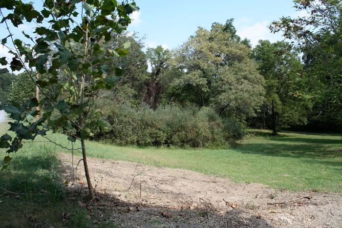

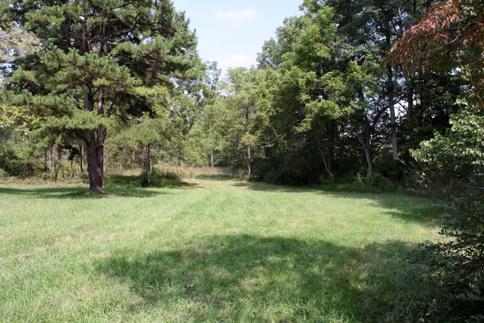

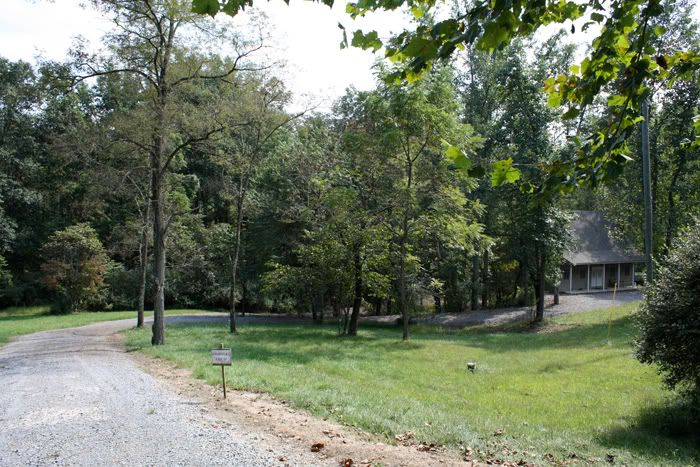

Im gona post a few pics here in a min that shows what I need to mow.
its not Often its 1' tall, but it does get tall mowing every OTHER weekend. We go there on the weekends, and if its raining we jsut dont get to do it.

I'm like the others. I don't think a ZTR will do the job. You need a bigger tractor with real hp and torque. I regularly cut 1 ft grass with a 60" finish mower on a 20hp FarmPro 2420 and a 72" finish mower on a 30hp Ford 1900. Neither one will cut it perfectly as it's just too high for that type of cut. And a brush hog while a better solution won't cut it evenly all the time when it's tall and thick. I've found that when it's tall that cutting 1/2 at a time will cut the 1 ft grass and the other 1/2 of the mower deck is on the 2nd pass of it. That seems to work the best. The 72" deck is a Woods RM. And Blade sharpness doesn't seem to matter much for cutting evenly. More important is keeping the RPM's up so that the mower deck is spinning at the rated speed. And if you try going fast it just loads down the PTO even more. I would imagine that a 50hp would probably do a better job at higher ground speeds but then you'd burn the deck belt up easier. There probably is a better way but I haven't seen or heard of it yet. The other thing I've noticed is that a compact tractor with a good size mower deck will get hot when running these mowers. I'm guessing that a 72" deck is just a lot of load on them requiring a lot of PTO power when trying to cut it quickly (like I do).
