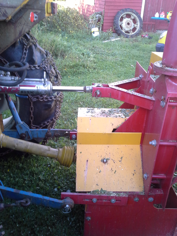

Its a Jinma WC8
   / WC8 Wood Chipper, any weakness to look for when buying a used?
#9
The toplink is a bit strange, must been made for minitractors.
