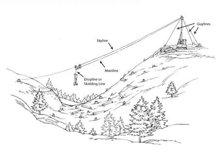

Or run a cable from a bottom tree to a top tree. Hang a pulley on it to support the battery. Run a line from the pulley to the tractor. Drive the tractor back and forth to lift and lower the battery.
Similar to this logging rigging.

...or winch (electric or manual) in place of the tractor.

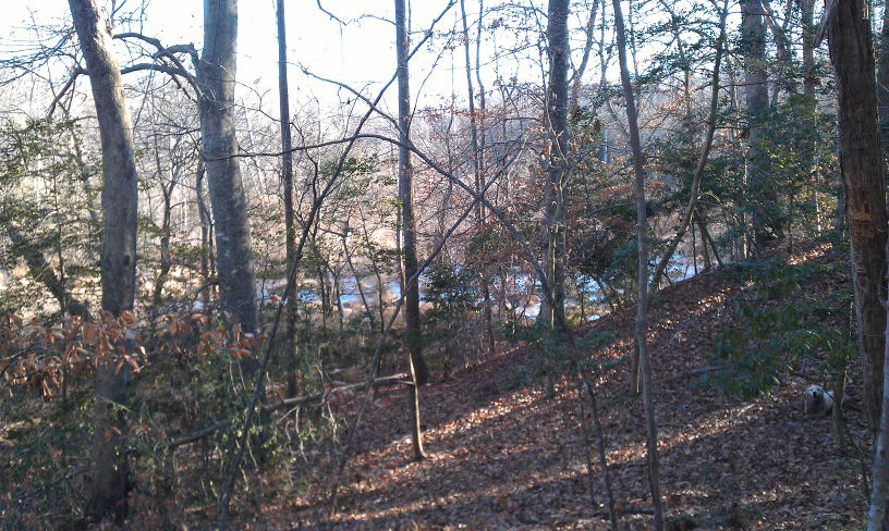

I'm not averse to using two smaller batteries, as long as they would be appropriate for the purpose, which is to run a trolling motor. The owner's manual says that a deep-cycle marine battery with at least 105 ampere-hours should be used. As for using a wagon, I'm not sure whether it would be practical, as there are many trees in the way and the ground is extremely soft and loamy. Here's a picture of the general vicinity:

I agree the bigfoot hand truck would easily handle that terrain.
