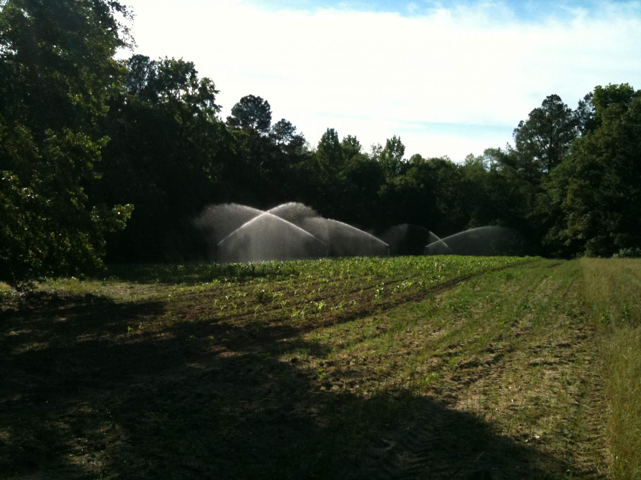

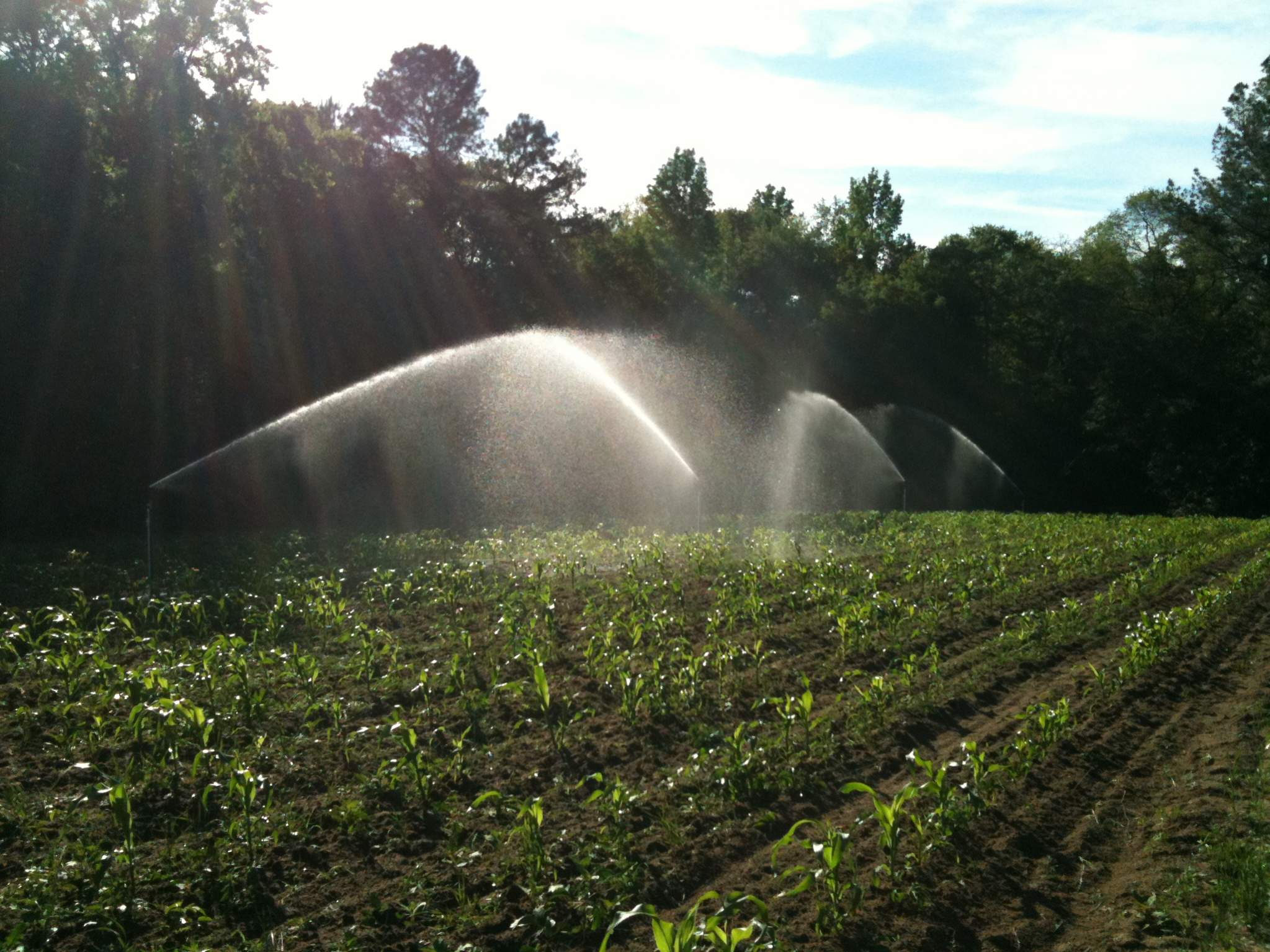

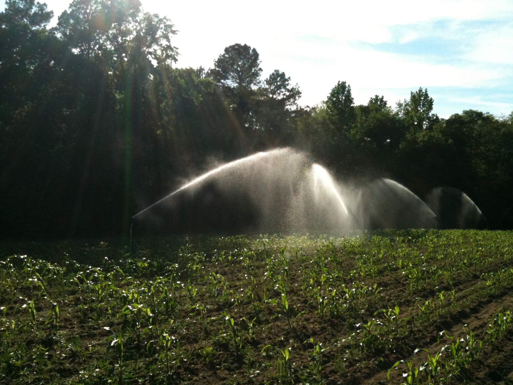

Here is a project I put together this spring. Watering near one acre.

Looks great!! How deep are the lines? Do you have to remove anything during the harvest, or after? To turn the ground I mean.
   / Watering the corn
schedule 40 pvc sitting on top of the ground as of yet. 2 inch main line with five 1 inch risers. Rainbird Falcon sprayers on that. When I get ready to move, will probably cut line and drag off garden. Drain pipes and cover up until needed again. But for now I'll leave it as is for the next month or so.

Looks like you have enough pressure so next year you can add more if need be.
