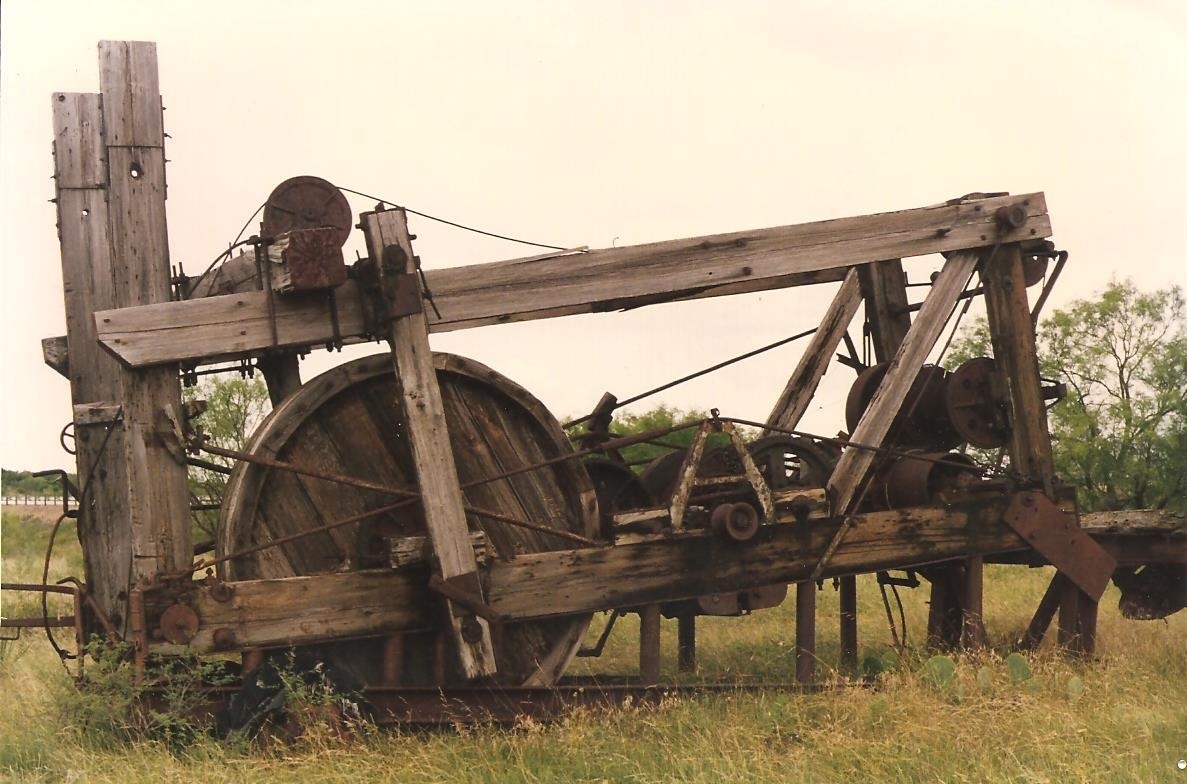

Both methods have pros and cons. For small wells I wouldn't use a spudder if the rotary will work in that area. Rotary with air is pretty clean. Rotary with mud can take a lot of well development to get the mud cleaned out of the formation like with a high speed bailer. High speed bailers need steel casing as it will collapse PVC. Although, if you rinse out the mud before casing and gravel pack rotary works well with PVC casing. Usually don't have much choice as only one way or the other is available in most areas.
Just to throw in a picture, here is the spudder rig my Grandfather abandoned in Texas in the early 1920's.
