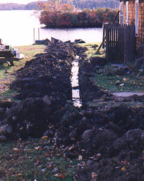

ok here`s some pics not the greatest ones but I just started digging thru the box

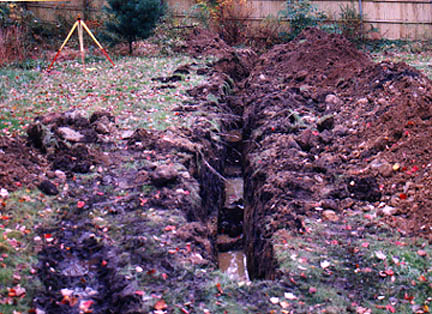

pic number 2 . Jerry as u can see in this photo I have a exceptionally large catch basin at the end of my run....(the lake) /w3tcompact/icons/laugh.gif
