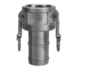

It also has this valve which I'd like to connect a water hose to, does anyone know from the looks of it what adapter I'll need? I plan to call the manufacturer in the next couple of days but thought I'd check here first.

Don't know about the cleanout, but that hose connection is a cam lock hose common in chemical plants. That end will need the cam lock with two "dog ears" that once you slide the hose over it, they'll be perpendicular to it sticking out and you pull them together (parallel to the hose) to lock the hose in place. Most have a ring on each dog ear that you can zip tie around the hose and through the rings to hold in place. Can't tell the size from the picture, but you may have to have a hose made to fit that end then adaptor to a regular garden hose depending on what you are trying to do with it. Maybe you'll luck up and find the right hose already in existence.
