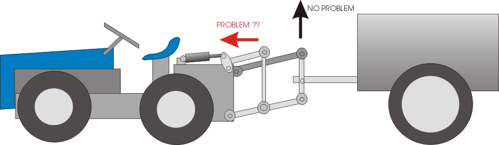

I recently bought a water tank on 2 wheels which will have a filled weight of about 1000 kg (2000 pds?). I want to fill this tank at my house and drive it down to the place the horses are (about 1/4 mile through a dirt road). Since my tractor (nibbi 4WD 20 HP) does not have the 'normal' connection for attaching trailers (with a pin through the hole of the trailer), fixed to the tractor's rear end, I use the 3PH to attach the tank. This is easier to put the tank at it's place too: lift the tank a bit, put a support underneath and lower the tank onto the support and disconnect. And now (finally) my question: Can moving the water tank around affect the fixings and hydraulic piston ? Lifting the tank is no problem since it is quite balanced (and the 3PH can take about 1000pds) but driving it around pushes and pulls the entire 3PH. (You can find a drawing in attachment that might explain what i'm trying to say here) I can alwys make a fixed trailer attachment to the tractor... Any opinions are greatly appreciated.

You should have no problem pulling a trailer on the tph Steven. That will be a lot less load than a disc or box blade which connects to the tph as well. Lots of people use a tph drawbar for pulling trailers instead of the "swinging" drawbar on the tractor frame.
Nice sketch too /w3tcompact/icons/smile.gif

It looks like he has a stabilized 3pt drawbar already.. but was concerned with the motion up and against the 3pt hydraulics.
Personally I think a swinging drawbar would be the best bet.. keeps the load from shifting as much.. water is about 8# per gallon and flows, if the tank isn't full... A quick stop would make the 3pt come up, and could unload the rear end.. might be hard to stop.
Again.. a worst case scenario... I've never personally seen an accident involving a 3pth drawbar towed impliment. .but have heard of them... Havn't heard of a swinging drawbar problem (yet)

The word DOWN the road in your post concerns me. If you will be hauling a full trailer down a hill, you could definitely be in for trouble, as the laod could force the 3ph up as you attempt to ****** the load.
If you are pulling on flatland, the only problem you would encounter would come from a partly filled tank sloshing as you stop, that too could push the lift up.
Simplest solution would be to build yourself a drawbar that had the towing connection point at the right toung height with the 3ph fully up. It wouldn't hurt to rebalance the trailer so there are about 440# of weight on the toung either.

The tractor weight is around 2200 pounds. It is a 4WD with equal wheels. It's not as sturdy as a tractor where only the wheels turn because of the two hinge points. The water tank is about 190 gallons (length of the tank is 6 feet) with the axle in the middle and a tow bar of about 5 feet. This brings the total filled weigth of the trailer to about 2000 pounds. The road is flat, except for the last couple of feet down (not steep) to the meadow. I guess going down is not a problem since the weigth will push down on the tractor, going up is more difficult (the water will flood to the backside of the tank pulling the tow bar up). The 3PH is not yet satbilised from left to right (will do this shortly) but I don't know how to prevent it from going up (hydraulics can lift up but not push down). Greetings from Belgium...

You can rig a check chain from the three point hitch to something lower on the tractor (where the drawbar would go) this will keep the three point from raising up. <A target="_blank" HREF=http://www.agri-supply.com/31-40.pdf> Agri-Supply pdf </A> see sketch on page two of this section of their catalog.
