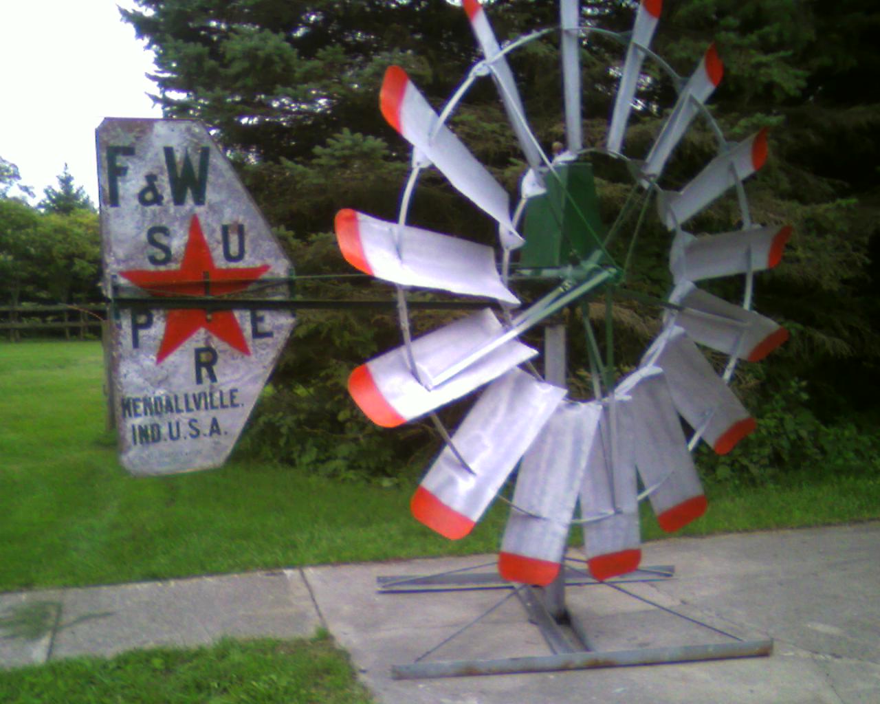

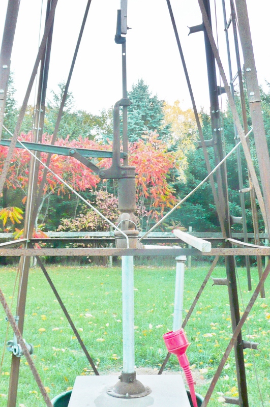

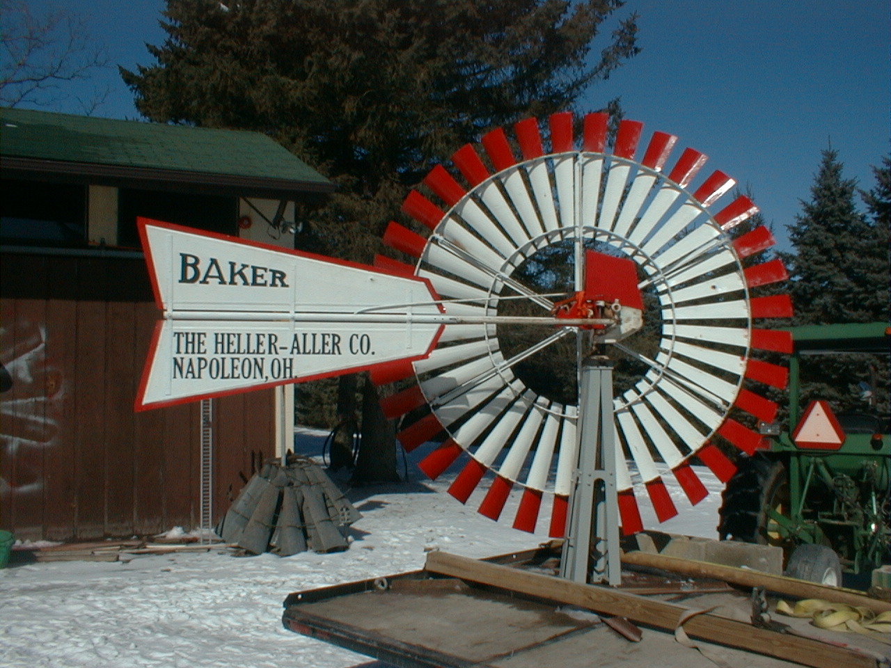

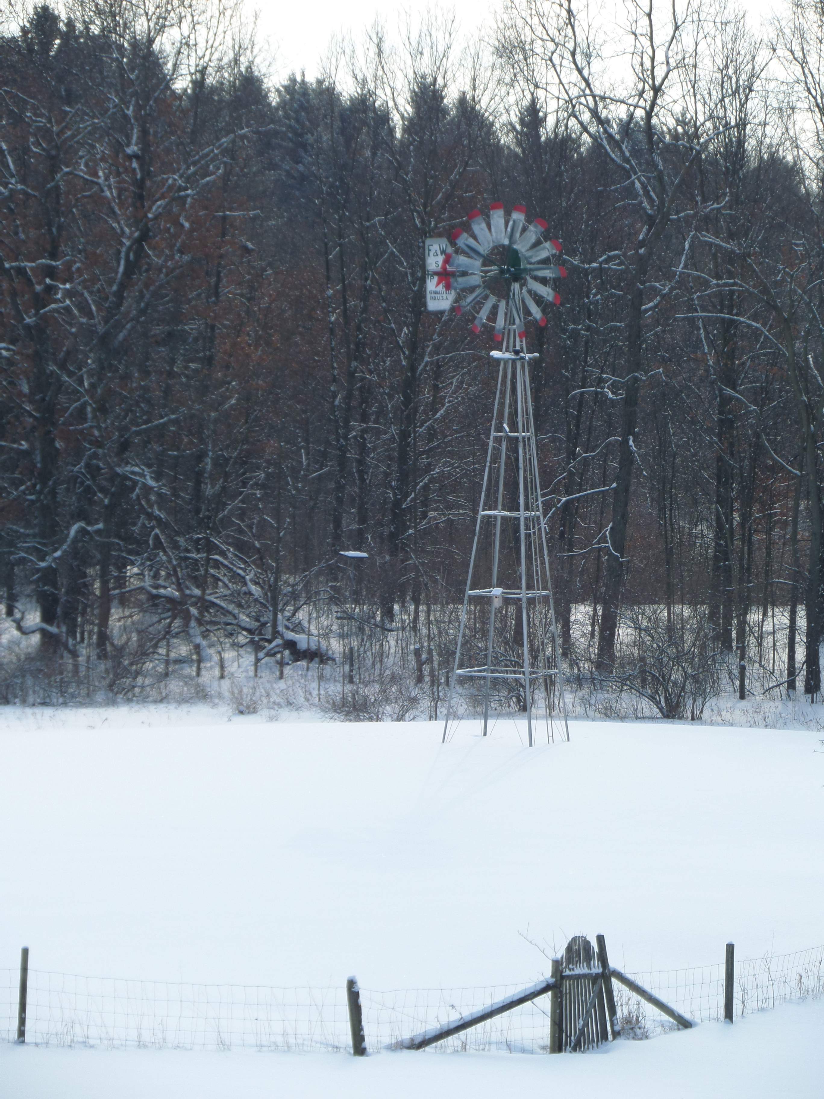

Good luck. Show us some pictures when you have it started. Here are some pics from my collection.
