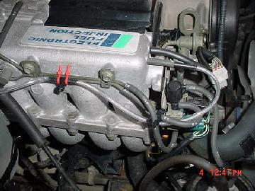

Anyway, I went and installed a water injection unit on my farm car, a 1994 Suzuki Sidekick (not a high compression engine by any means).
I made a really simple and cheap unit. I purchased a quart refrigerator bottle with a screw on lid and a snap spout, and aquarium starter package (air stone, vinyl tubing, 2 needle valves and 2 tees). Total cost: $4.00 I also purchased a gallon of distilled water and a pint of 99% isopropyl alcohol. The alcohol keeps the water from freezing here in Michigan (it's winter).
I teed the feed line into a ported vacuum line running into the plenum that feeds the intake runners for the fuel injection unit. I regulate the water feed with a needle valve. I consume about 1/2 pint of water mixture a week.

   / WATER INJECTION??
This is the second photo:
This shows the hose routing as well as where I teed into a vacuum port on the fuel injection plenum.
   / WATER INJECTION??
This is the third photo:
Another view of the hose routing. I used the ported vacuum that purges the charcoal cannister via a vacuum operated valve. I teed in right above the valve with a short length of vacuum hose.
I used clear tubing on the hose routing from the bottle to the vacuum port so I could see the water flow so I didn't have too much or too little.
