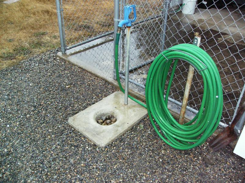

   / WATER HYDRANT ADVICE !!!!!!!! #10
I did a concrete base on mine like so.
