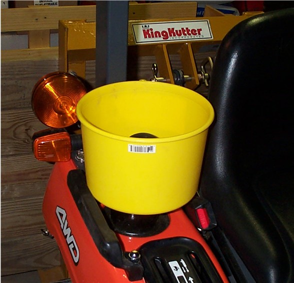

AK, I have user a Mr Funnel for many years and they work as advertised. I tested mine mixing a a cup of water with a quart of diesel and pouring it through the funnel. As far as I can tell it trapped all of the water. I let the filtered fuel set in a clear plastic jar for a week and there was no sign of water.
John
