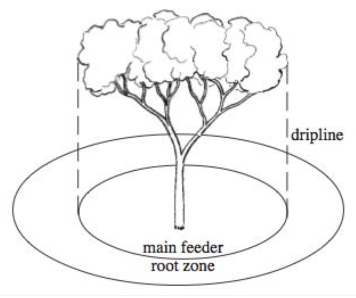

   / Water distribution to a bunch of newish fruit trees? #7
I planted a 9 tree apple orchard two years ago and I went low tech. I picked up 3 five gallon buckets per tree, and drilled a 1/16" hole in the bottom near the outer edge of the bucket. I place the 3 buckets around each tree so the hole is closest to the trunk and fill them up.
I do the same with the buckets. I was ready to give up on my fruit trees until I started watering and fertilizing the drip lines. Game changer for me.
