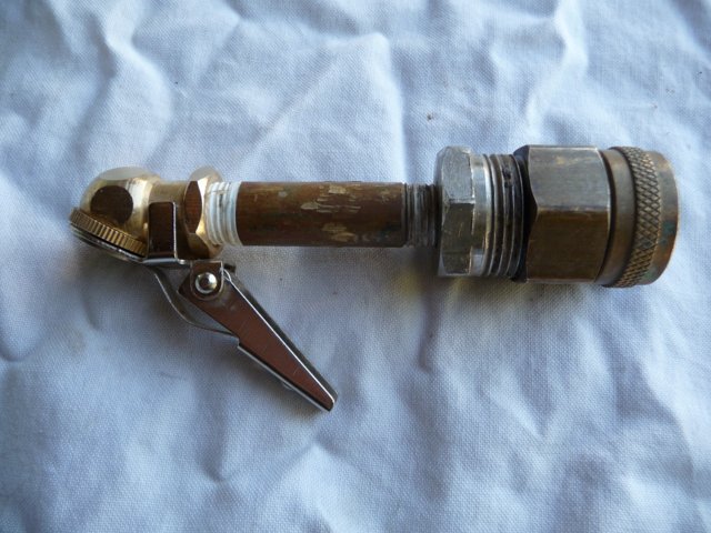

I would like to try this to see if it helps with sideslope tilt, and also just a fraction more weight over the rear. what have you found to be the easiest way to fill the rear tyres with water? i thought maybe deflating, lay them on the ground with a hose from a 20 odd litre container and allow it to gravity feed. would this work? suggestions anyone?

Or make one if you already have the components.
I'm assuming you live in a climate (Australia) where you don't need freeze protection, or else or can park within shelter.

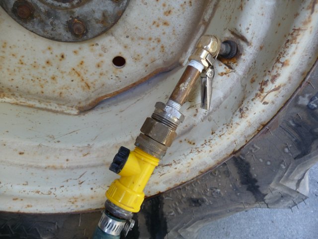

Jack the weight off the tire, remove the valve core, and your garden hose pressure will fill the tire. Halt occasionally to bleed off air.
Note this homemade tool has the pin removed which pushes down on the (absent) valve core. No water would come out, if the pin were still installed.
Finish with the valve at 12:00 position (top) and leave airspace above that so the tire can still have some resiliency. Replace the valve core and air up to the minimum specified for that size tire.
If you always check tire pressure with the valve at the top, you can bleed a little air to clear the valve so you won't run water into your tire gauge.

Correct assumption California,no anti-freeze required here.Funny you show a picture of that style of valve fitting as i have one of that exact one. so just remove the stem pin, fit a water fitting on it and away i go? i will try this during the week and see how i go.
