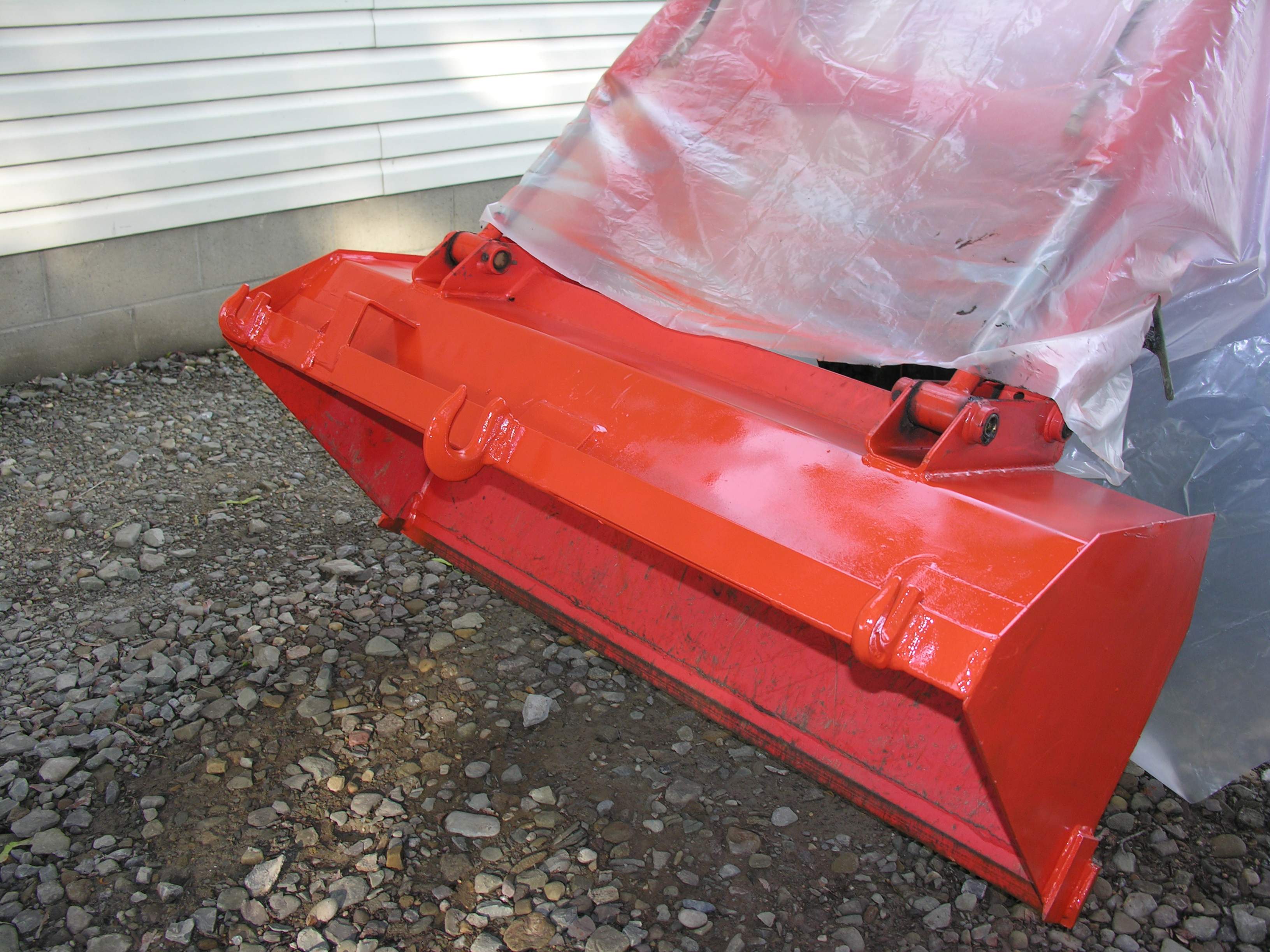

I have never heard of bucket hooks voiding a warranty, but that doesn't mean it has not happened. As far as lifting w/o hooks, I don't recommend it. I reinforced the top edge of the bucket with 3/8" X 2" angle and used 3/8" plate to reinforce the bucket directly below where the hook is welded on. The hooks have become my most used attachment and I have not had any problems or distortion of the bucket.

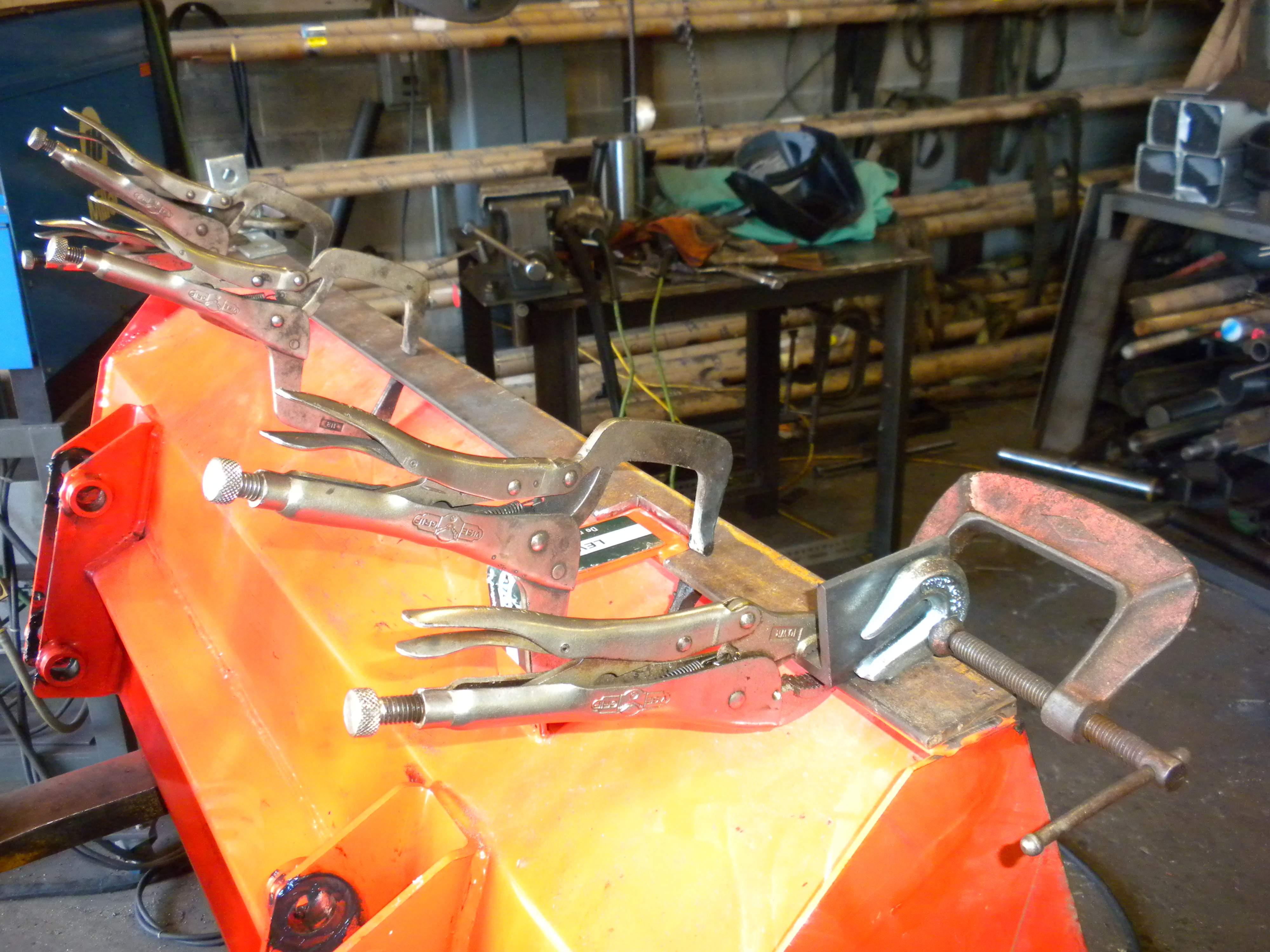

I personally have welded on many hooks to loader buckets while working at the dealer, Kubota and New Holland. It does not void the warranty, but I don't expect you to come back wanting a new bucket when you bend it picking up something too heavy or the wrong way, either. I'm sure there have been cases where this has happened, so I can see how a dealers policy could become not to weld them on, or to tell you the warranty is void.

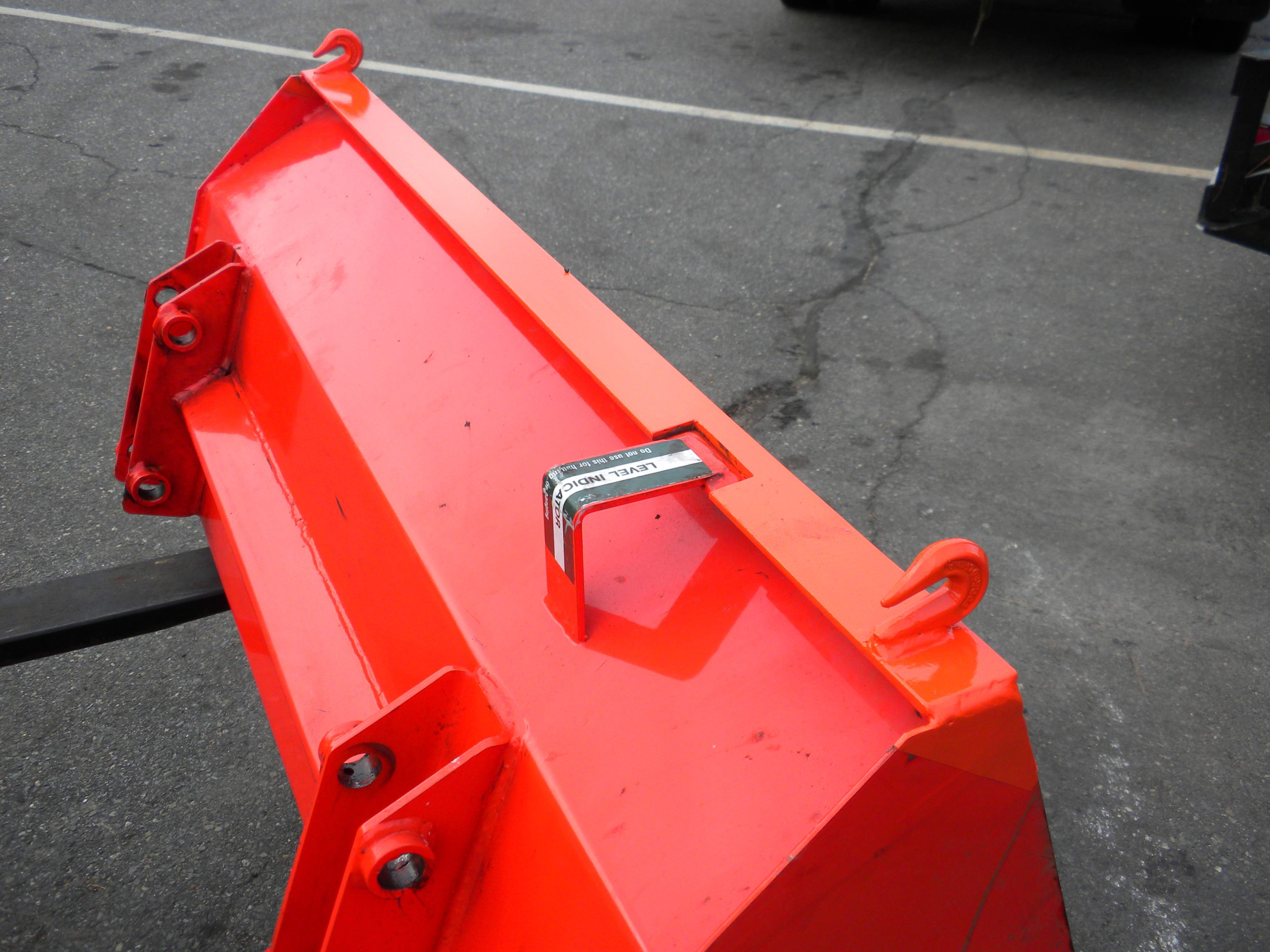

Hopefully I haven't voided mine......but they sure work great.......:p
