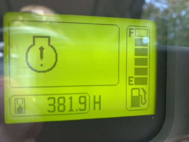

Many moons ago when Cabelas decided to get out of the tractor business I purchased the LM55H model which is made by TYM and I believe is equivalent to the TYM T554. It has 380ish hours and I routinely take it in for PM on the recommended hours. Hopped in the cab yesterday, fired it up and received a warning light that looks like this. Can’t find a reference to this particular warning. I assumed it was low hydro oil so I checked and sure enough it was low so I topped it off, but the hasn’t gone away. Checked oil, radiator fluids and both are fine so I am a bit miffed about what is going on here. Ideas?

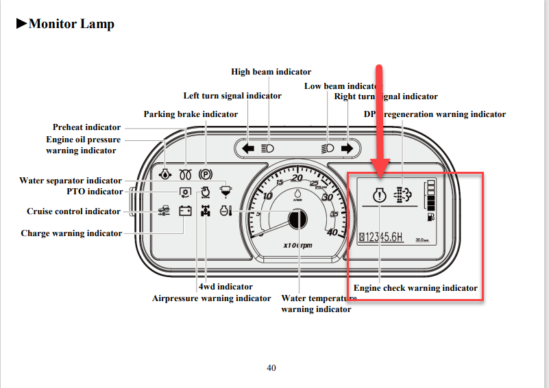

That is low oil pressure. It is in the manual.

I saw the low oil pressure symbol in the manual, but to me it does not look like this symbol. The low oil pressure light looks like a beaker with a drop of oil in it while the symbol I am getting looks like a beaker with "+" sign and an arrow pointing up like I need to add fluid somewhere. Maybe I am putting too much into analyzing the symbol. Could be one and the same and the manual image just isn't that great.

Page 40 of the manual - Engine check warning indicator.

Thanks for the reply. Are you referring to page 40 of the T554 Manual from post #3 above? I see universal symbols on page 40, but I am not seeing the symbol I posted a picture of. Any way you can send me a screenshot?

Thanks Randy. Unfortunately that is not the same symbol I am getting. That symbol is an exclamation point. Mine is a "+" sign with an up arrow. Another member responded to me that he believes it is low oil indicator, and the dipstick on this model reads high, so just add oil and it should resolve the issue.

Or maybe the display cannot render a perfect exclamation mark using little square boxes? Looking at the two screen shots, it appears that the symbol on the dash photo is in same relative position as the "drawing" from the manual, which is obviously not to scale. All that is missing is the "Regen" symbol.
