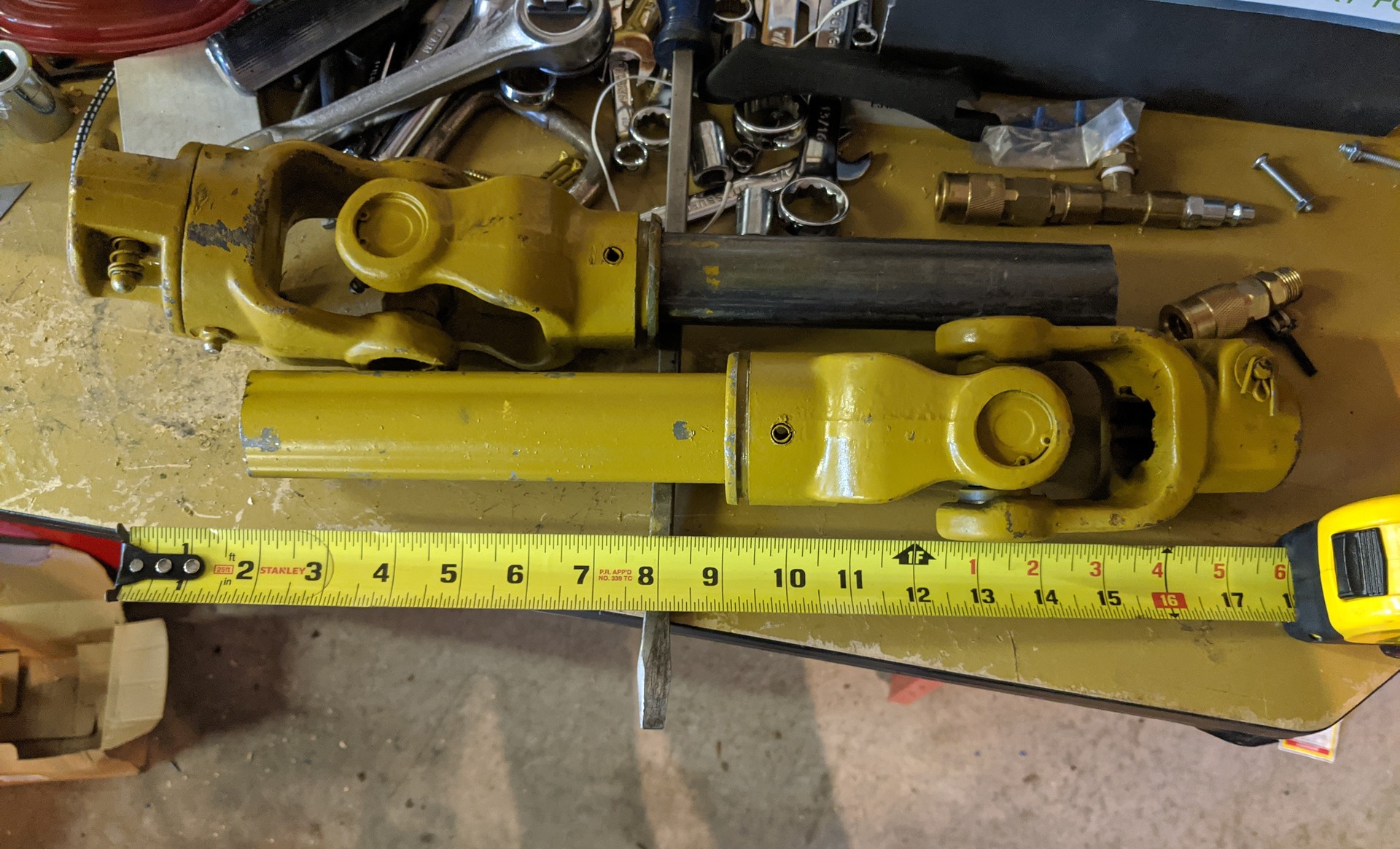

Welp, I got all ready to hook up my RSB1301 tiller and till the new garden and realized there's no way I could shorten my spare cat4 shaft enough. It would leave about an inch of shaft between the yokes! So I'm putting out a call for anyone who knows where an OEM one might be available for purchase (I've exhausted the usual suspects of Fredericks, Hoye, and Ernie). It's a 6-spine both ends, about 17" pin-to-pin. Thanks all.

You say "an inch between the yokes" and then you say "about 17" pin-to-pin". When you shorten a pto shaft, are you only cutting the outer or inner tube? You should cut both so you keep as much overlap as you can.

I cut both equally. Here's what I mean by the measurement - from the tractor PTO lock pin to the lock pin of the tiller is about 17". The yokes take up 16" of that :)

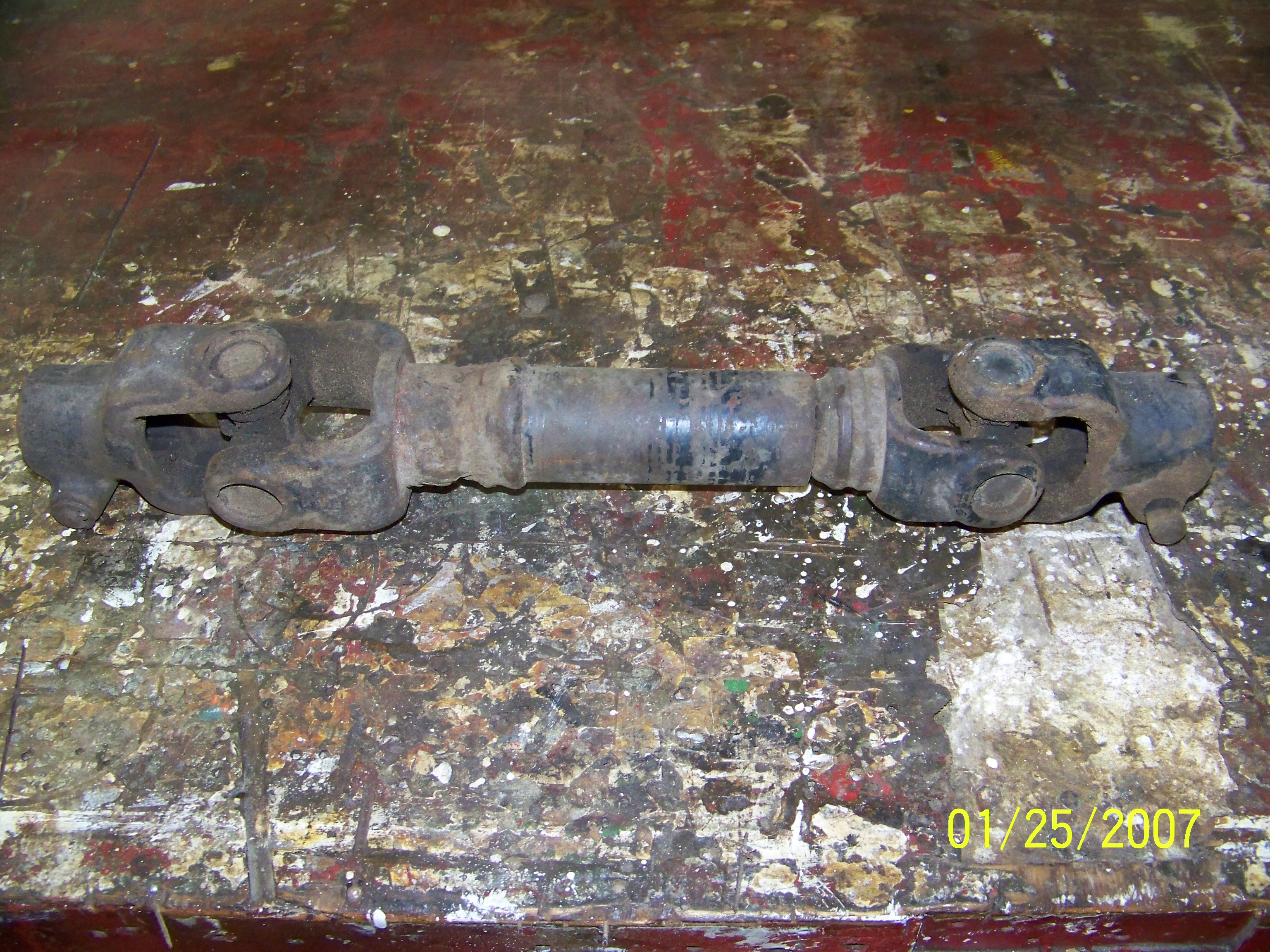

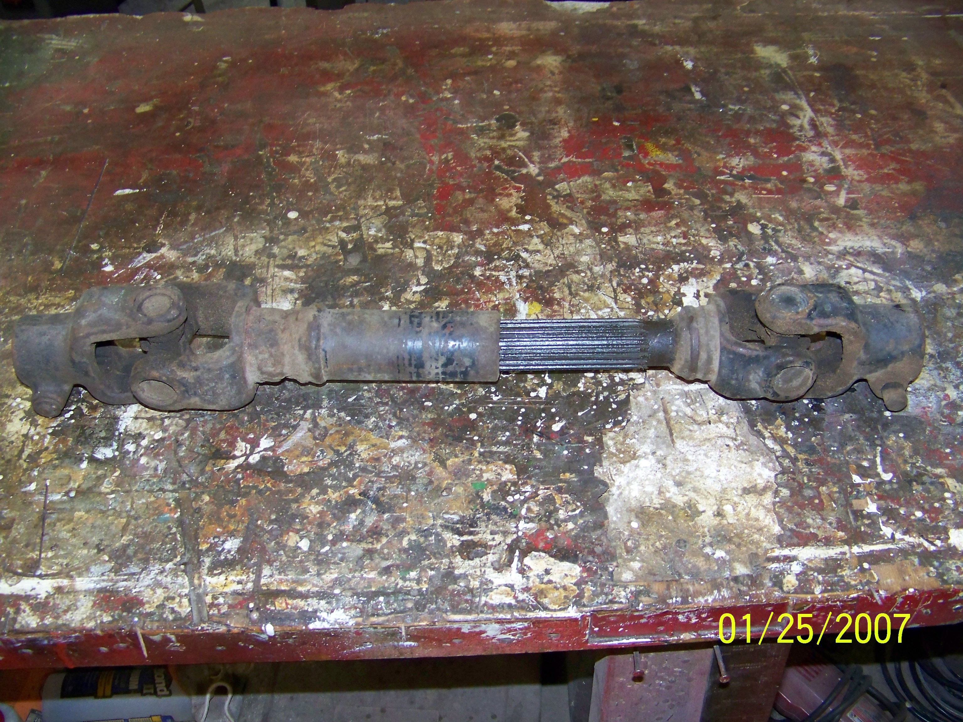

I have one I used on my old 2002D and 1301 tiller before I modified my tiller for a longer shaft use. It has been welded on and modified. All the way together it measures 17-1/4 center to center of pins, about 21-1/2 when just a tad together. No reason it could not be cut off another 1/2" or so if needed. If you are pretty confident it would work for you I will ship it to you for shipping cost. If interested pm me with your details .
