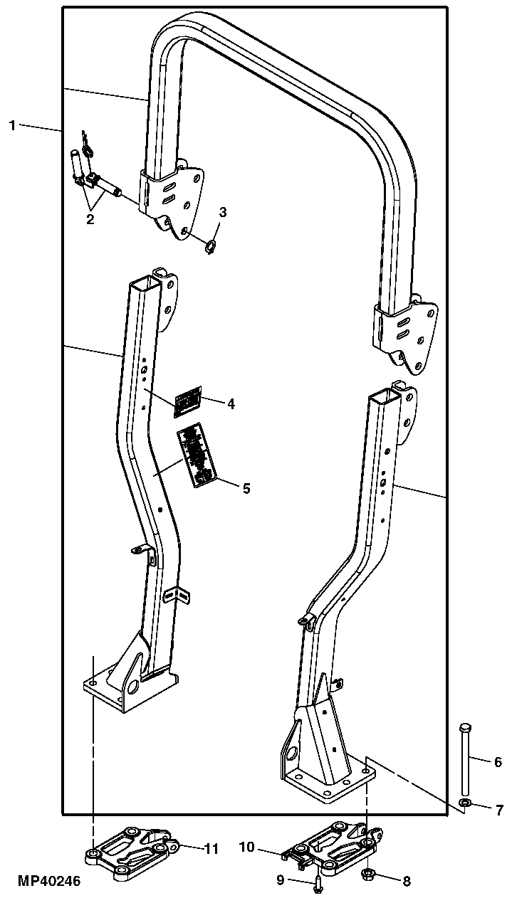

Just bought a 2008 John Deere 4105 , the only thing I do NOT like , is the roll bar does NOT fold :mad:. Can I modify mine , or do newer 4105s have folding roll bars ? I saw a pic of a 2009 and it had a folding bar ? Going to call dealer to see if I can order a folding bar . It would fit in my garage IF the rollbar would fold .

I do believe you are SOL for the folding ROPS.
Can you modify yours? Well, anything can be modified. But you're on your own there...

The one JDParts shows say it's for the Australian market, but may be available here as well.

If it were me I would modify it to fold. Obviously you need to know how to do this safely. Bear in mind that this will release Deere from the liability if it fails, so make sure it is done right for safety's sake. It isn't rocket science.
A good welding shop should be able to do this easily enough.

Check Femco for an aftermarket. Also, check to see if other tractors have same size/holes/mounts. The 2305 doesn't (or didn't) list a folding ROPS, but the next size up did, and they are interchangeable.
