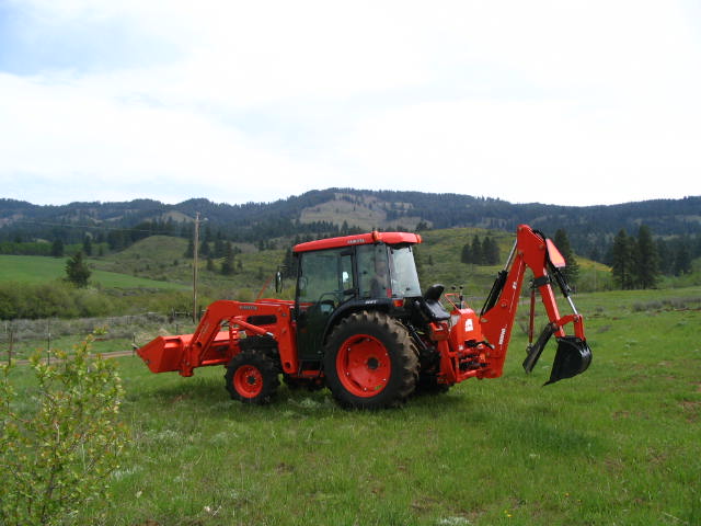

Yes, you can have a 50hp Cab tractor from Kubota with a backhoe.

Art hit it - even if you buy the tractor pictured (nice machine, by the way), it will be a royal PITA to operate!
Let's say you are getting ready to dig and as you start, the ground is tougher than you thought and you want more power. Oops, climb down over the outriggers, go around into the cab, adjust the rpms, get out walk around and climb up over the outriggers. I am not a badge holding member of the safety police, but I would think that in the 2-300 times you do the dance every 8hrs of operation, there is a good chance you will grab a BH lever and move a large powerful chunk of heavy metal. It could be bad if you are climbing up, start to slip off, grab the swing control and crush yourself with the boom.
For the price of that rig, get a 10 - 15 year old Case 580 and a 10 year old dedicated mower / ag tractor. Hey, Builder! Whadda you think about that?
