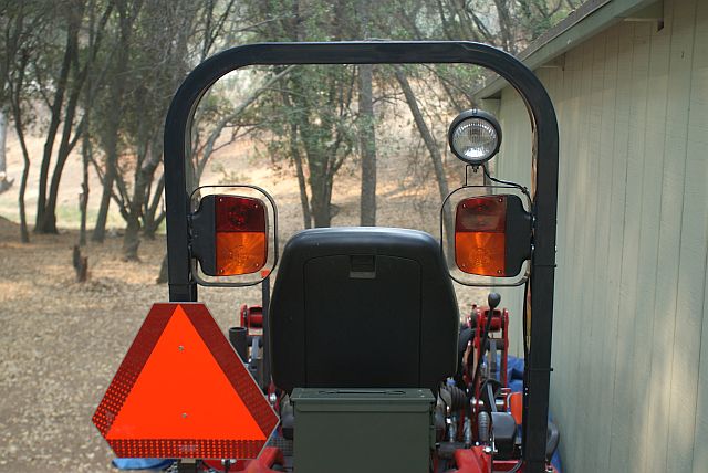

Want to save $127 by not having to replace tail light assembly on your GC 1705 or GC 1715 series SCUT (don't think its practical if you have 1710 or 1720 with backhoe)..
Simple remove lights from factory location and swap them side to side and use a couple washers under guard to keep from pinching wires at base of lamp assembly. Use plastic wire ties to secure wires to ROPS instead of trying to drill new holes and fish wires through ROPS assembly.... Factory guard don't do anything when you have contact with anything more than the lightest of branches...
