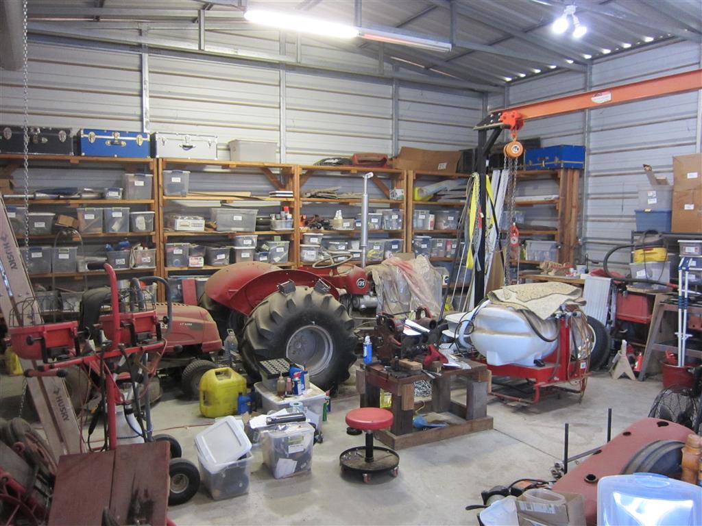

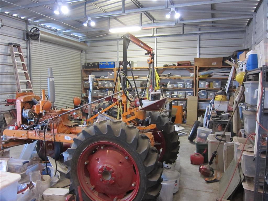

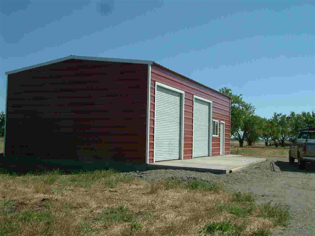

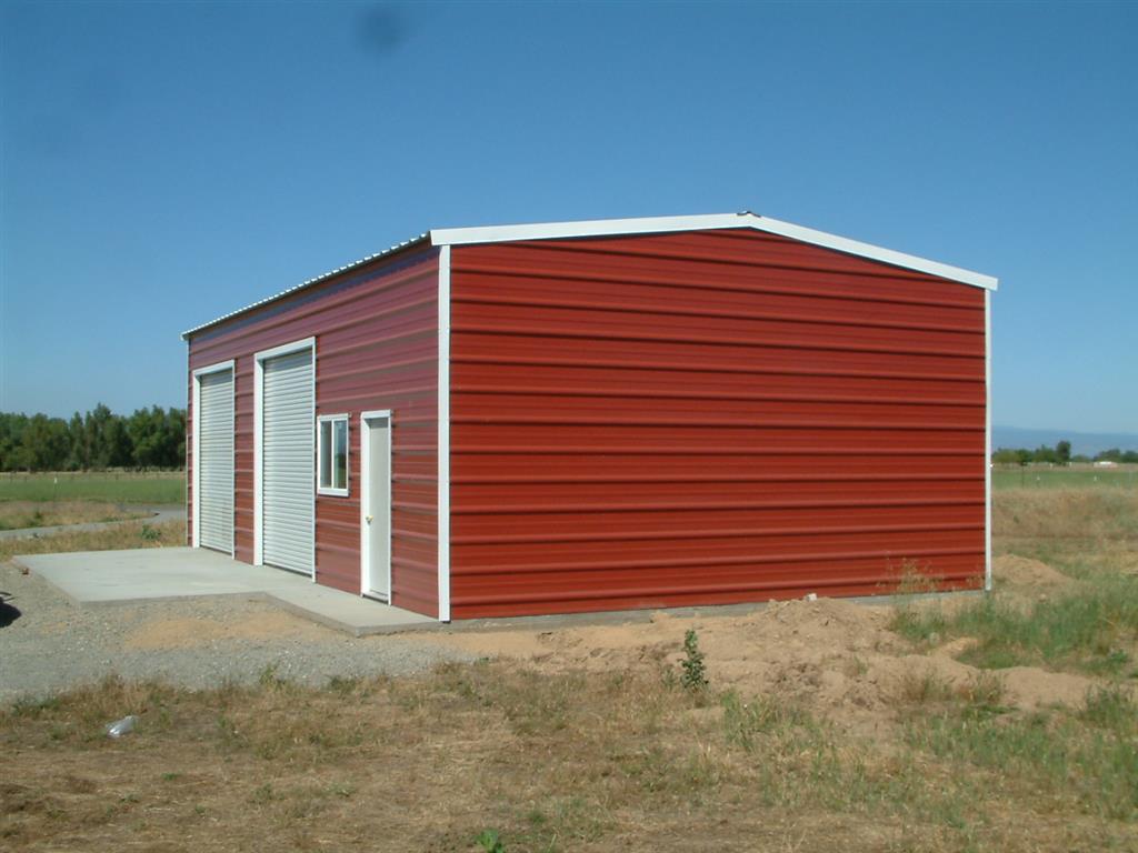

My 24x42 ft steel shop building cost $16K when I had it built in 2005. Includes two 10x10 ft roll up doors, 1 man door, one window, 12 ft tall walls.
Concrete floor (6" thick, #4 rebar on 24" x 24" grid, 4000 psi concrete) and outside concrete apron cost $6K.
Good luck

Flusher, it looks like you've got several projects going at the same time. what is the old tractor?
   / Want to put up a shop.. #7
That's a 1951 Minneapolis Moline BF wide front high crop tractor. That photo was taken a few years ago. The restoration was pretty much completed late last year. That tractor along with all my other tractors were sold last December while my place was in escrow. Sale was completed in mid-Jan this year and I moved back to the city.
View attachment 419310View attachment 419311View attachment 419312View attachment 419313
Good luck
That is a nice building, but it looks like you should have built it 84 feet long instead of 42! I know my barn should have been at least 50% bigger, but at the time it was already 4X bigger than the old one!
