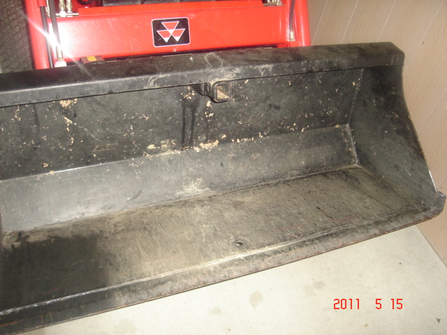

I'd like to move a utility trailer short distances without having to take the BH off. Is there a good way to temporarily attach a ball to the BH or front loader bucket? Maybe a clamp with a stem and ball attached?
   / Want to move a trailer with BH on; GC2410 #2
I've seen this done in two primary ways. Either drill a hole through the center of the bucket about an inch in from the edge and put a ball in it, or mount a two inch receiver to the top edge of the bucket where you can uncurl the bucket and use a hitch in the receiver.
I don't consider either option to be great, but they do work. A better option, IMO, would be to modify a hitch so that it clamped onto the bucket cutting edge. I would still drill the bucket so that a bolt could go through the bucket to secure the clamp without risk of it coming loose/off while moving the trailer.
Keep us posted on what you end up doing and how it works.:thumbsup:

I put both on my FEL; sometimes it's handier to have a low-mounted ball, sometimes higher up. If you look closely, you'll see the hole I drilled in the bottom of the bucket....
But I remember seeing a very clever trailer-hitch set-up for the backhoe bucket. I placed it on my "Things to do in the future" list!

If you really want temporary, attach the draw bar from a trailer hitch to your bucket with a large "C" clamp.
I have done this to move a good sized trailer I borrowed, and it worked fine.

Simply using a C clamp with the FEL bucket and relaying on friction to hold it under the mild drawing force I expect sounds like it might work, though the posts mentioning bucket flex concern me.
:confused: How much force do you think it takes to move a utility trailer? Unless its unusual circumstances, not much.
If you clamp the draw bar to the cutting edge, which is where it is thickest, it's not going to be a problem, as I said, I have done it.
Assuming your trailer is in good condition, your land is navigable, and not going to drive like a manic, I can assure you there will be no damage.

Pulling a trailer with the back hoe is not a good idea. Unless it is really light and what ever you put in it is very light, you could bend or break a very expensive part. :2cents:
It is very easy to drill or burn a hole in you FEL front lip. Other than the cost of the ball it is very cheap. :)
With just a little practice you will find it easy to push the trailer and that will let you get in and out of very tight spaces. With the ball in the bucket, I move my 18' around, have a good sized roller that I almost always push. Same with my cement mixer. I have moved Mobile homes up to about 40+' and travel type trailers.
