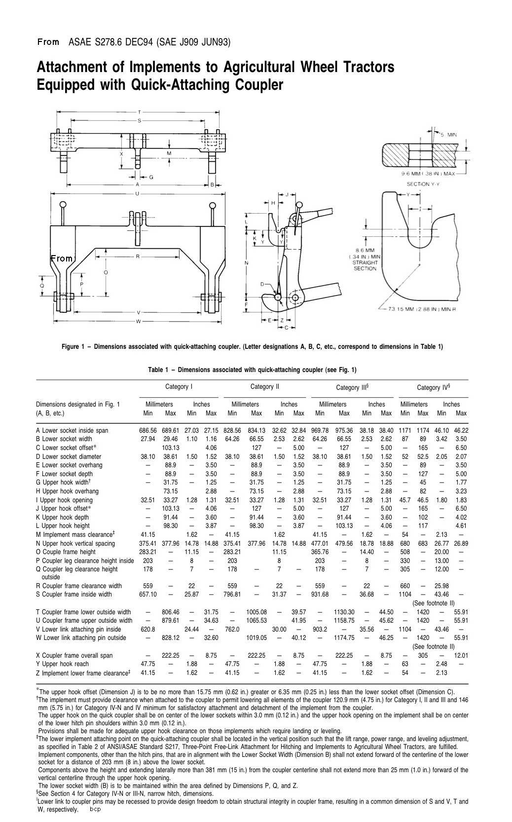

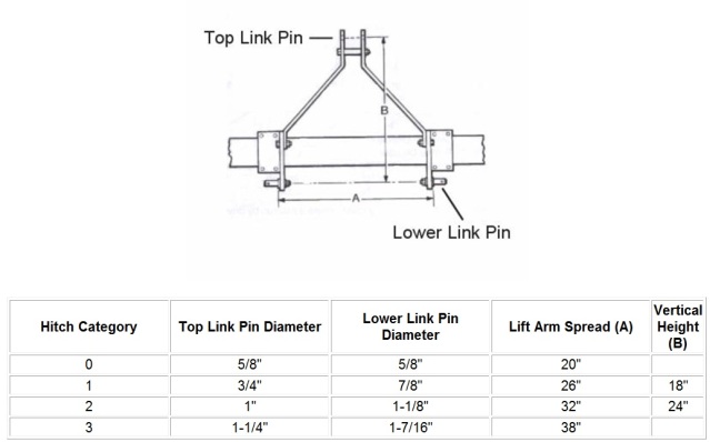

:anyone:Has anyone modified their 3pt tiller to work with a I-Match Cat II Quick Hitch? I am looking at a Maschio B230 93" tiller and the dealer wants 7 hundred for the modification. What else is there besides adding/extending the bottom pins to the outside of the lower lift/control arms. The third link bracket looks like it has clearance and adjustability. I also run a hydraulic third link.
UPDATE! The JD Frontier RT22 93" is I-Match (made by Maschio), but is $600 more which is probably the cost of the green paint and badging. Maschio Part # M99500633 for $400 will convert the tiller to I-Match. I would like to know what this part/kit looks like, but Maschio Dealer will not show me unless I purchase the Tiller.

These are the industry standard dimensions you're looking at for the different categories:
