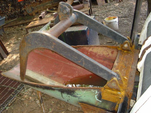

I built this from a 24'' tube I found at the scrap yard, arms came from a damaged bradco grapple bucket. Blank attachment plate from richie brothers auction.
