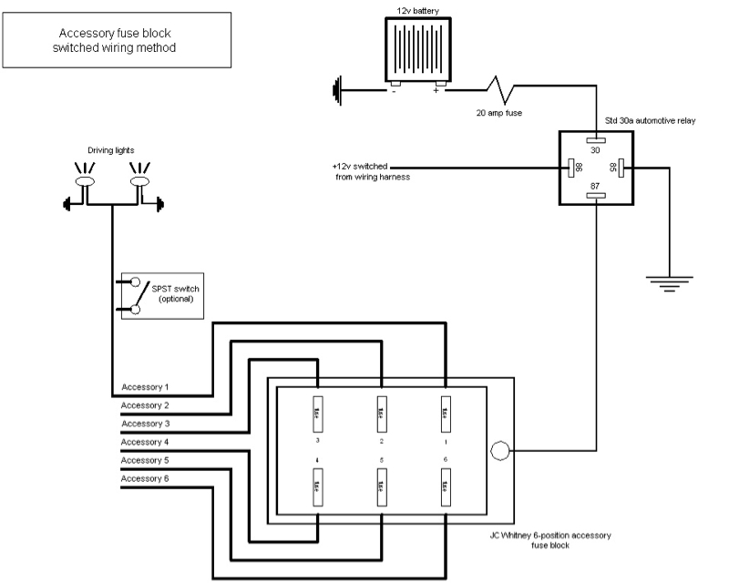

Planning on add aux fuse box to run some LEDs and maybe a couple other accessories.
Here what I'm thinking I want do use in line fuse to 30amp relay to power fuse box, hook in keyed switch so the box only has power with key on.
Is this the proper way to do this or am I missing something. Also does it matter where I mount the relay- near to batty or can I go ahead on mount by the new box.
Any thoughts on this good or bad please respond.

I would have "two" relays, one for each feed of "three fuses",( top three and bottom three) your key switch can turn both on.
One relay won't handle all that power if you decided to use 4 to 5 fused accessories at once.
I would also upgrade your 20 amp fuse to at least 40 or 60.
I'm assuming your fuse box will have 15 amp fuses in it.
Mount your relays near the fuse box. IMO

Have you thought about using a "resettable" circuit breaker instead of fuse or fusible link? If you do overload, you don't have to replace anything. I use them all the time with great success.

So i should run wires as pictured above just double it and add larger fuse able link on each run?

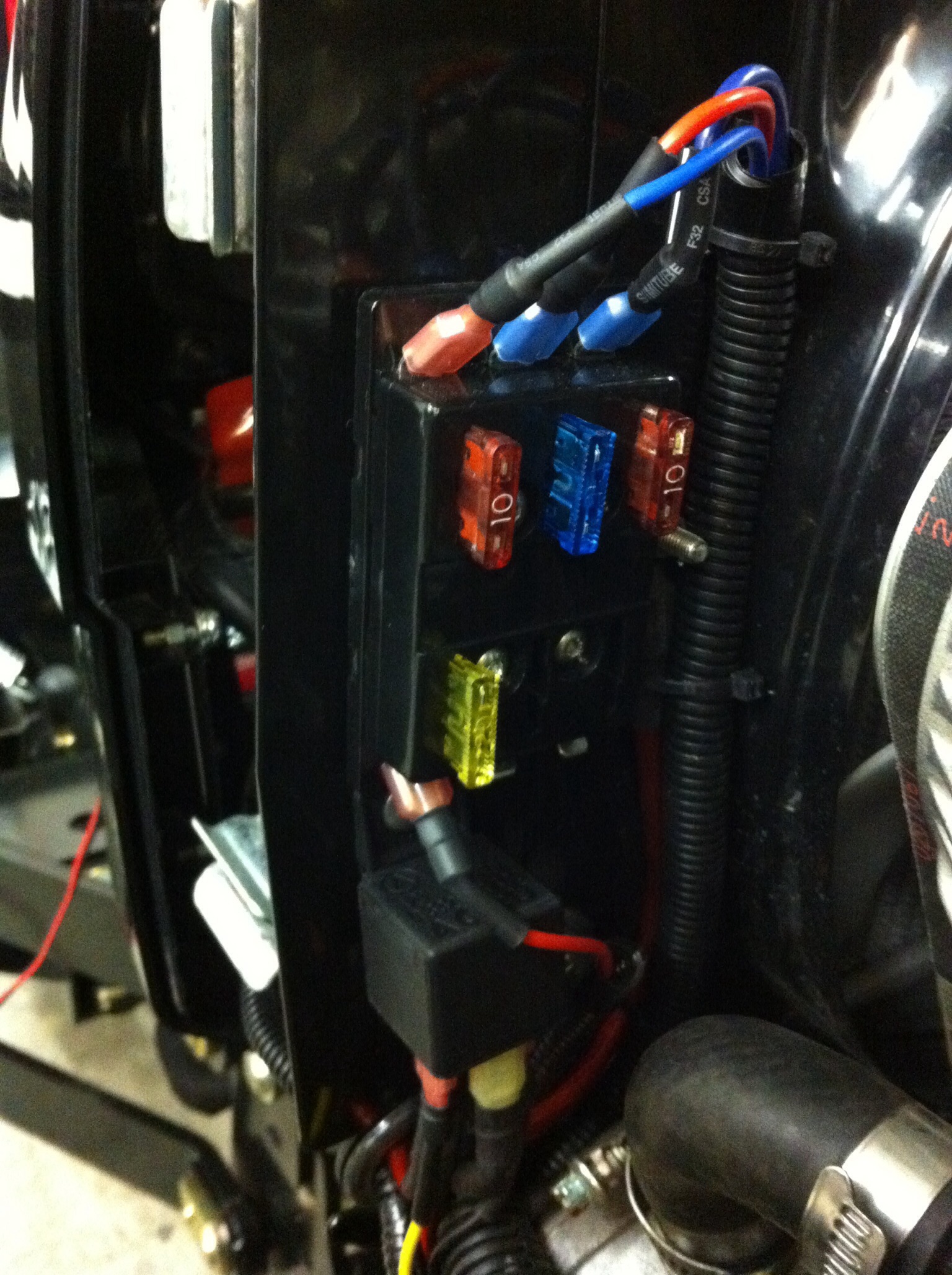

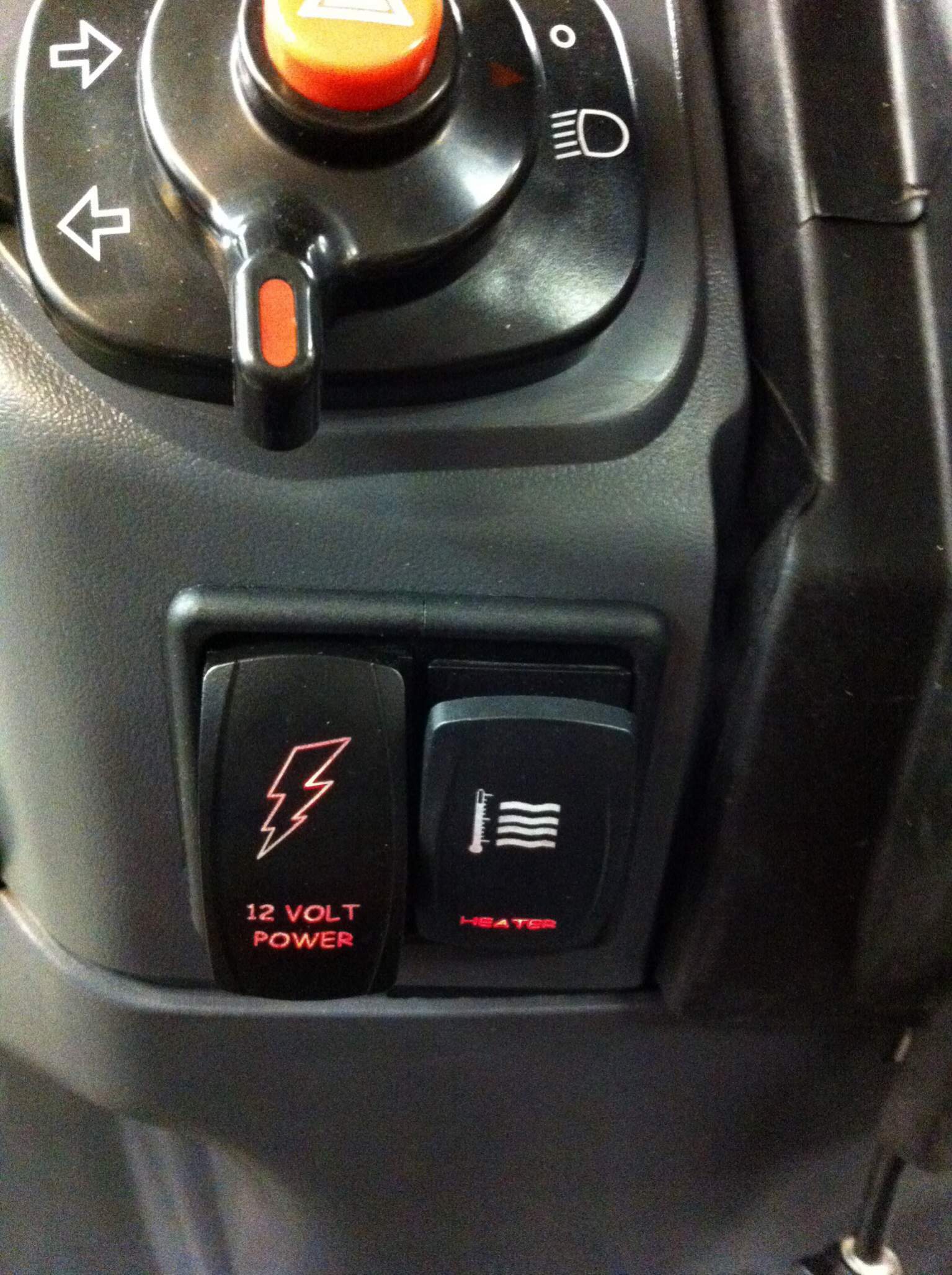

Here is a picture that's close to what you are wanting to do... I used a 12v switch instead of using an aux feed for my relay. I do not have an accessory position on my key switch and some things are nice to have without the tractor running, your choice. Just put the fusible link between the battery positive (within twelve inches)and relay and your good. My relay is a 40a with a 40a fusible link. I would use two relays and links if you draw more power from your new fuse panel.
Nope, not needed on "each run" just one fuse, just like you have it, but larger,
I personally don't like fusible links, there hard to see when they blow, and you have to re-wire new one's in. Thats what I would do.
You can get large 40 or 60 amp fuses just like the little ones.
BlackMax doesn't have as many fuses as you have, something to think about.;)

So just upgrade to 40 or 60 amp fuse and relay and should be good to go? Sorry for all the questions but I want to make sure I do it right and not damage anything.
