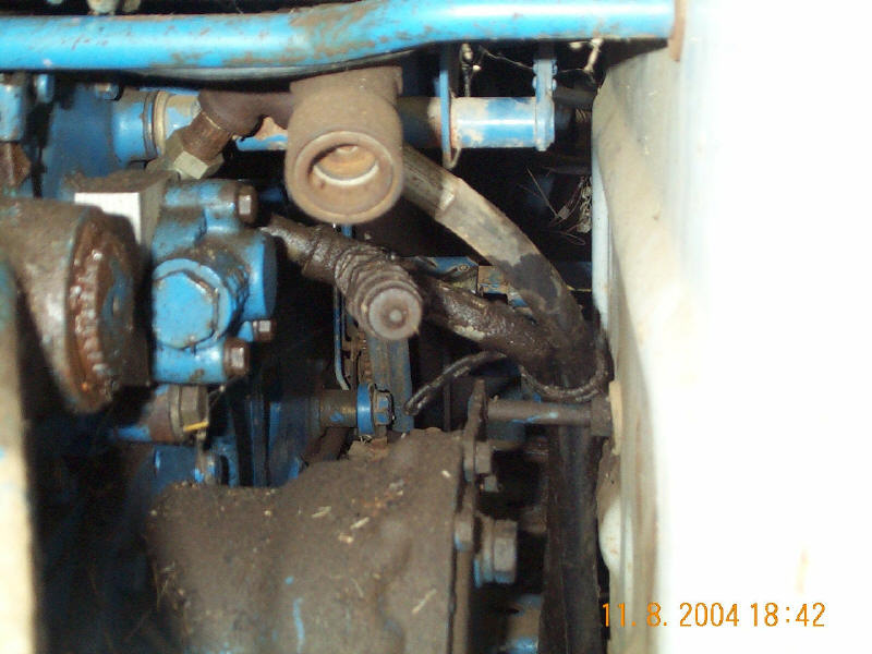

where do i get one of these blocks to screw hydrualic lines into like the aluminum one in this picture?
i need to get one or make one so that i can install the lines to run my 702 blade on either my ford 1500 or ford 1700 tractor.
thanks,
jeff

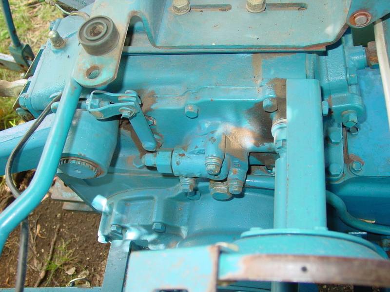

   / want to add a hydraulic dozer blade
#2
it looks like it goes underneath this part.
   / want to add a hydraulic dozer blade #3
run a search on power beyond;) from what I remember, there are a few pics that show the plate in detail... enough detail for a diy:D

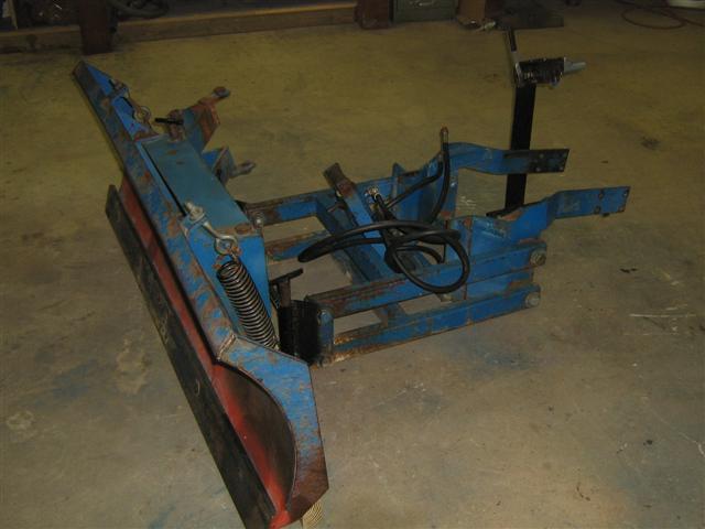

no, its a 702 blade made for the 1500-1600-1700 tractors. bolts on the frame using some of the engine bolts and on the front below the hood hinges. i can't find this power beyond website. do you have a link?

here is a picture

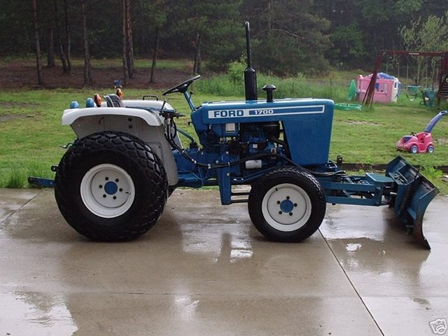

   / want to add a hydraulic dozer blade #8
the one in your second pic uses the same connection points (FEL attachment)as the NH full frame backhoe on my 1720. Wouldn't hurt to run some extra steel to those points if yours doesnt IMO.. that's a great attachment btw
#9
so did you make your own block? did you have an insert on the backside for the orings to go into
   / want to add a hydraulic dozer blade #10
never got around to it.. I've been happy running the hoe off the rear remote.
Yes, you will defenitely need the oring grooves machined into the plate.
