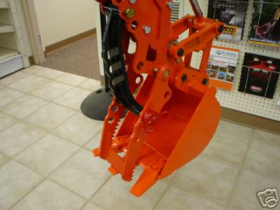

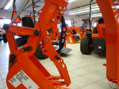

I saw a Wallenstein thumb for the BX series backhoes on Ebay, and I was wondering if anyone has actually seen, or used one?

I've not seen one but from the pics they look pretty stout.
How do they price out?
I have a Bro Tek thumb on my BH and it is one of the handiest implements I own.
/ Wallenstein thumb for BX?? #3
Wow, that looks cool. It's a little more expensive ($400 vs. $280) than the BroTek unit, but that thing is a work of art!
I'm all about the BroTek stuff as it seems to really "fit the bill", work well, and be a good accessory answer to some of the issues we have with our BX tractors (skid plates).
But I have to say...wow. You have to look at it on e-bay to really appreciate how cool it looks. And the tightly serrated teeth look like they'd have real 'bite'. Just search "Wallenstein Thumb".
Once I buy my BH, this will probably be on my doorstep before I get my tractor back from the install. I'll let you know what I think.
Thanks Mr. Chuck in New Hampshire.

$395 plus $25for shipping.
Details:
  • Easy installation - Bolts on
    [*]3 position mechanical adjust
    [*]Move logs rocks and debris with ease
    [*]Painted Kubota Orange
    [*]Serrated teeth for gripping
    [*]Much heavier than the Bro-Tek Thumb( guess they know who the competition is:D )
Shipping:
  • Flate Rate $25.00 freight shipping to lower 48 states
eBay: Wallenstein Thumb fits Kubota BX22 BX23 BX24 Brand New! (item 140105917786 end time Apr-16-07 07:35:32 PDT)http://cgi.ebay.com/Wallenstein-Thu...ryZ26199QQssPageNameZWDVWQQrdZ1QQcmdZViewItem

Well, I saw that thing a few days ago. I went ahead and ordered one. The only reason I did was that the Brotek unit needs to use your 3PH top link and this doesn't and it looks a bit heavier construction-wise. Add the cost of a generic top link and the 45+35 vs. 25 (for equivalent shipping time) and the two are not that far apart price wise.
I will report back once I've mounted it and used it a while.
/ Wallenstein thumb for BX?? #6
I was going to ask Mr. Volfandt if he could compress the BH on his thumb with full pressure of the BH bucket with no risk of bending, deformation, or "folding" of the thumb itself.
Now that you're beating me to the punch Mr. Montelatici, I'd be interested in the same from your nifty looking unit...looks heavy duty enough, but the gripping surfaces are pretty far apart. Picking up a rock can exert some crazy forces on the thing and the BroTek unit looks a little more stout in this regard with the narrower grip.
Just wondering if either one was more prone to deformation than the other. No matter how cool it looks, it doesn't matter when it is crumbled up like foil on my shop floor. But if they both stand up to any forces the BH can exert, this Wallenstein thing looks pretty mean.
Who you call'n Mr? I still work for a living :D :D
I've never tried to really compress the BH bucket against the thumb but I have "snugged" it up and didnt notice any bending or creaking etc. I generally compress as needed, no more or less. I tend to avoid over stressing anything, I guess it's the nature of the beast (me). I'd say the bypass will kick in before anything breaks but thats just an uneducated guess.
I like the looks of that Wallenstein thumb and if it folds up within itself then thats a plus too.
Bottom line is, I can't stress how handy a thumb has worked out for me. Like I pointed out in another thead being a one man operation, doing tasks such as lifting trees and limbs up to easy cutting height more than justifies a thumb. Imagine being more productive in a given day and not having your back hurt that night, doesn't take but one usage to know that this is a good thing :D

Could you guys that have them please post up pics of the Wallenstein?
I have procrastinated for over a year to get my own built so I am always looking for ideas to improve the design.

I bought the thumb from ebay on 04/11/07 and recieved it via UPS 04/17/07...fast shipping. I have not installed it yet, but unpacked it. Looks like a quality piece.
/ Wallenstein thumb for BX?? #20
I just purchased my tractor (see signature line below) with the BH75 backhoe and this nifty Wallenstein Thumb (it fits this hoe very nicely). My main concern is that, though it appears to be fairly beefy, it might bend a bit with use. If it does, then the holes it uses to fix the thumb at various angles (including the ones used to tuck it up tightly against the dipperstick) may not line up well enough to get the pin inserted (time will tell). I suppose a good file will help to alleviate this if it becomes a problem.
I'm considering the possibility of adding a strengthening rib to it provided I can figure out how to do it without impacting its functionality. I can say this though - it really is a nice looking unit (which is why I bought it).
