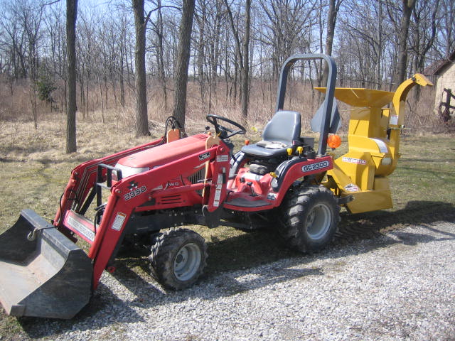

I have a BXM32. Same chipping rotor as the BX32 but with a shredder added. The tractor has no problems with the chipper, shredder use will slow the engine with bigger willow branches. The PTO has to be feathered to engage, or it will stall. A longer top link pin was required, and removed 1" from the PTO shaft (bottoming out when fully raised). Only used it for a couple hours so far. The GC has no problems handling the weight.

How does that BXM32 do on bark? I have lots of bark left over after the pile of firewood seasons that I like to chip up for mulching the "outboard" flower beds. I've always wanted to know about the performance of the BXM with large amounts of bark "slabs" ???

How do you feather in the PTO? I thought it just engaged all at once, so I reduce the engine speed to just about idle and then increase it once engaged.

Engage PTO, quickly disengage before the engine stalls, let the engine get back up to speed, engage PTO again. When things wear in a bit, I hope to be able to engage all at once.

...and no worries about what that's doing to the PTO mechanism?
I'm certainly not a mechanical engineer, so maybe it's just fine. :confused:

I just hooked it up again to try it on some bark. It engages without stalling the engine now. Did I mention it only had a couple hours use? Things look like they're wearing in. My rear snowblower did the same thing when new. I tried some old black walnut and apple bark. It will feed slabs the 4-5" wide thru the chipper. The shredder made a lot of dust and pea sized bits. It didn't want to discharge the material quickly. Chipping the bark seemed a lot faster.
