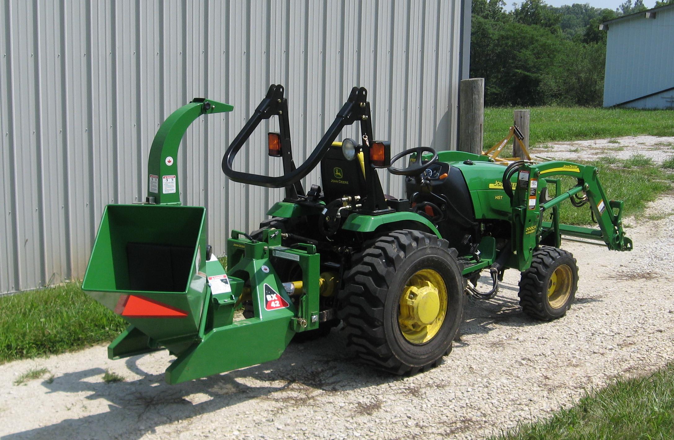

   / Wallenstein BX-42s with my John Deere 2520 #4
I have a 2520 and BX42 and it does fine up to about 3 inch branches. It will do up to 4 inches, but only on soft wood. I've had it bog down and kill the engine on 4 inch hard, old stuff.
Seemed to self-feed really well when new, but not so well now. Maybe my blades are getting dull, but I don't have that many hours on it.
Also, it will plug up really quick when trying to put light-weight stuff through it with a lot of leaves, such as willow branches. You have to mix the leafy stuff with some non-leafy stuff to get it to go through without clogging.
For that reason, I would go for the one with the shredder, although I'm sure it's quite a bit more expensive.
Speaking of expense, if money was no object, I'd also go for the hydraulic feed. Not so much because it needs help feeding, but because it would help to control how fast it feeds. Those hard, 4" branches I was having trouble with? I think it would handle them a lot better if they could be fed in slowly and then slow down or stop the feeding when it starts to bog down. Without the feeder, it sucks them in and you can't (or wouldn't want to try) to keep them from going in fast enough to kill the engine.
I agree with the others that the BX62 is too much for the 2520...the 42 is all it wants.
I'm not down on the BX42, I'd buy one again, but probably with the shredder option to handle the lightweight stuff without clogging up (the shredder model wasn't available when I bought mine).
Best of luck with your decision.

Great picture of the BX42 on your 2520. Question about that iMatch I see that hooked up to. Did you have to make any modifications to the PTO shaft? How do you like the iMatch? I've seen several videos of it in use - e.g. With chains, lifting heavy objects, as well as quickly attaching attachments. But what about with those such as the BX42 with PTO shafts?
Thanks again for your comments. I'm now torn between with shredder or without.... I'm leaning without at this point... With shipping that is quite a bit.

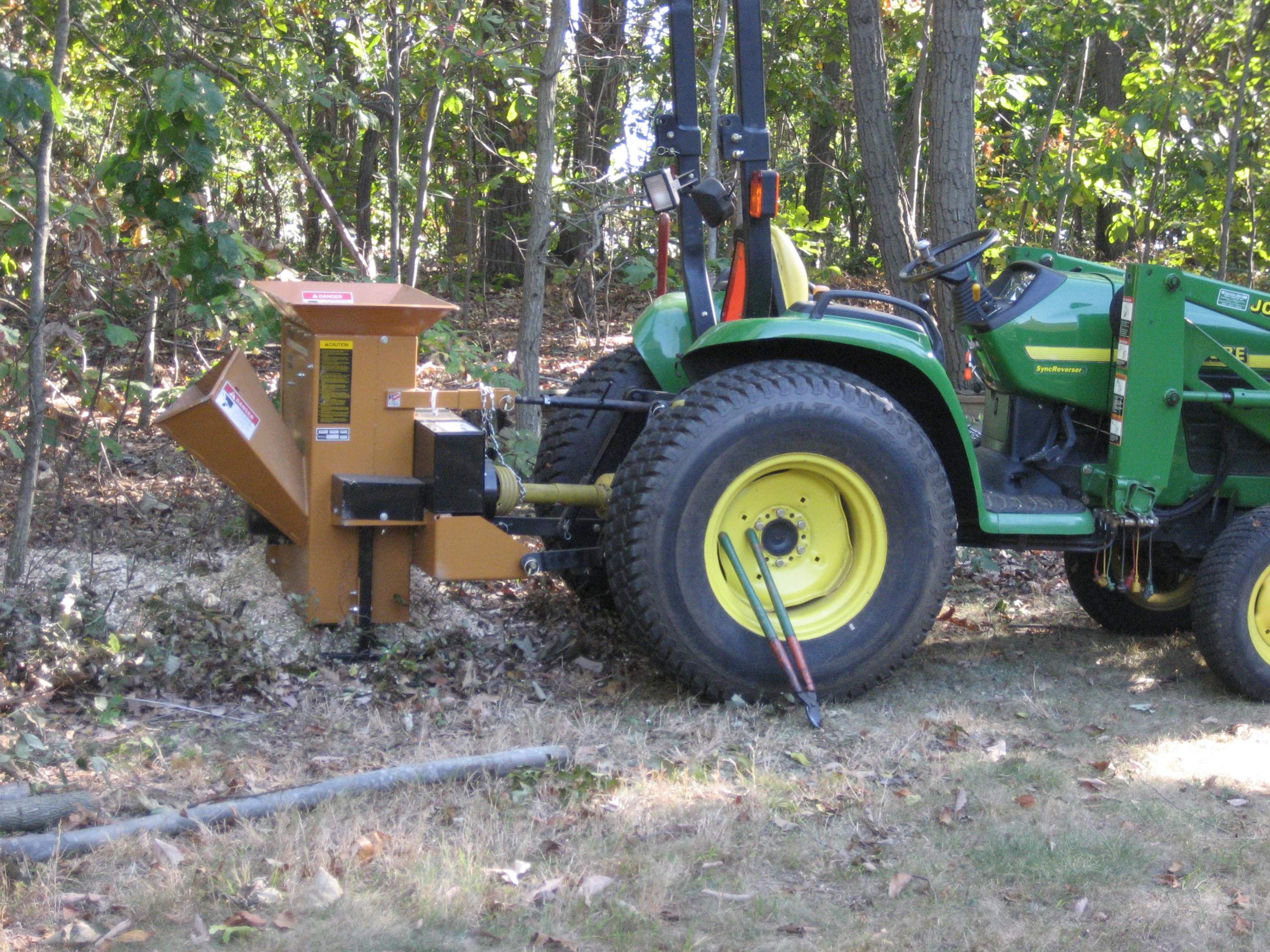

Good comments on the chipper!
As far as a shredder, it's a nice addition for those smaller branches and leafy tops that the chippers don't digest so well. My chipper/shredder, a Woods 5000, does a great job on all types of vegetation up to 5".
BTW, as much as I like my Woods 5000...and I got a very good deal on it (used implement), I cannot say I recommend any chipper that drops the chips directly under it. That's a bit of a PITA, but I can deal with it.

William,
I got lucky and the drive shaft length worked perfectly with the iMatch with no modification. I guess that would mean it would be too long without the iMatch (but maybe not, you would have to check per the instructions).
As for the iMatch, that always turns into a Ford vs Chevy discussion, but personally, I LOVE mine. I bought all my stuff new and with the iMatch in mind. Therefore, everything works. I tried hooking up my KK rake (which is NOT iMatch compatible) only once before coming up with an adapter so I would never have to do it again...
I knew that my rake and carryall were not iMatch compatible when I bought them and did it willingly, knowing that I had a way to deal with it. However, I for sure wouldn't do that with something like a mower.
I couldn't even imagine screwing around with hooking attachments up without the iMatch on a regular basis.
