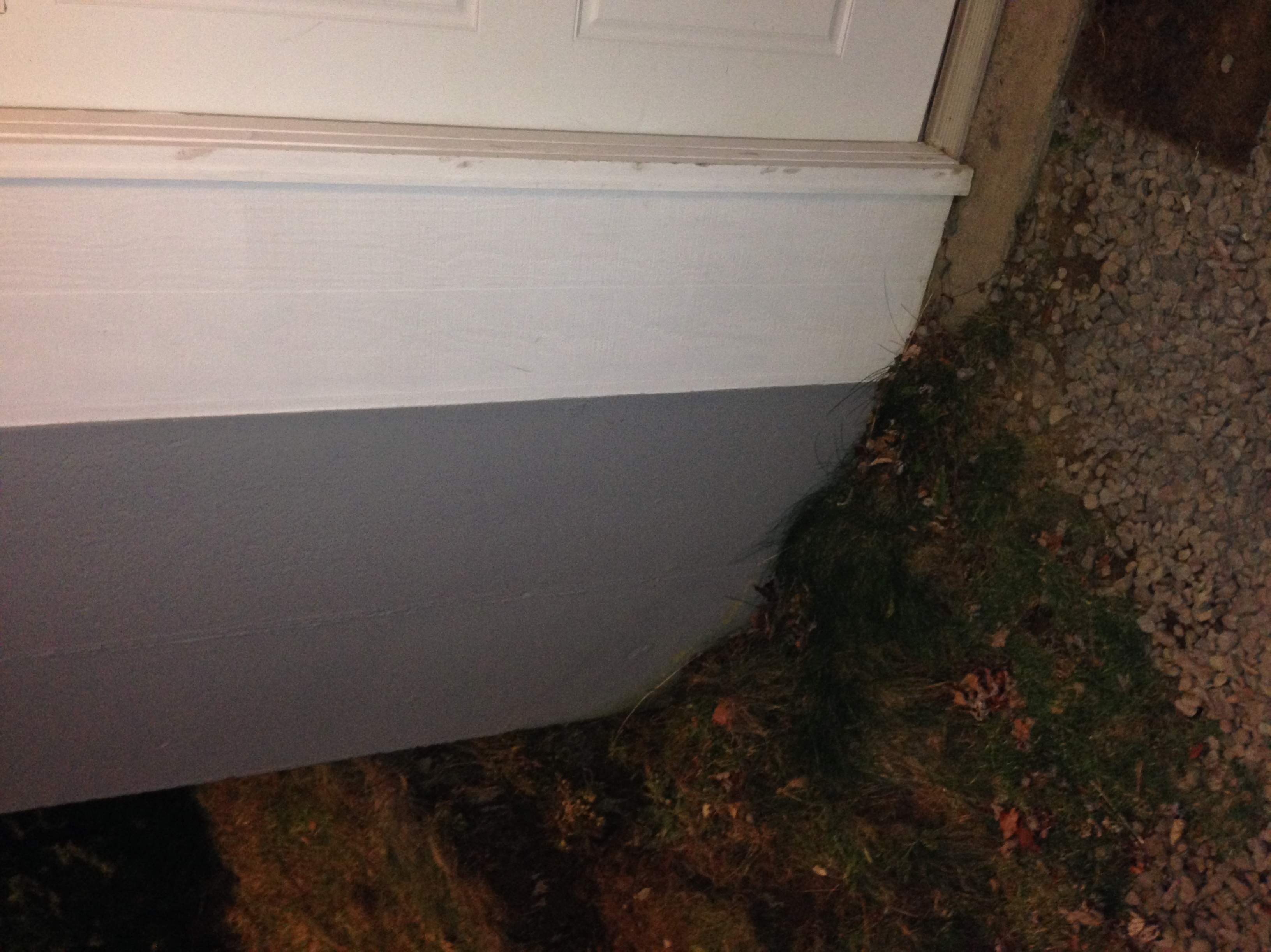

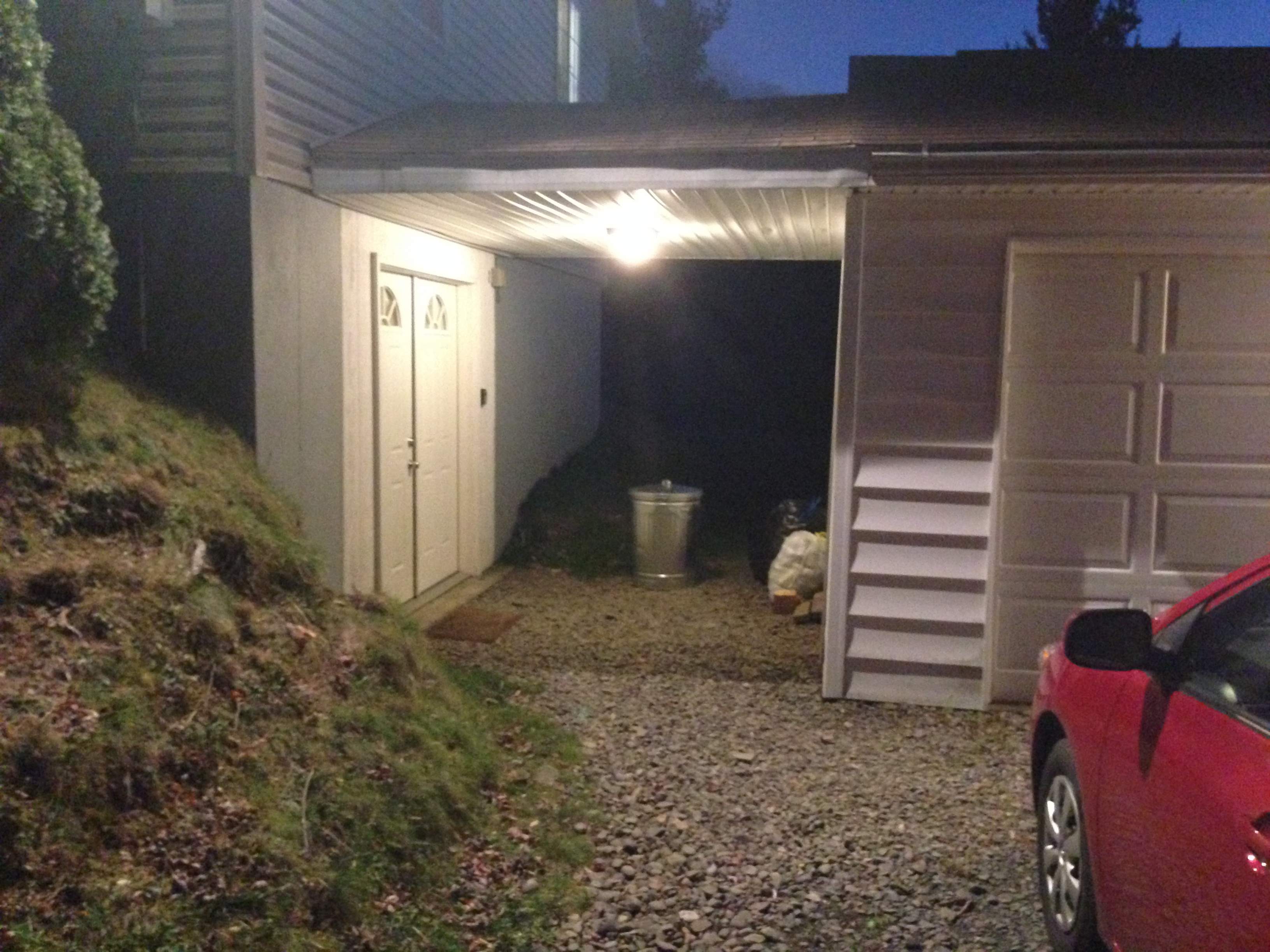

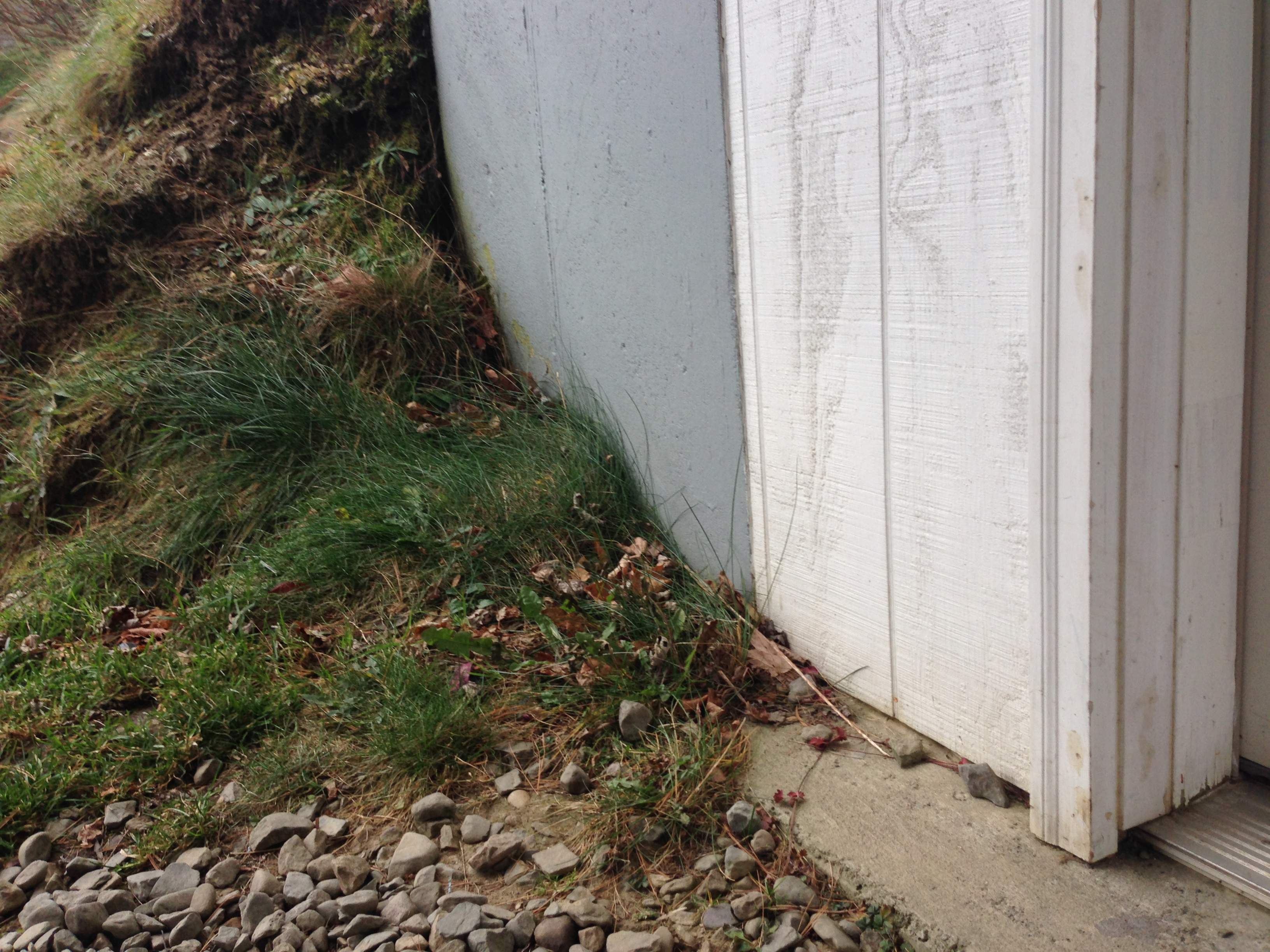

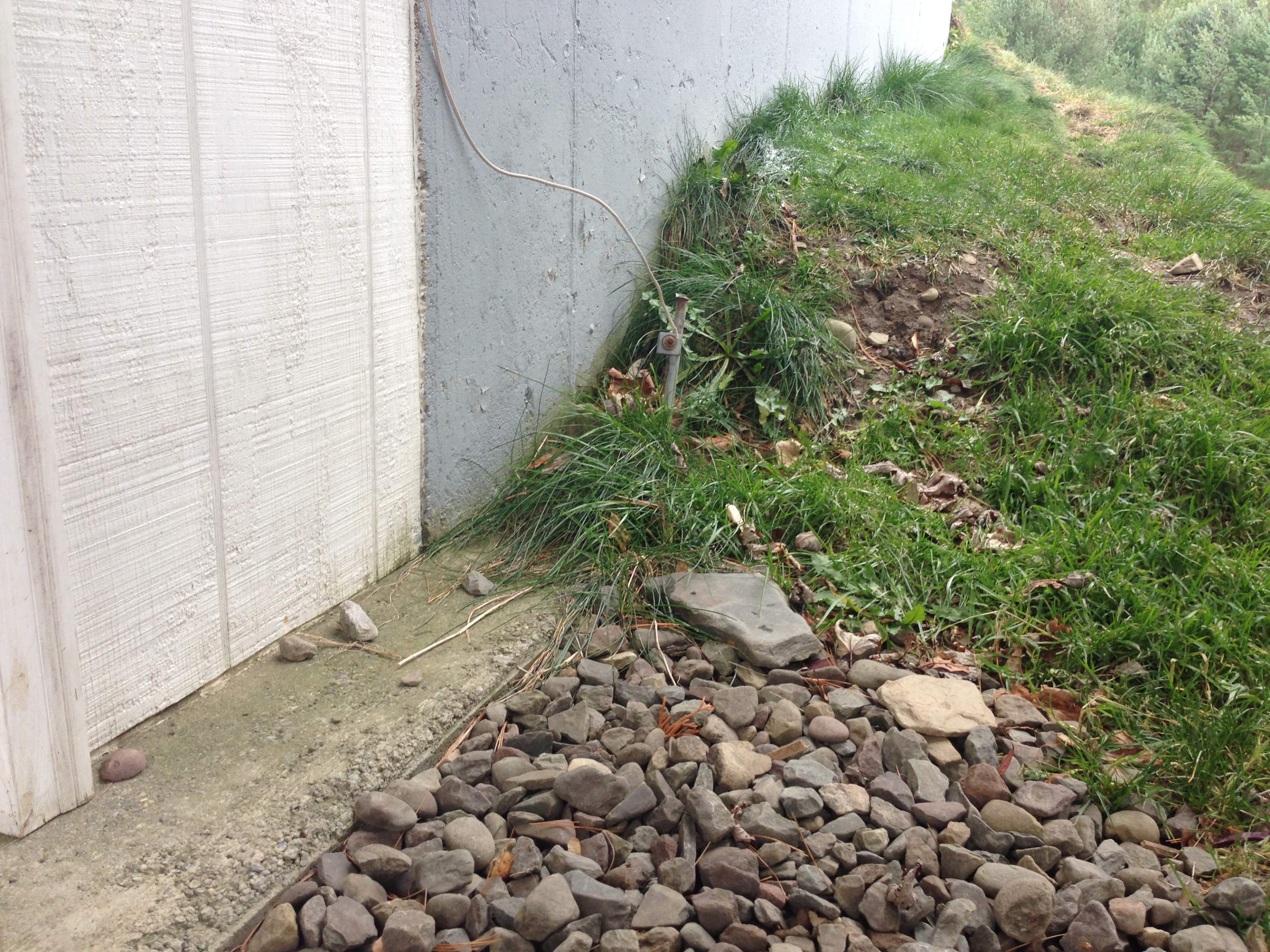

Here are the pictures. As you can see, the driveway is gravel and seems to drain very well and is level. I do not think any of the water is getting in that way. However, there are two grass banks that approach the doorway that I know I am getting water from. Rain water runs down these banks and past the bottom plate.

That's not at all what I pictured. :)
I would remove the dirt that wraps around the door wall. Looks like you could use retaining walls on each end with good drainage behind them.
   / Walkout Basement Entrance Re-Do #9
I would look and see if there are any drainage lines under the gravel by the door. (Our house the original owner put a gutter drain right across the front of the door. It would fill up and get into the house. I moved it out into the yard and we have no issues now.

Retaining walls are definitely in the future plans...the money tree can't seem to keep up with all the projects! Just finished a bathroom remodel and finished a deck (still needs railings) this summer. :drink:
I was looking at the dirt and think I could reshape the banks to move water away from the house instead of towards the door without too much work. That will be part of the plan come spring when I tackle this project.
