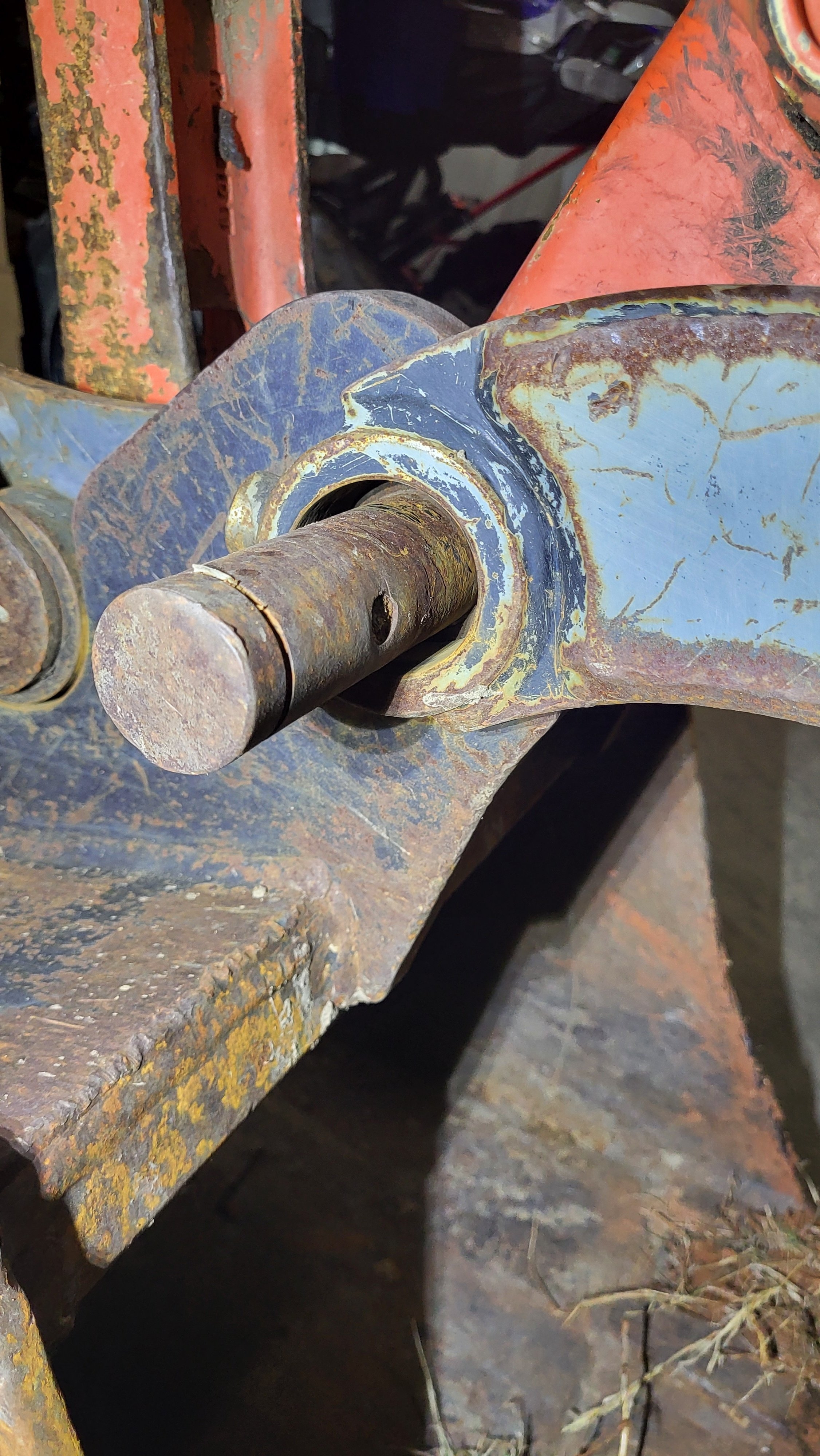

The major issue with it is that the thumb/bucket pin was broken and the previous owner used bar stock instead of the factory pin. One bushing is missing from the thumb and now the hole is egg shaped. My plan is to use a piece of hard plastic (UHMWPE) as a bushing to get me through the summer and do a full tear down and rebuild next winter of the stick pins and bushings etc.

Will you get the proper pin - that one looks a bit beat up! Then bushing on the thumb - could you fit a brass bushing, then shim out the egg shape for a tight fit for now? The UHMW is a smooth bearing surface, but I would be concerned if it will stand up to the pressure?
Thanks, a little elbow grease and wax and it'll be great looking even better! Yes I will get the proper pin but that project won't happen until next winter.
If the UHMW doesn't work out I'll likely do what you recommend with a brass bushing or just tear it all apart and fix it right.

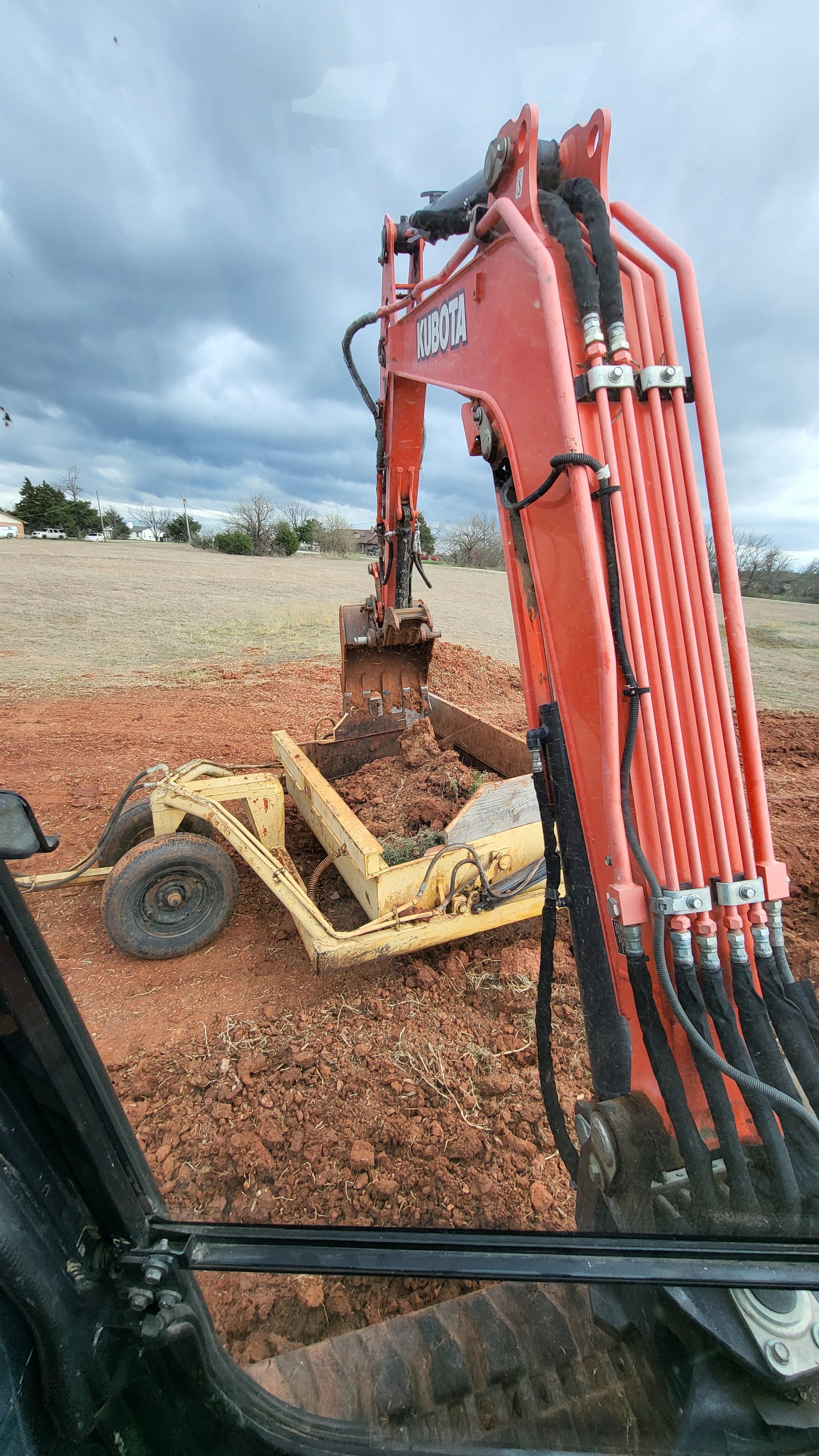

Update: The temp bushing is working great, should get me through the summer, it did wear in and loosen up, but that was to be expected since the thumb hole is egg shaped.
This machine is great, I am really having to work at being smooth, it will take a lot of time to get used to it. It is very very fast and responsive, you don't have to move the joysticks far for plenty of action to take place.
I am very glad I got the cab. I was digging facing the wind and dirt was blowing up and right at me.

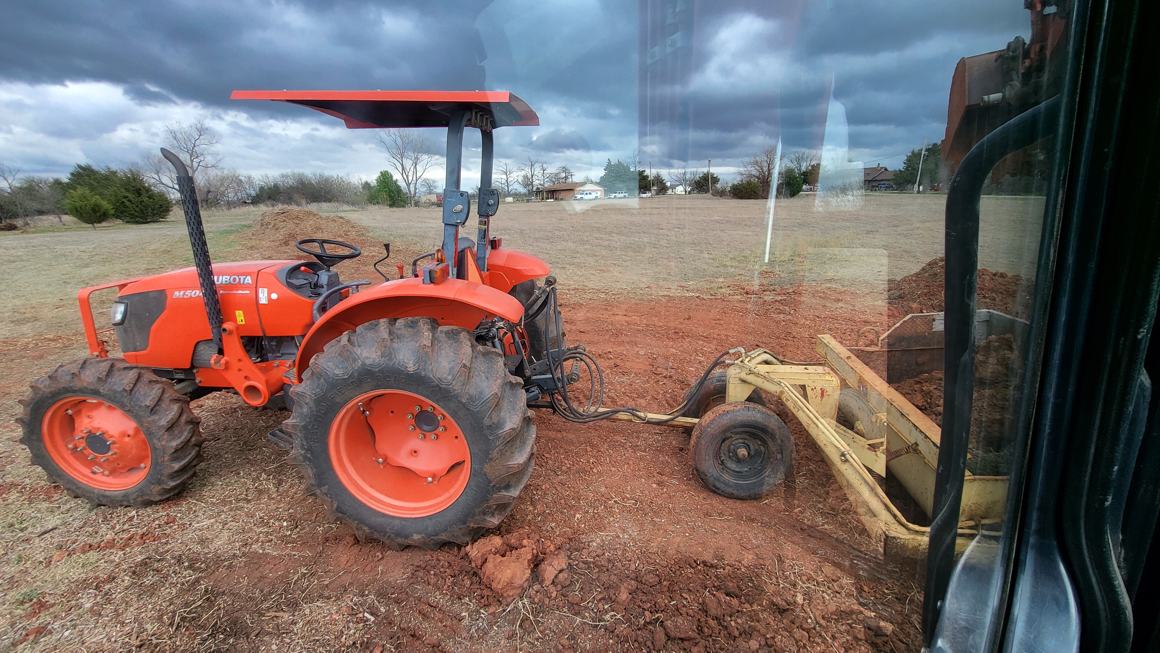

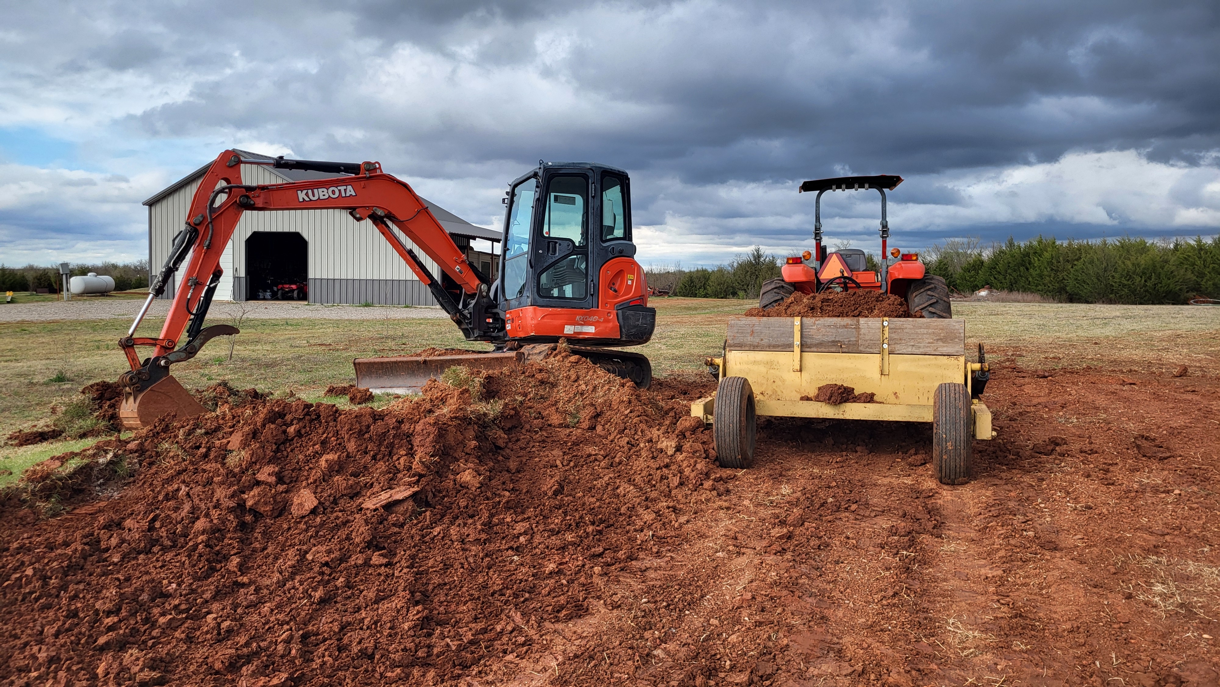

This is a great companion to my little 2.5yd scraper, I am filling it up from a pile I've been needing to move for 5 years.
I had a lower glass made and it fit just right.
All zerts except two on the blade are taking grease good and I've got grease distributed around really well, it looks like it should now.
