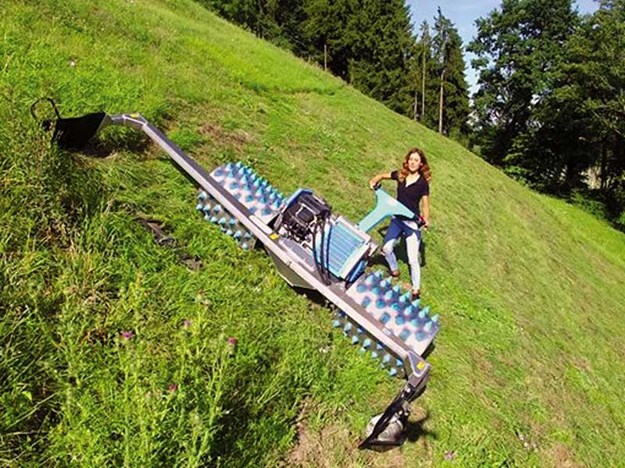

I have a 2 acre property and mow about 3/4 of an acre of it, a good chunk of which is my septic mound. The mound is built into a hillside and not far from the house so I don't like to let the grass get higher than 6-8" between mowings. The problem is the fact that north, south and east sides of the mound are quite steep-too steep for any kind of lawn tractor or zero turn. Right now I'm doing it all with a 22" push mower which cuts nicely, but its pretty labor intensive. I'm hoping that a self propelled walk behind might have a low enough center of gravity to navigate the side hills, give a nice cut and allow me to cut 36 or 38" at a time.

Can something like a sickle bar mower be used or is the mound in a confined space?

There are some 4wd walk behinds now that you might want to look into. Trouble is none have a reverse; so, it needs to be fairly open to not require pulling them back.
There are some good battery self propelled walk behinds now. Stihl has a couple as do others. This is if you're worried about the oil slinging issues mentioned. Almost all our approximately 1/2 acre of lawn that we mow with walk behinds has some slope contend with. No problems. My wife can blast away nearly top speed behind the Honda and do it all in less than a couple hours. I would take about 3 times that long because I'd mow 1/3 and rest, etc. We have the Honda HRR and an old JD 14SB, both very good mowers and easy to start. Have a 40v Kobalt, but it does not cut as well as the 2 gas ones and is not self propelled. Rarely use it any more.
Just recently got a new Ryobi 40v "crosscut" walkbehind, self-propelled. It is so easy to run around on slopes and all.
