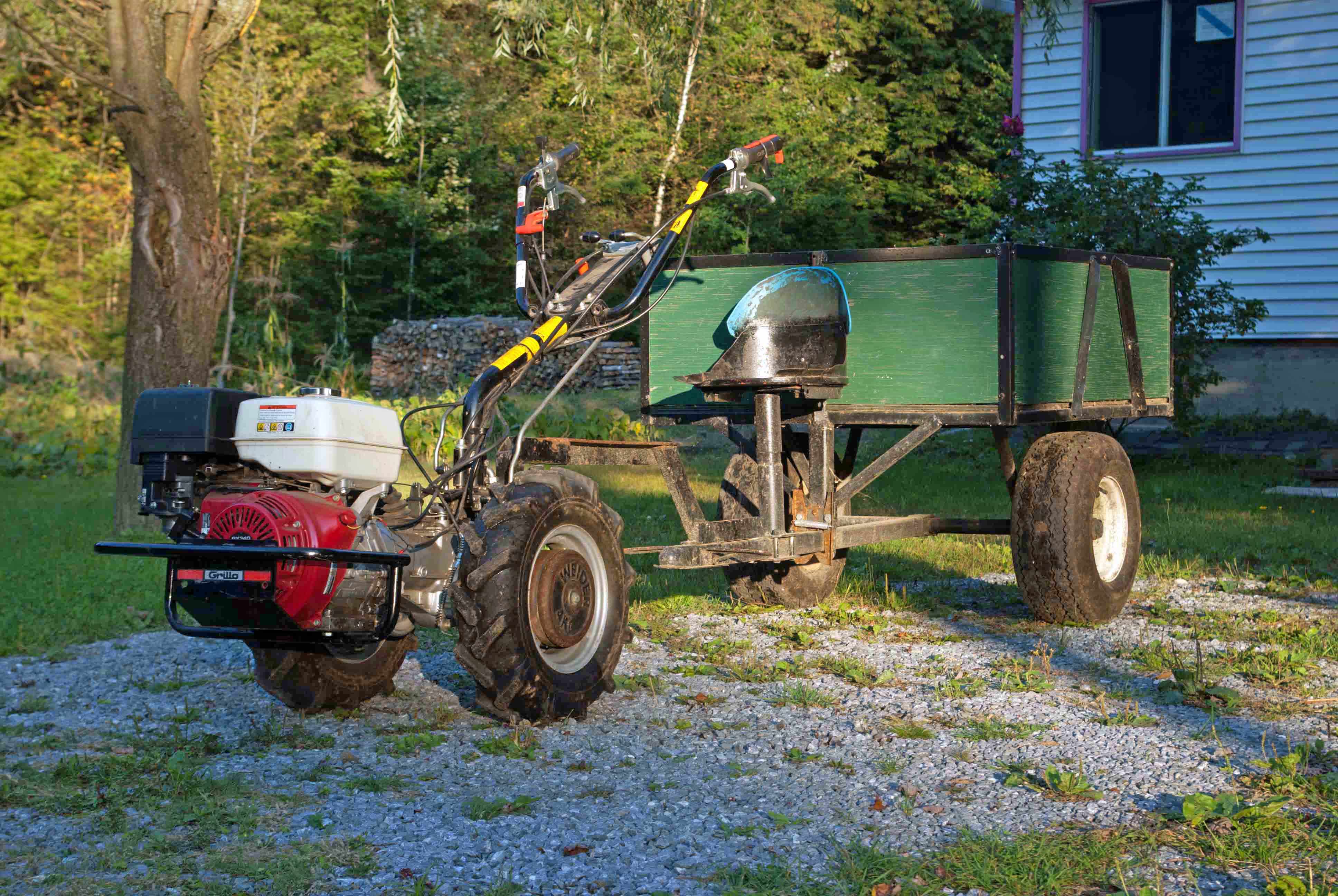

Hi! I use a modified home made VTT trailer I add a seat and a feet rest and also a special tongue for use pto water pump. This trailer dump and can load 800lbs I add a pict Good Luck Oldmech trailer.jpg

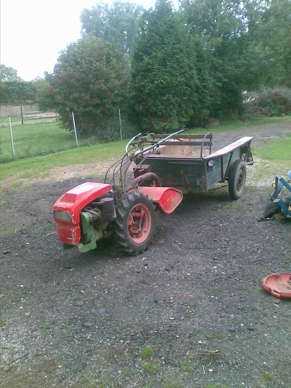

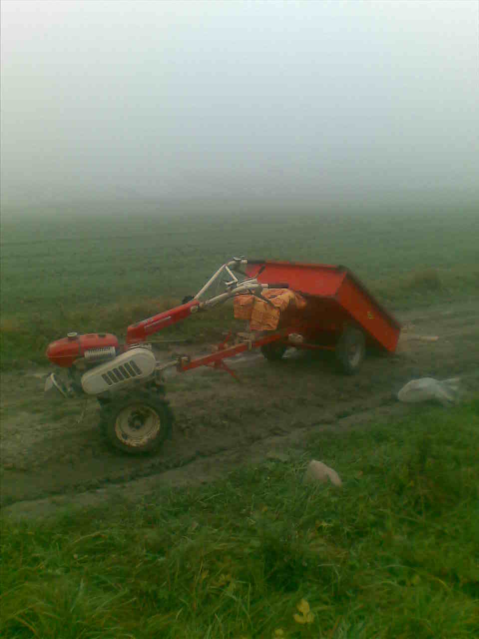

Here You go:
The tipper is a french Deves, the red one behind the Iseki an Angrostroij, Made in Czech Republic, the green one is an Agria.
